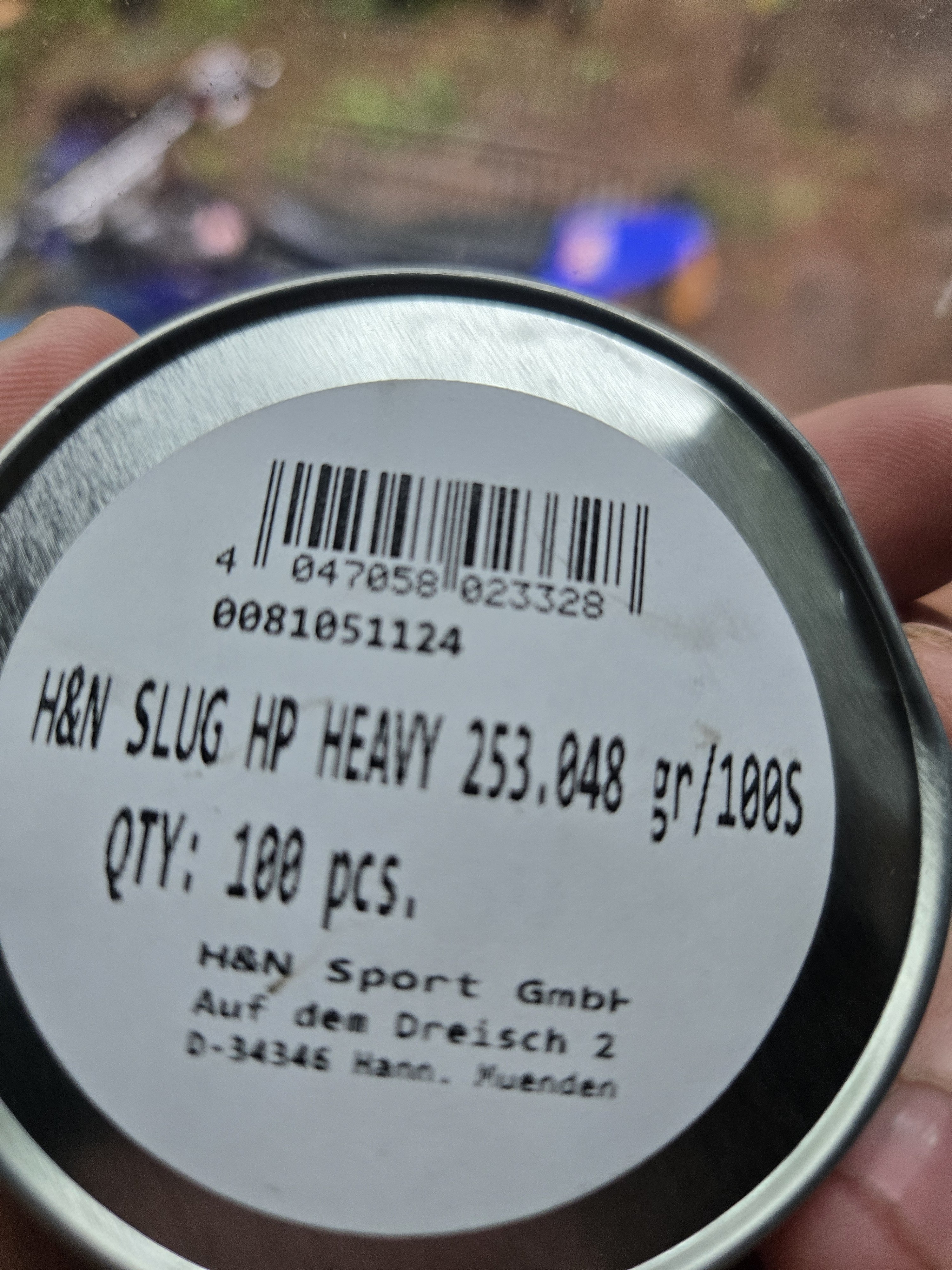

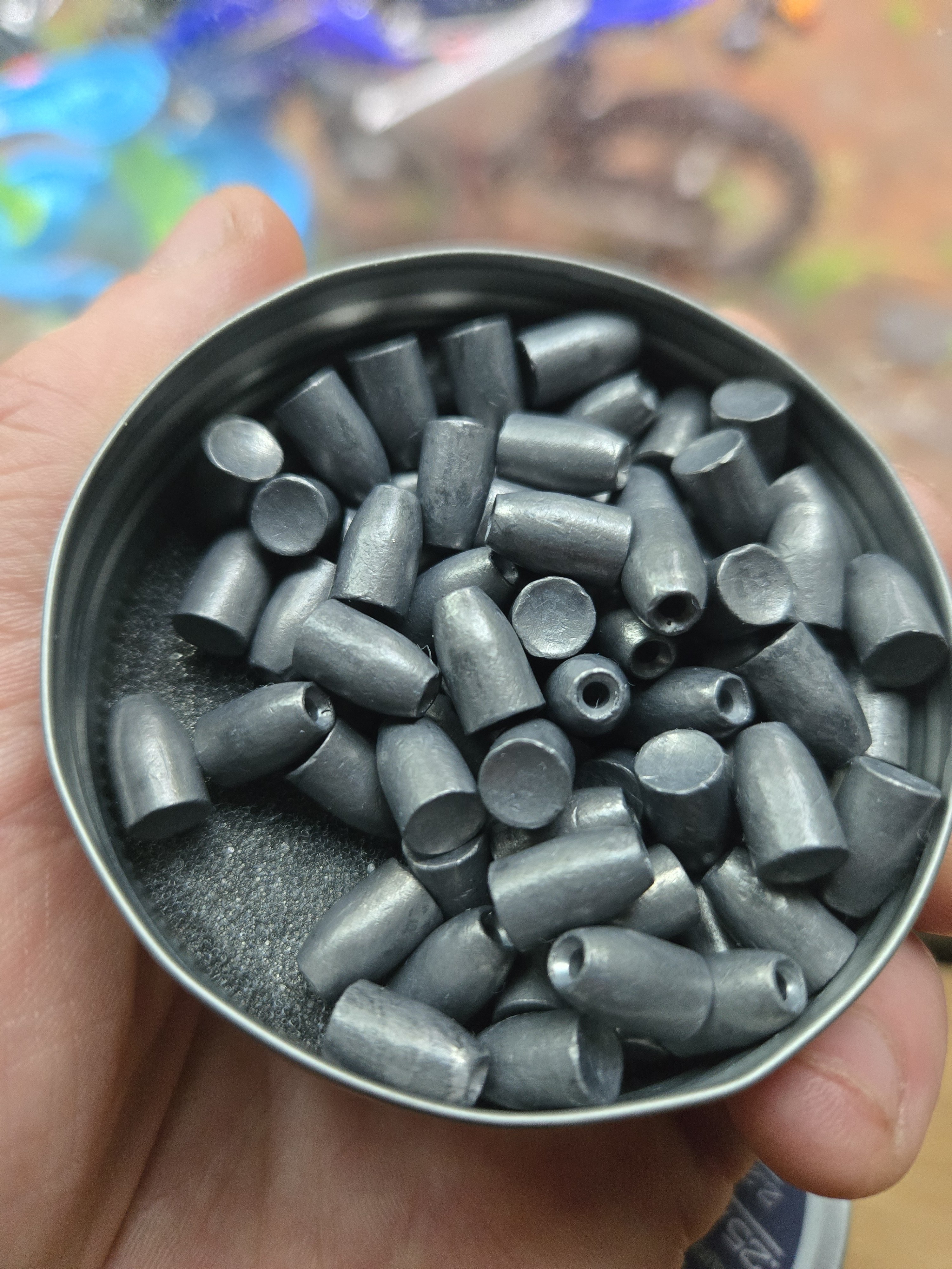

One of my favorite for .25 right now .253 48 grain hollow,Really good fit.

Mine's also in .25, but I don't think they sell slugs that heavy where I live. The heaviest Ive seen here are 40 grainers.
I'm currently trying these out on my Vulcan 3 HP.
So far they have showed potential. Way more than any .253 before them.
