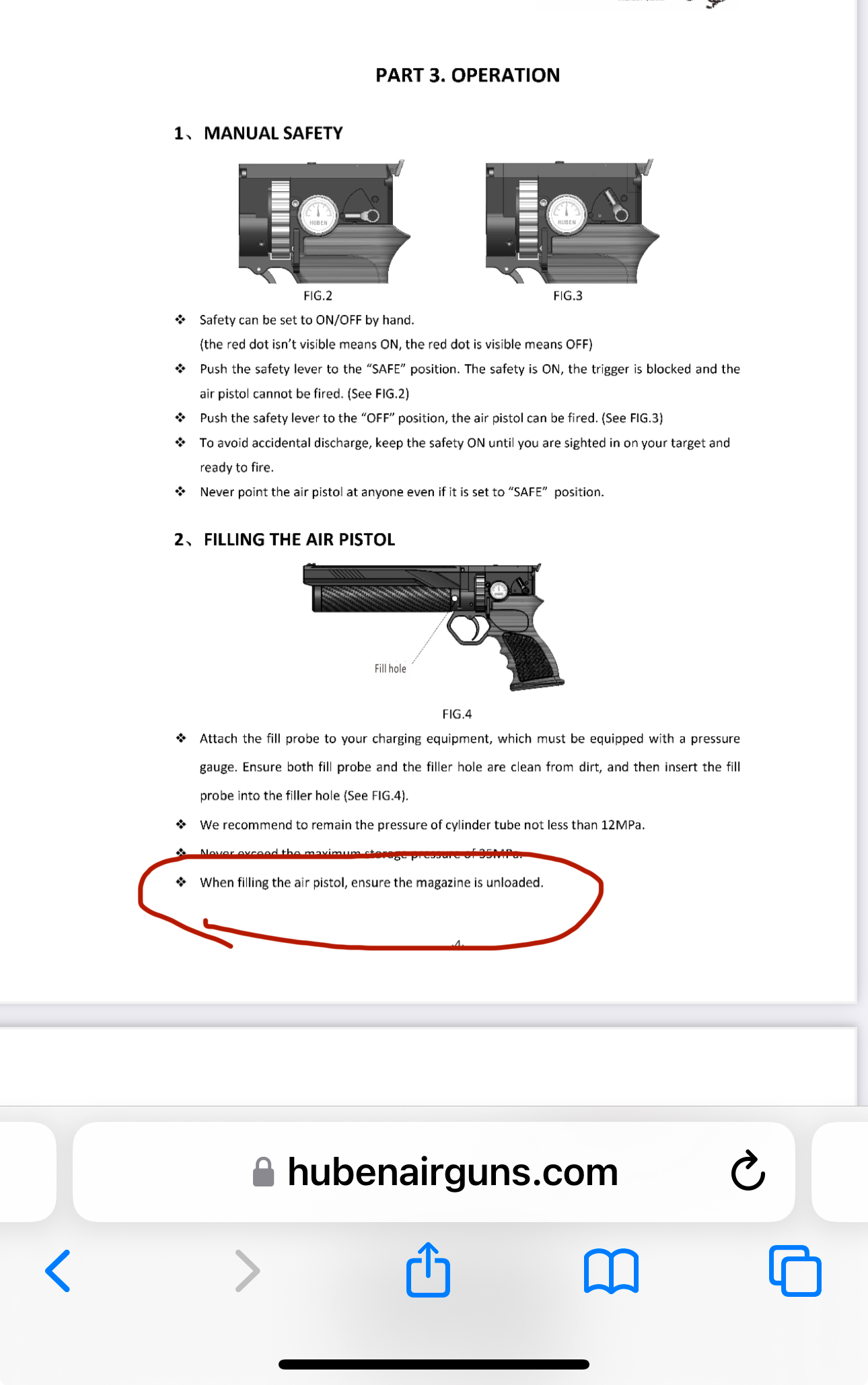

Can anyone please explain why it is recommended to fill the GK1 reservoir before loading the magazine? I got this information from the GK1 User’s Manual.
I ask because the magazine release lever and magazine are under less tension at lower reservoir pressures. This makes loading the GK1 easier to me. Are there valid reasons not to re-load before topping off the GK1?
Is this simply a safety precaution?

I believe the advice belongs to an empty air tank, which makes some sense as the shut off valve is biased by tank pressure. In other words there needs to be some air tank pressure. You are also correct that there is less detent pressure on the magazine lever when the tank is at less than max pressure. In that light, I always load my GK1s after I have shot a magazine. Then I recharge the tank to 300 bar. After one 17 shot magazine the air tank is about 200 bar+..
