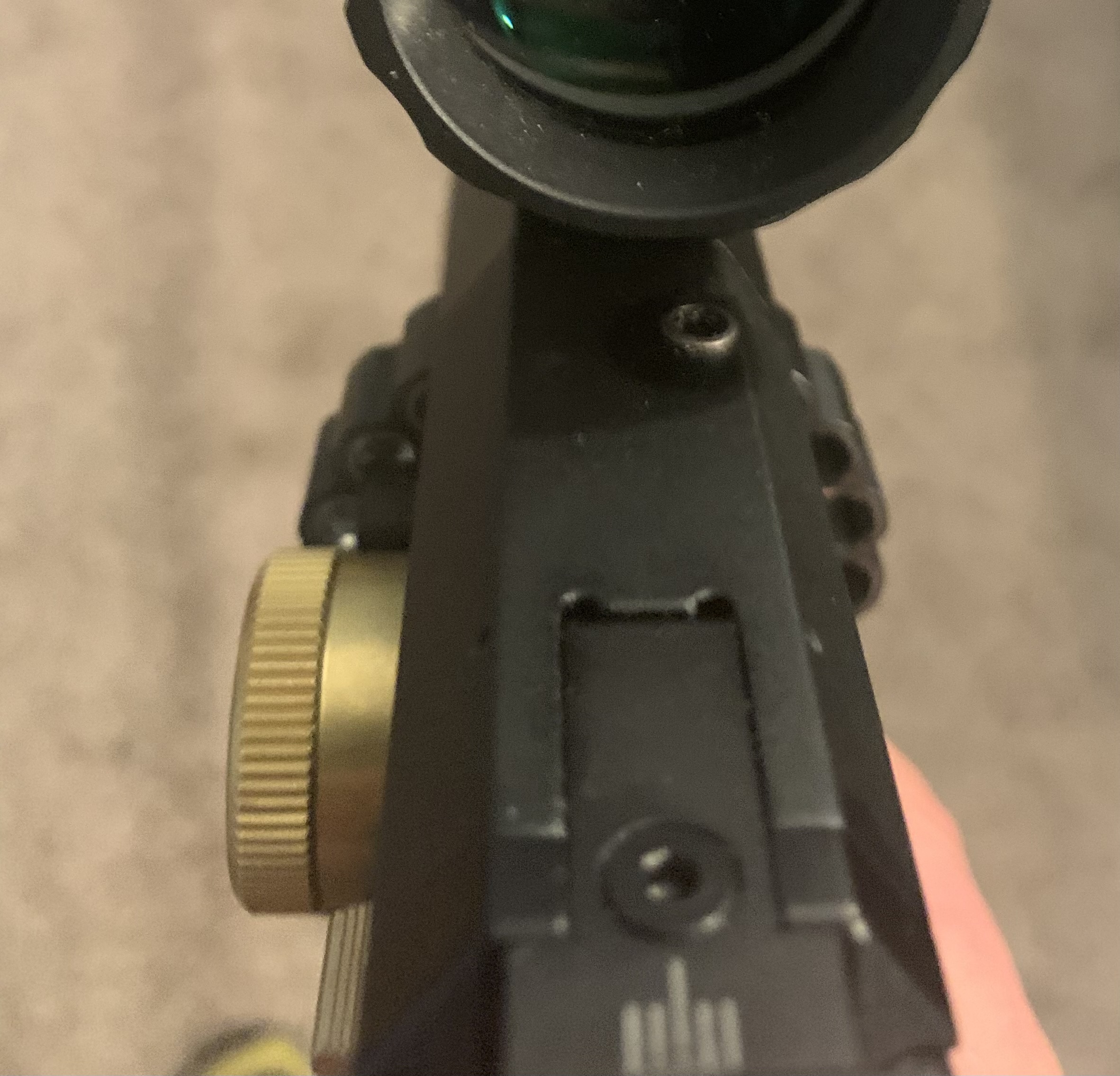

Again, this is my 22/GTO/stock gate combo, but here’s a pic of a half shot mag. The GTOs always stay at the back with no movement forward or back. Again, no seating, just clicked in from an angle past the plastic chamfer.
Perhaps the 25 GTOs are undersized for the mag, in which case they are no bueno. But I’d like to see them tested with the stock gate before condemning them. If that works then I assure you that loading them would be just as fast as with a gate.
