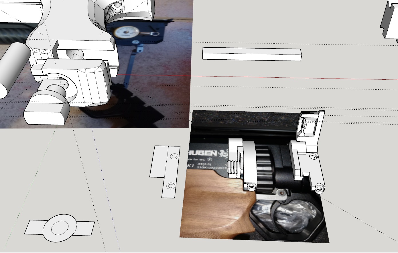

The problem with the moderator was at how the damn program drawed the 12mm treads, there was a slight bent, so I have to re-done them with special care, pieces ordered, if everything is ok, I will put the silencer + an alternative loading gate to download.
The loading gate will have a naked or cover versions, no need to put magnets or any extra bolt.

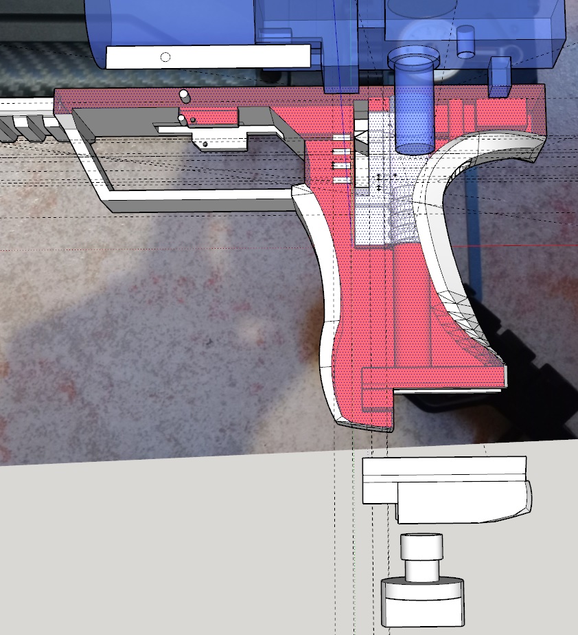

Also working in a new handle that reduces the extra space of the original and adds a power selector on the go + detachable rear stock option in diana chaser style. The power selector will have a mechanical indicator in form of a vertical gauge + internal piece to act as a stopper, for countries with legal power limits as it is mine. I will have to advance the whole trigger and the thing may take a while to finish. 3.5 revolutions is the max, right?
