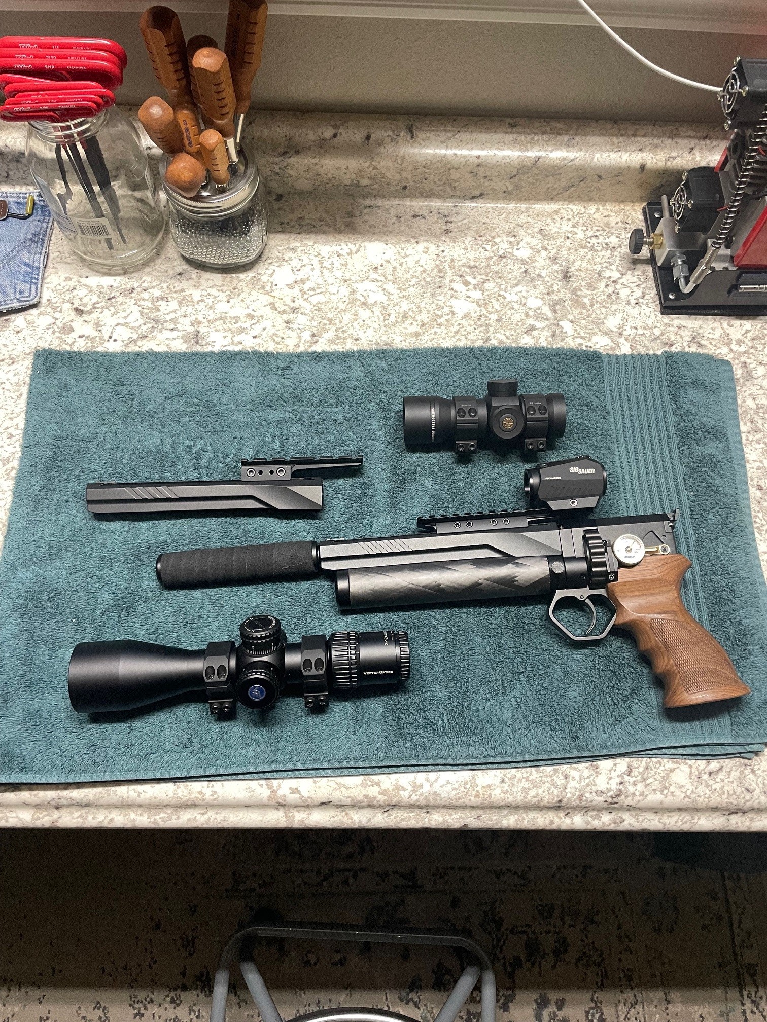

I actually bought another barrel shroud for my .25cal.
I have a Leupold RDS on one shroud and a Vector 3X12 compact scope on the other.
I shoot the RDS setup most of the time because the Vortex setup gets quite boring out to 50 yards.
I can switch between the two shroud/sights in less than a minute with each holding it's zero.

Way cool! I am surprised that switching between shrouds does not require re-zeroing, that is some precision machining there!
The 1 MOA dot plus 1/4 MOA adjustment of the RDS should allow you to "reach out" quite a bit. How did you purchase the additional shroud if you don't mind me asking?
Reactions: Bandito
I got the extra shroud from Kelly at KrazKool.
When swapping out the shrouds I've learned that if I let them "seat" themselves(muzzzle up) and then tighten them with the same torque each time they do not require re-zeroing.

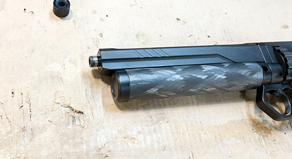

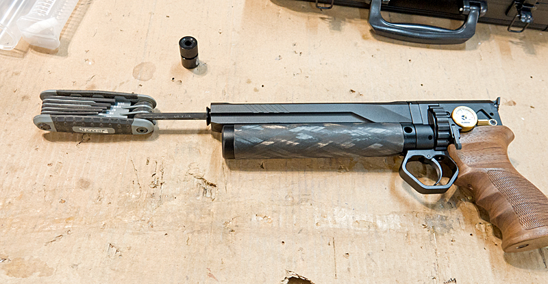

Nooo! I think everyone would agree that the first thing to do to this pistol is to get a moderator on it. Because it is loud. All of my previous air rifles had some sort of built in sound suppression. Not the GK1. Even at 6 FPE (lethal only for small birds close by), this pistol is loud. And there is going to be a lot of shooting this pistol, for sure.
Stick a 7mm allen key (who has a 7mm allen key handy--nobody. 1/4” worked fine for me) and unscrew the Barrel shroud end cap.
Screw on a 1/2x20 thread adapter from Ares (someone else may have the answer about whether Huben is now including one with their pistols). If they are not, buy one. I highly recommend a moderator of any sort to protect your ears.

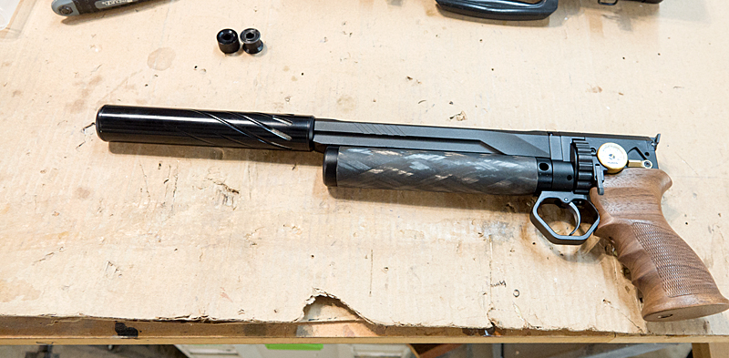

And, screw on my Hugget Snipe Moderator:
A couple of notes on the first few shots. With a moderator, it seems much quieter and less violent than my other hammer based air rifles. It was and still is lovely. Yes, get a moderator, any moderator, on there because it is so likely you will be going through tin after tin of pellets. Pretty much every tinkering session I had with this pistol began with full magazine unload and a smile, and ended with a full magazine unload and a smile.
There are endless moderator recommendations and threads. Taming the Bark is a tremendous thread. Obviously the Hugget is a high class moderator, and so is no way holding this setup back from being an awesome minicarbine. But for sure I will be circling back and printing my own moderators in the future!

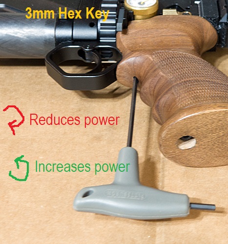

Now that I've got a vetted pistol that I was happy to shoot endlessly, my next step was to quickly rough tune the power to 20-25 fpe. I already know what I want in the end from this pistol, so I thought it best to bring it to the ballpark pressure now, rather than getting things dialed in, then having to re-adjust. 20-25 fpe is a solid squirrel hunting pressure.
3mm hex key into this slot here to adjust the power.
Don't really know if it is exactly accurate, but in my mind, "Righty is tighty" and "Lefty is loosy". So turning right (clockwise) closes the valve and reduces the power. Turning left (counterclockwise) opens the valve and increases the power.
I think that technically, turning right increases the closing valve tension, thus reducing power, and vice versa.
For me, 6 quarter turns from closed achieves about 22 fpe’s. The exact number of turns is really not that important if you have a chronograph. Load the magazine, fire a couple of pellets, open up more pressure, repeat. Pretty much no matter what your desired pressure you will get there in under a dozen pellets.

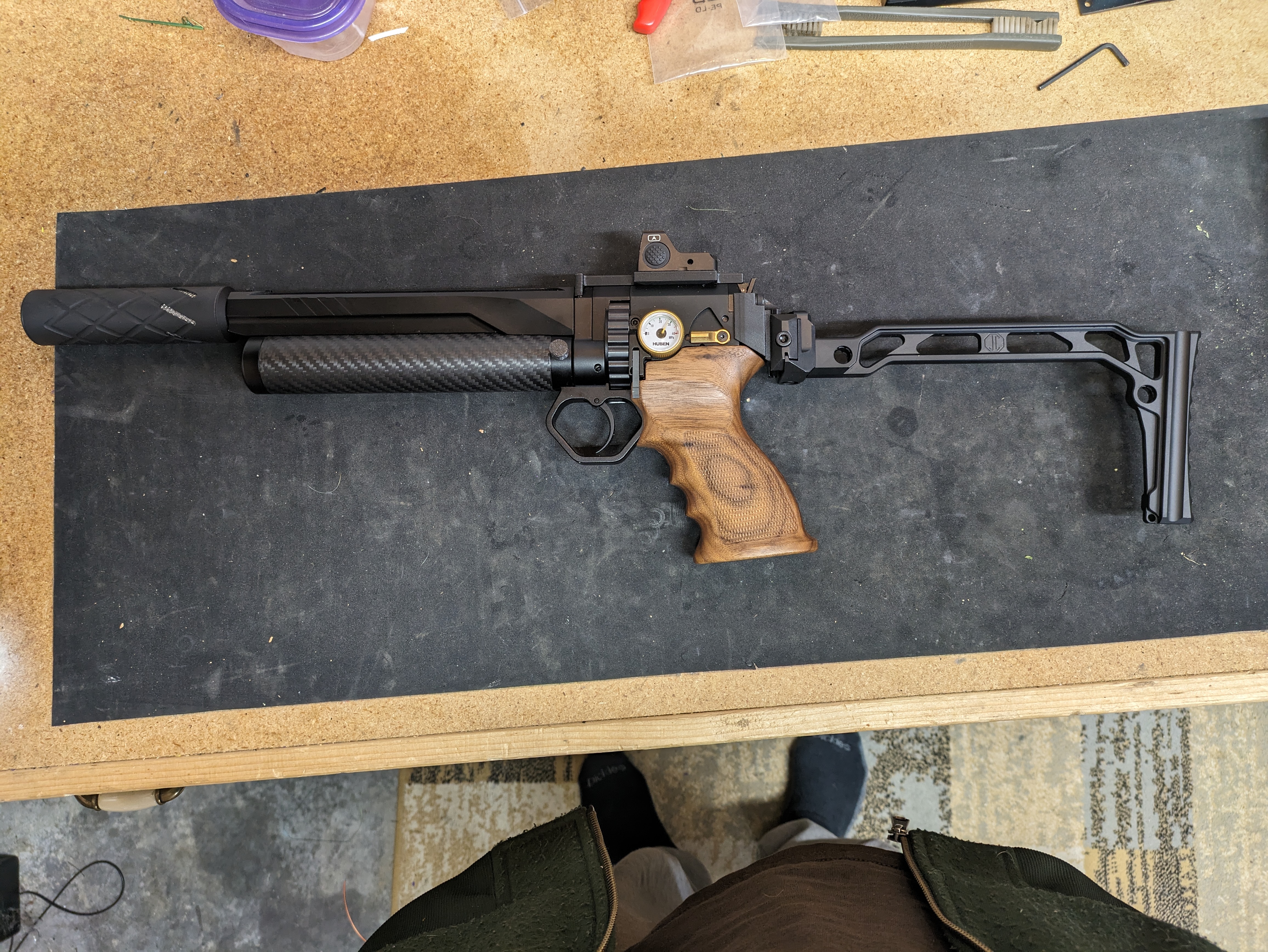

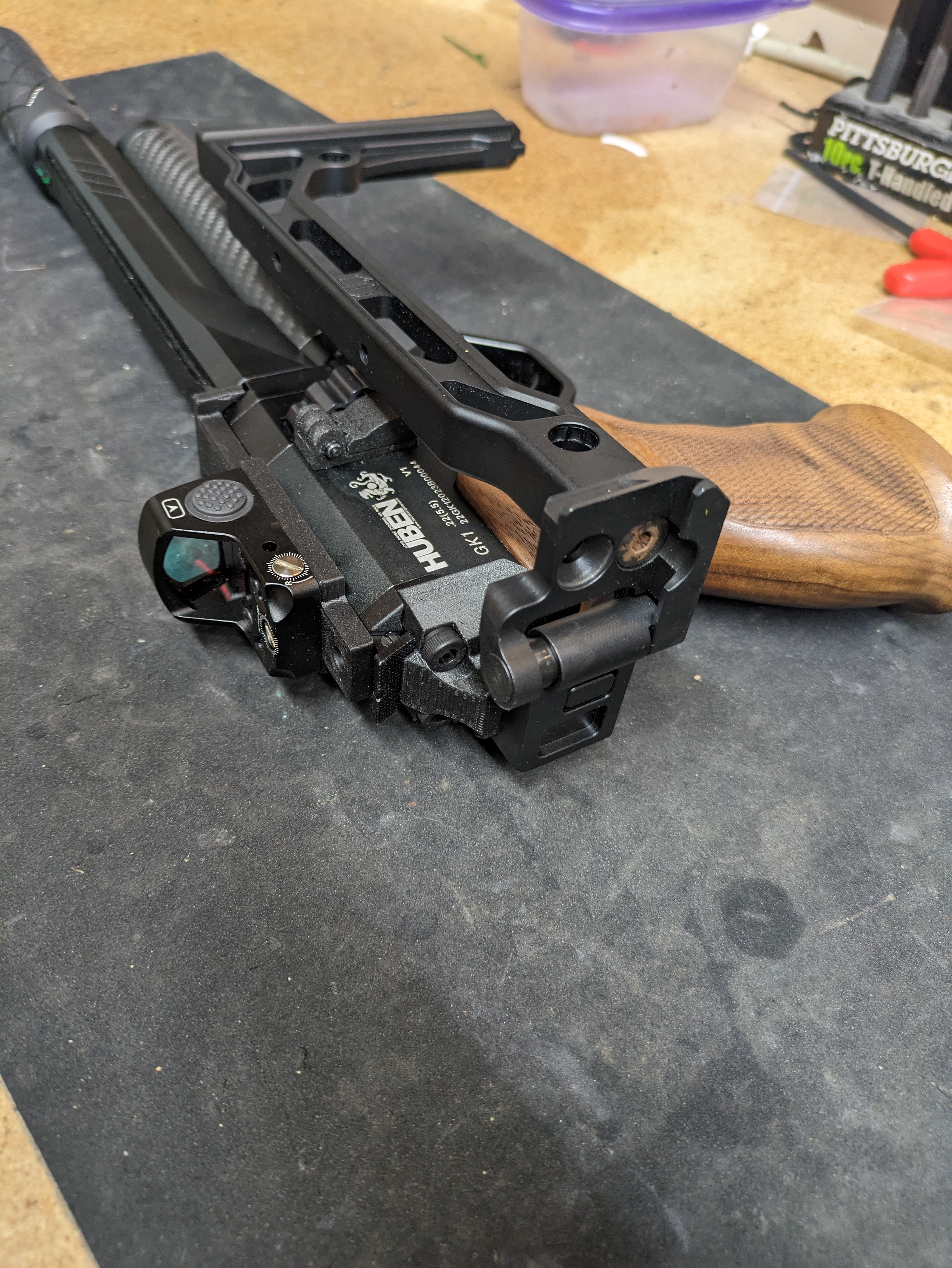

Hey wimpanzee, might I ask did you use the single or double 1913 adapter to mount this stock?
I used the double, and screw is on the lower notch. The stock also has 2 mounting holes on the folding piece, and it's on the lower.....the red dot doesn't sit very high!
Here is a link
Is was about $65 shipped, and I ordered it on the Chinese new year and still got here pretty fast!
Here is a link
Awesome thank you for the detailed reply!
