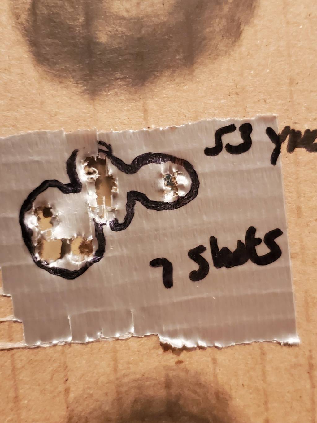

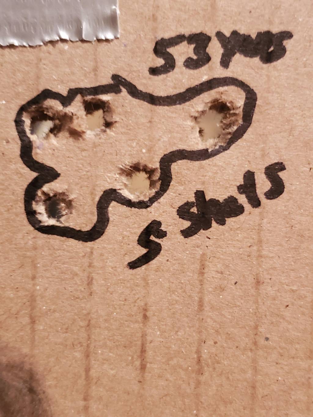

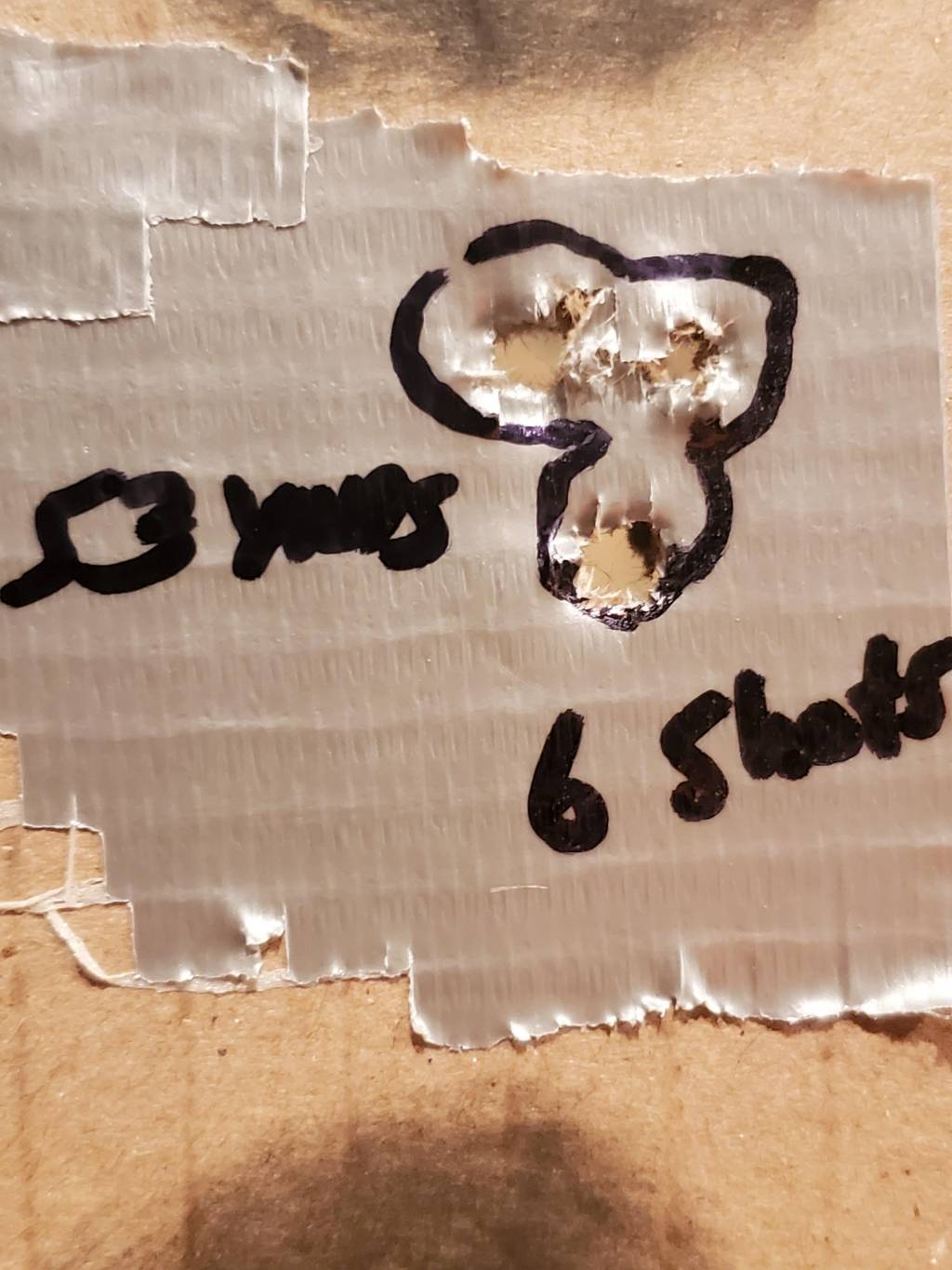

Hi guys I was shooting the huben yesterday and finalized my tune. 14 mpa 260 bar fill gets me 2 full mags @ 970fps 53fpe with 25.39's. Here's a few pics:
