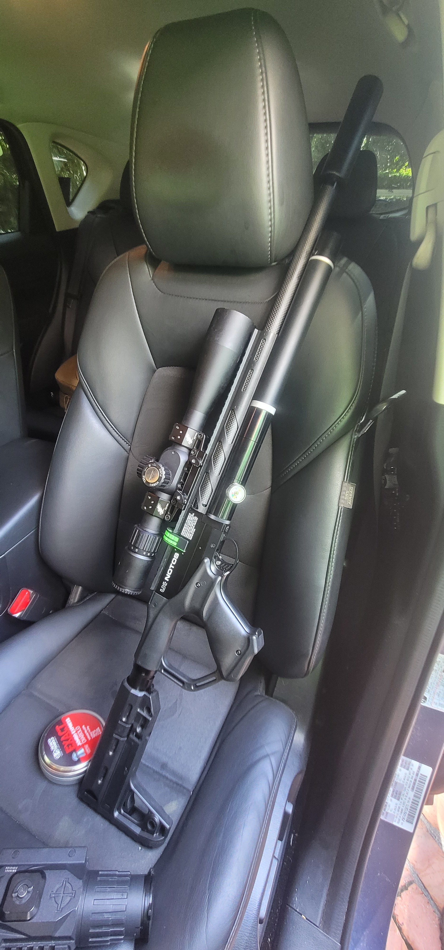

Does anyone have any experience with these regulators? I'm assuming it's top quality coming from Huben, but any knowledge of them being used on the notos? I'm contemplating getting one along with a .2l cf bottle.
Here's a pic of the notos currently.
