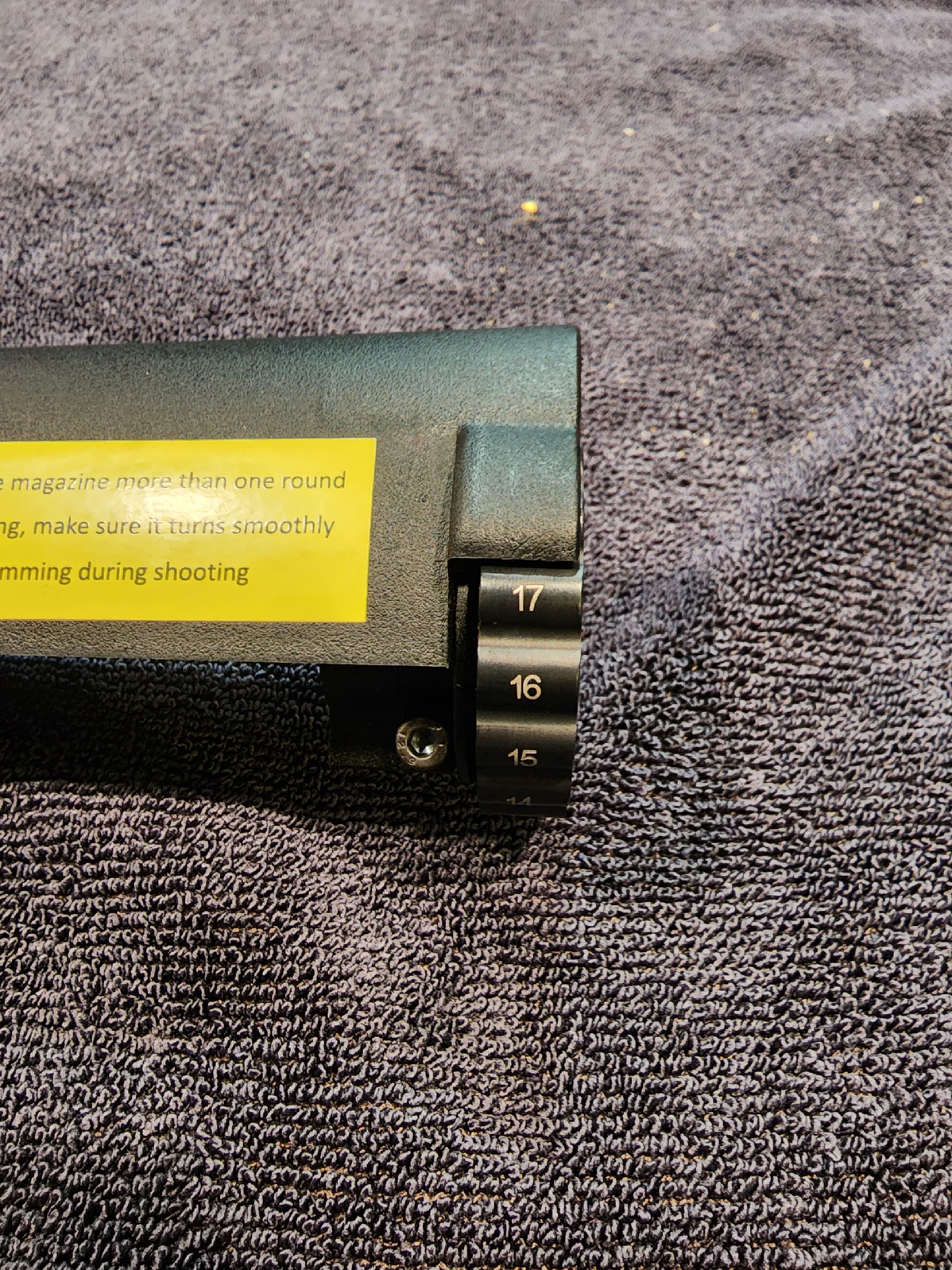

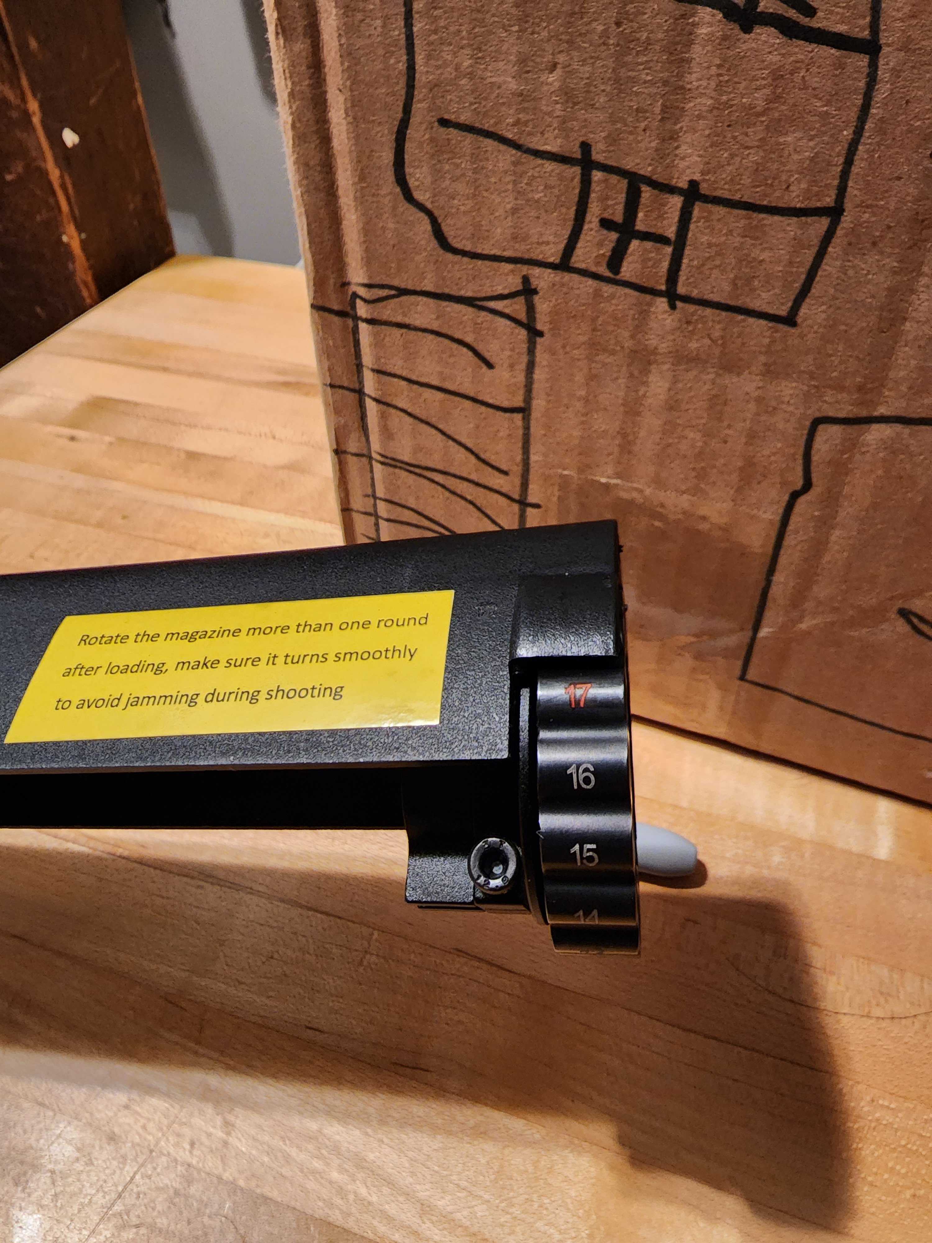

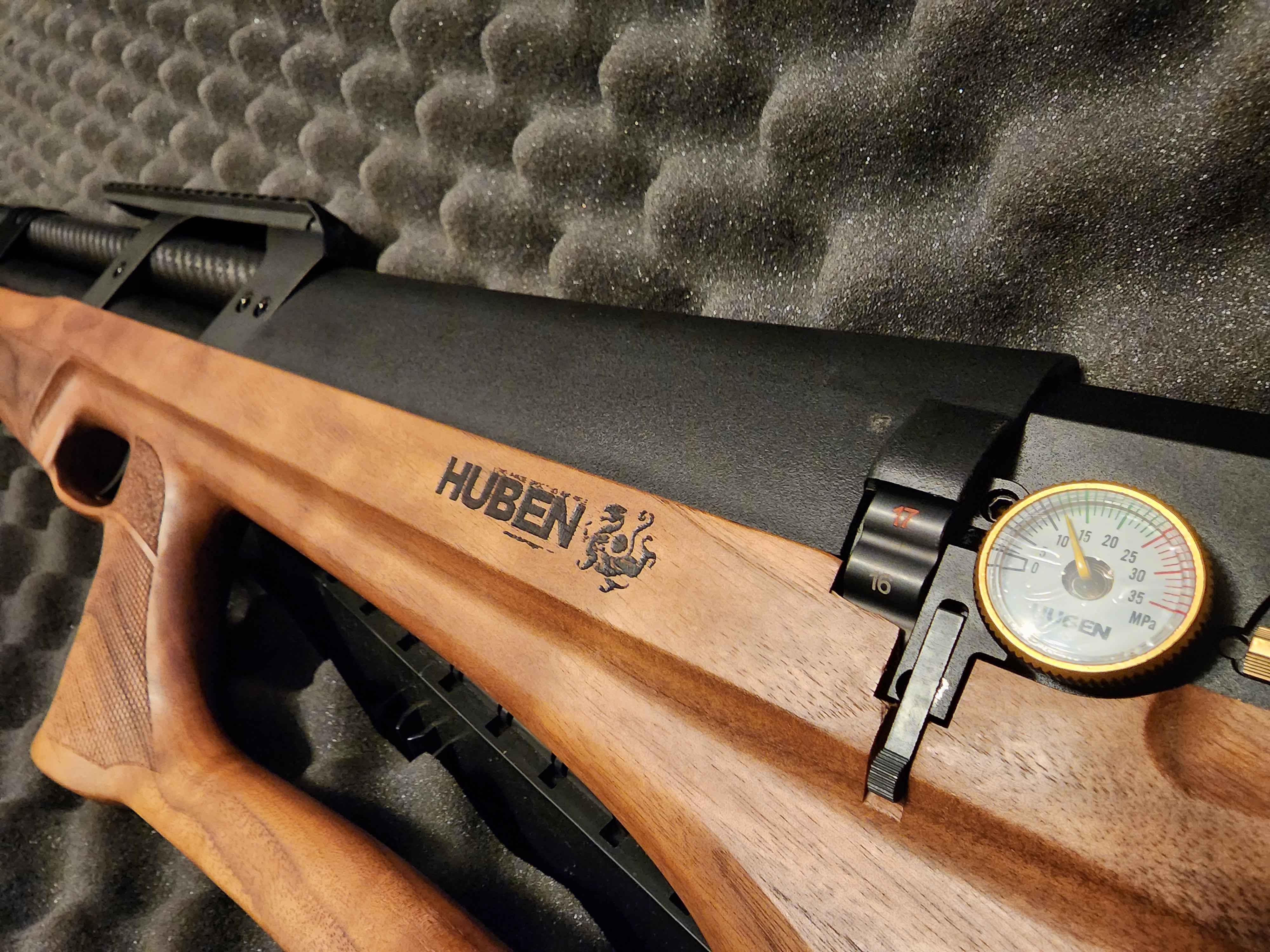

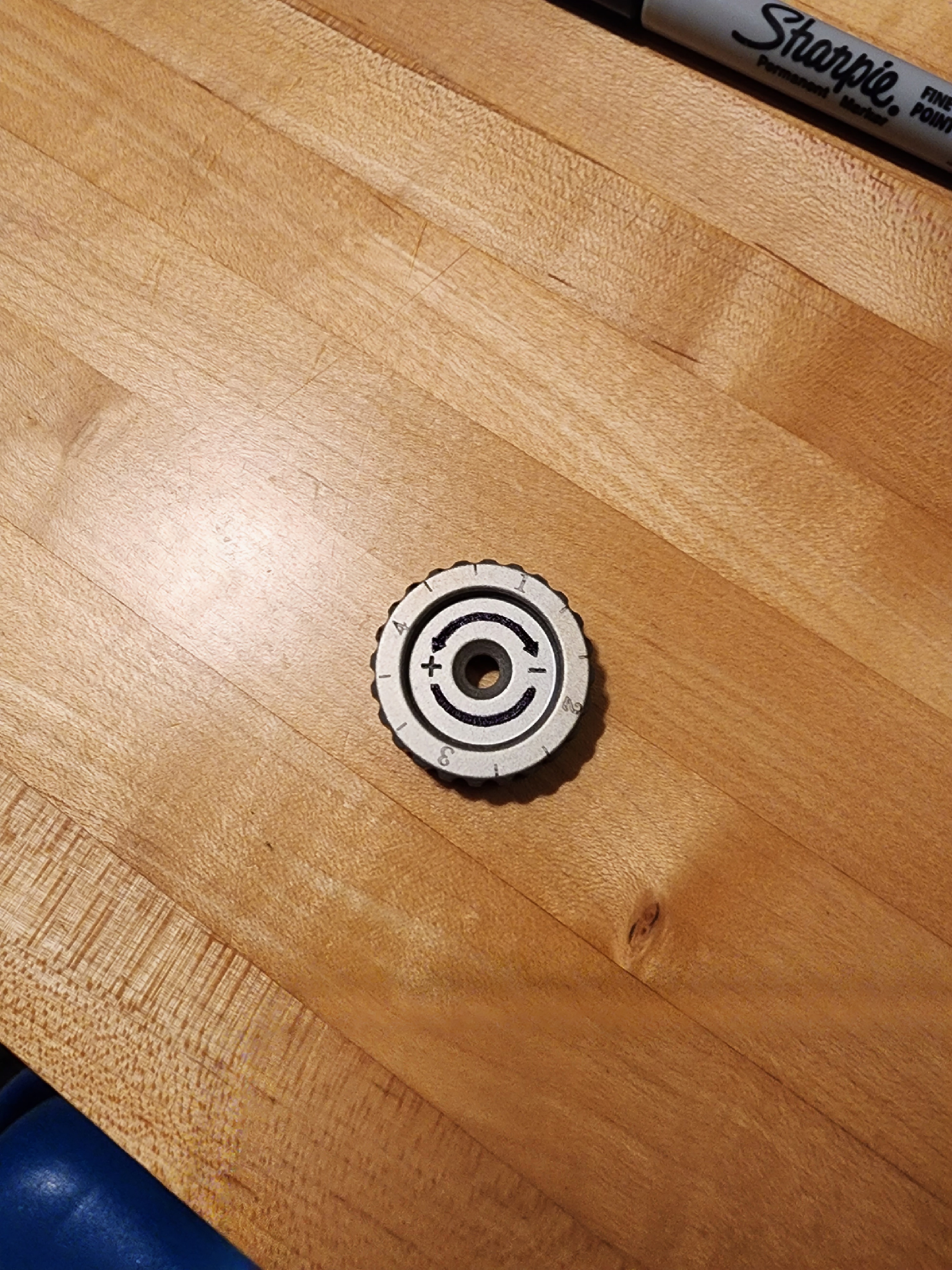

I got the wood .25 version from Kelly the end of December. I liked it so much I just got a .22 synthetic neither one of them are broken in but man oh man the first day with the .25 sighted it in at 25y than took a rabbit 40y. Kelly has been awesome and anyone looking for anything huben please reach out. The loading gate he sells is so much better than the stock one and highly recommend it. I have been working with a friend that does laser engraving and have my mag done and very happy with it. Next will be perfecting the power wheel.
