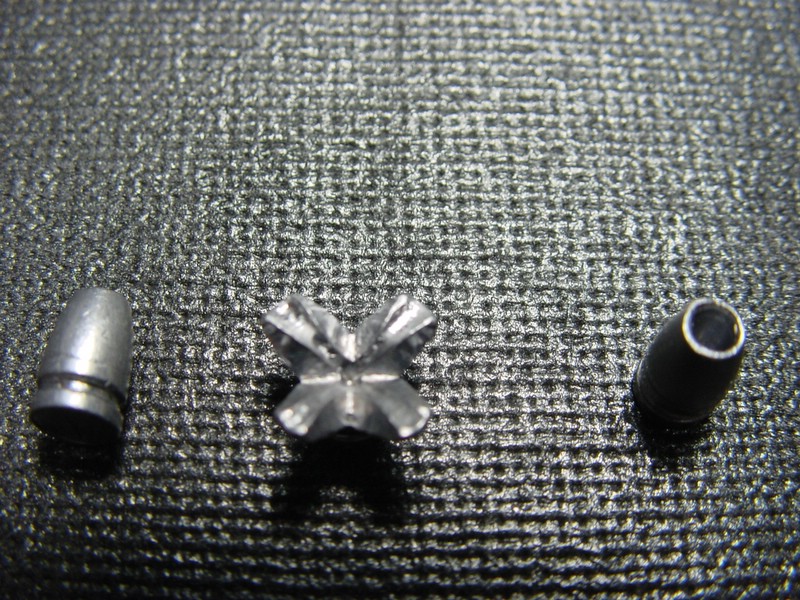

There was a thread on the GTA recently with people having no luck with Hollow Points in their pistols due to low velocity. Some even reported no to poor expansion in lower powered (600) or slightly more fps), pcp rifles. This led me to experiment further. As many of you know, I design and test slugs for myself and a few others.
Using a PP-700 .22 at 475 to 500 fps, I am having these results with my hand cast HP slugs. I will be making a fixture for my mill for repeatability for accuracy.

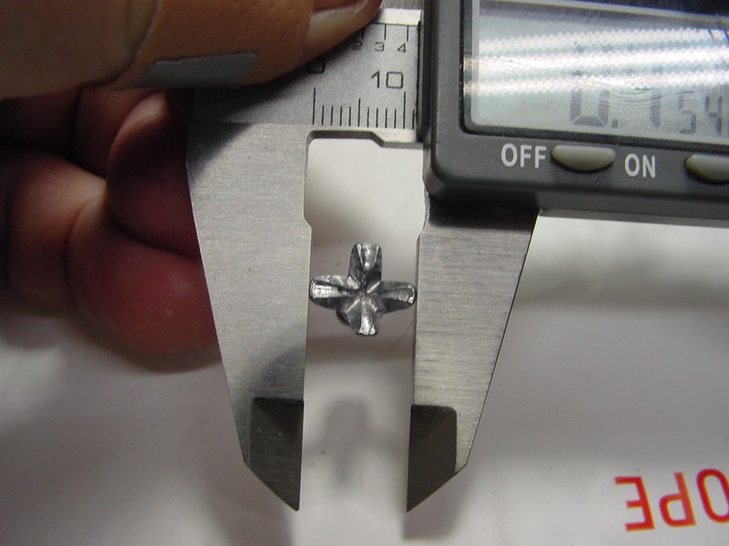

This pic is from the PP at stated fps, 20 yards into a simple water jug filled with simple tap water. Not a decent test, but all I had at the moment.
Expansion from the .216 slug was over .454" and I am looking for a deadly vermin slug when walking the pup here at night out in the country.

Woah that opens up nicely! Hard to get such nice flower. My HP's usually explodes and fragments on impact or than just fails to expand at all. I suppose its perfect speed matched with right size hp to have nice opening and near 100% retained projectile weight. Alltho if used for varmints I assume fragmenting aint so bad but for eatables it surely is.

The water test is very, very impressive! Thank you for sharing, Knife!

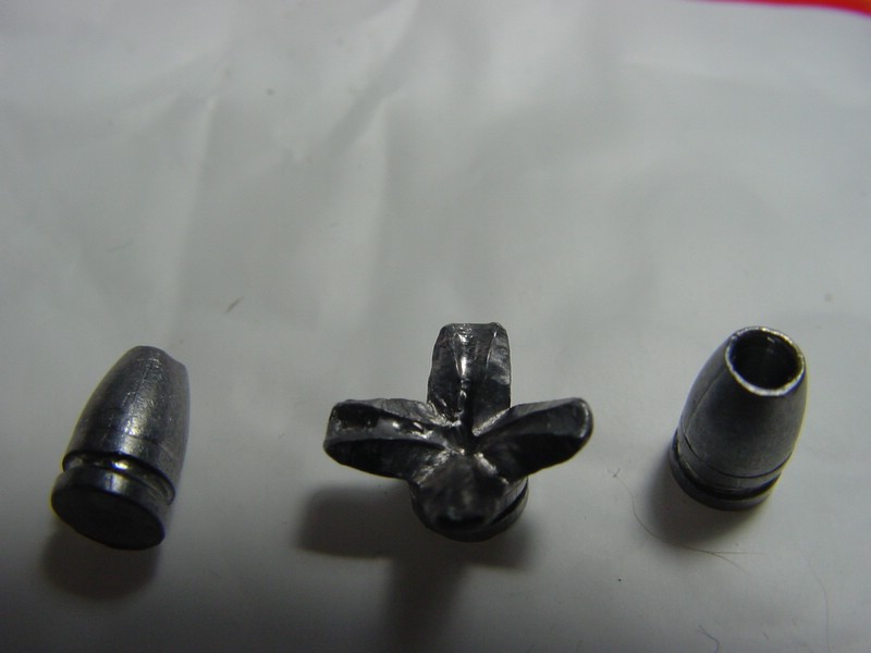

This was shot at 490+ fps in the PP-700. .22 cal, which in the pp is actually a .2164"
already tried on a trash bird. Literally blew it in half. Woo-Hoo!!!
Yes, mold is a Arsenal .225 mold that is a copy of the Lyman 257420 that I decked and converted into a 4 cavity hp mold. the final part is using a fixture in the mill to set depth for the scores in the hp cavity.
At over 1000 fps in the FX barreles Raptor, it is more like a pb varmint bullet. Explosive impact. FAr to much for edible meat. I designed it for pest as I skip the last procedure for game.
Here is the mold when I did the first two cavities only for testing before finishing with all 4. it is another mold, the NOE cc1. The mold for these slugs is an Arsenal 5 cavity. And a pic of the accuracy of he NOE version in the Raptor. One shot for reg. setting, 10 on target. 80 Yards. Evan withoug the second step,it is far too explosive for game, but is an excellent vermin slug. It is 35 gr at 960 fps. The pistol slug is 27.4 grs.
