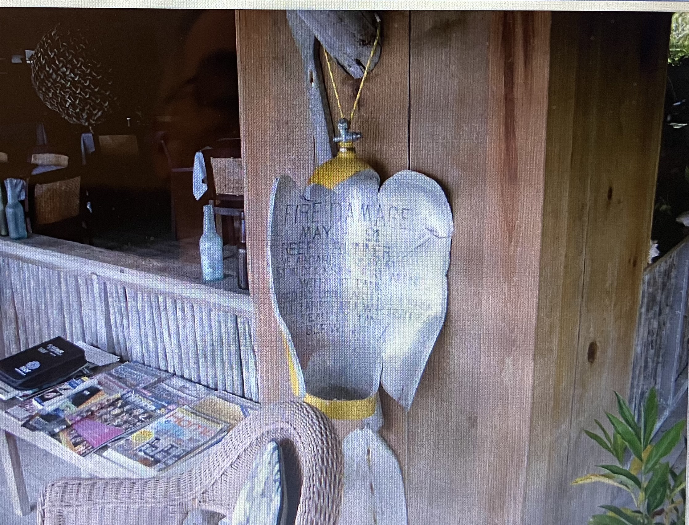

I was reading some internet SCBA info and was reminded of something I saw some years back while scuba diving in Roatan.
The info I was reading was fire department handling of SCBA’s. The standard practice for the department was to store SCBA’s fully pressurized. For the fire service it’s a no brainer why they’re stored full. There’s another reason though why it’s better to store high pressure cylinders full, or pretty close.
And granted it’s also sort of a one in a million kind of reason.
Back to Roatan. At the dock where our dive boat tied up there was a scuba tank hanging on the wall. See photo below.
There was a fire one night on one of the dive boats that the staff had not removed the tanks that were used for diving earlier that day. All of the aluminum scubs tanks were at around 300-500psi. Several of the tanks ended up like the one in the photo. Why?
All scuba tanks have burst disks in them. Standard 3000 psi scuba tank burst disks are rated at 4500-5000psi. Pure aluminum is dead soft. It gets all its strength from tempering. Aluminum scuba tanks and SCBA cylinder liners are 6061-T6. The T6 refers to the temper that the aluminum is treated to, giving it tremendous strength. Years ago Luxfer made tanks from 6351 aluminum that had trace amounts of lead in them to aid manufacturing. A very small percent of those tanks developed cracks in the necks, typically in the threads. Today most dive shops won’t touch a Luxfer 6351 alloy tank and industry wide they are supposed to be removed from service by drilling a hole in the tank or permanently damaging the threads.
So why did the Roatan tanks blow up at only 300-500psi ? In a fire a full scuba tank will heat up and cause the burst disk to rupture and safely vent the gas. In the case of the Roatan tanks, the fire annealed (softened) the aluminum to where all the temper was relieved and the pressure in the tank didn’t reach burst disk pressure, which it probably never would have, and the softened aluminum let loose, violently.
Food for thought as to what pressure you store your SCBA’s at. Not trying to kick the beehive or scare anyone, just some information.
