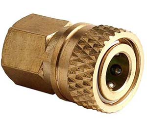

The QD fittings made by Foster have been tested and the brass is rated at a lower pressure than stainless.

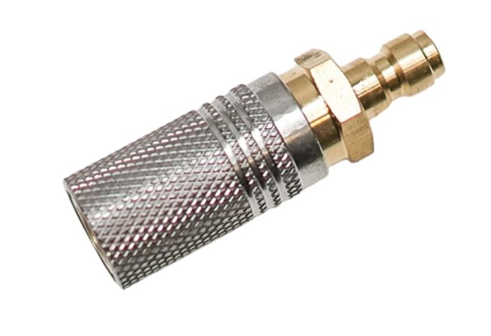

I have a couple of these Saber Tactical extended QD’s. I can’t find any PSI rating on their site. I just emailed them and asked where these are manufactured and what there rated for.
I can’t recall seeing any failures of these but not clearly stating there rating seems a little concerning. If you look them up at 910 Airguns they say 5000 PSI.

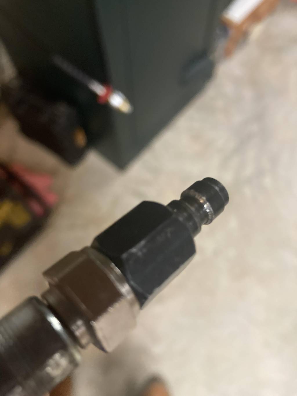

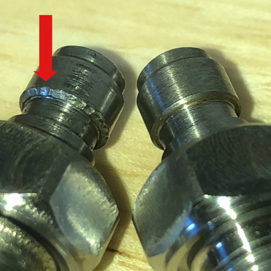

I noticed the male foster fittings on both of my tanks exhibit similar, but less severe looking wear from ball bearing contact that is shown in the beginning of this thread. They are both foster branded. The thing is, I have only used them for 6 months or less. I would say they got used for fills an average of 2 times a week. That's not very many cycles, and I'm sure it has been there for a few months before I noticed, which would make the cycle count even less! I wonder if this is the sort of thing where the balls have to wear/bed into the male fitting and end up work hardening the engagement surface a little in the process. Ball bearings are round and extremely hard. The engagement surface is flat and unlikely to be as hard even on a quality fitting. It seems to reasonable to me that the small contact are between balls and a brand new fitting would lead to the balls bedding into the fitting slightly, which would increase contact area and then wear would not progress further.
Swapping out quality fittings every 10-30 uses doesn't sound practical or sustainable. I'll keep an eye on this and also pay close attention to how soon the wear shows up on any brand new fittings (I bet it will be as soon as the first use).
