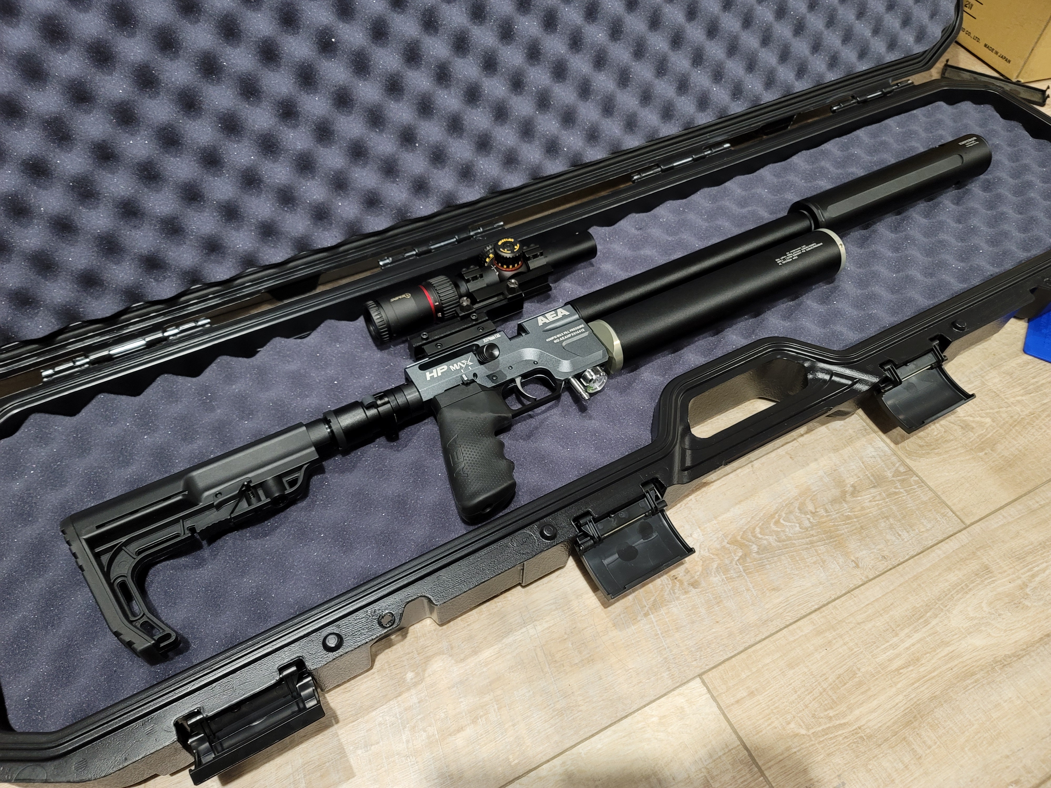

The HP SS Max 357 was my first pcp. That snowballed real quick into a bunch more, but still a relatively cheap, fun and powerful option. That said it could be a lot better in a lot of ways. This thread is to share my tweaks, addons and improvements.
The biggest annoyance with this rifle is the right hand bolt in conjunction with the right hand magazine. It's a game of twister to insert and remove the mag due to the fact that you have to hold the full force of the hammer spring back with your right hand, flip the rifle over, then reach over the scope to put the mag in place.
I've had a couple of ideas to make this better. First idea was to make a left hand magazine. Second idea was to make a mechanism to hold the bolt back, and to mill the left side of the reciever for an ambidextrous bolt. I'm going to go with the second idea, since it will also make the gun easier for my lefty wife to enjoy.

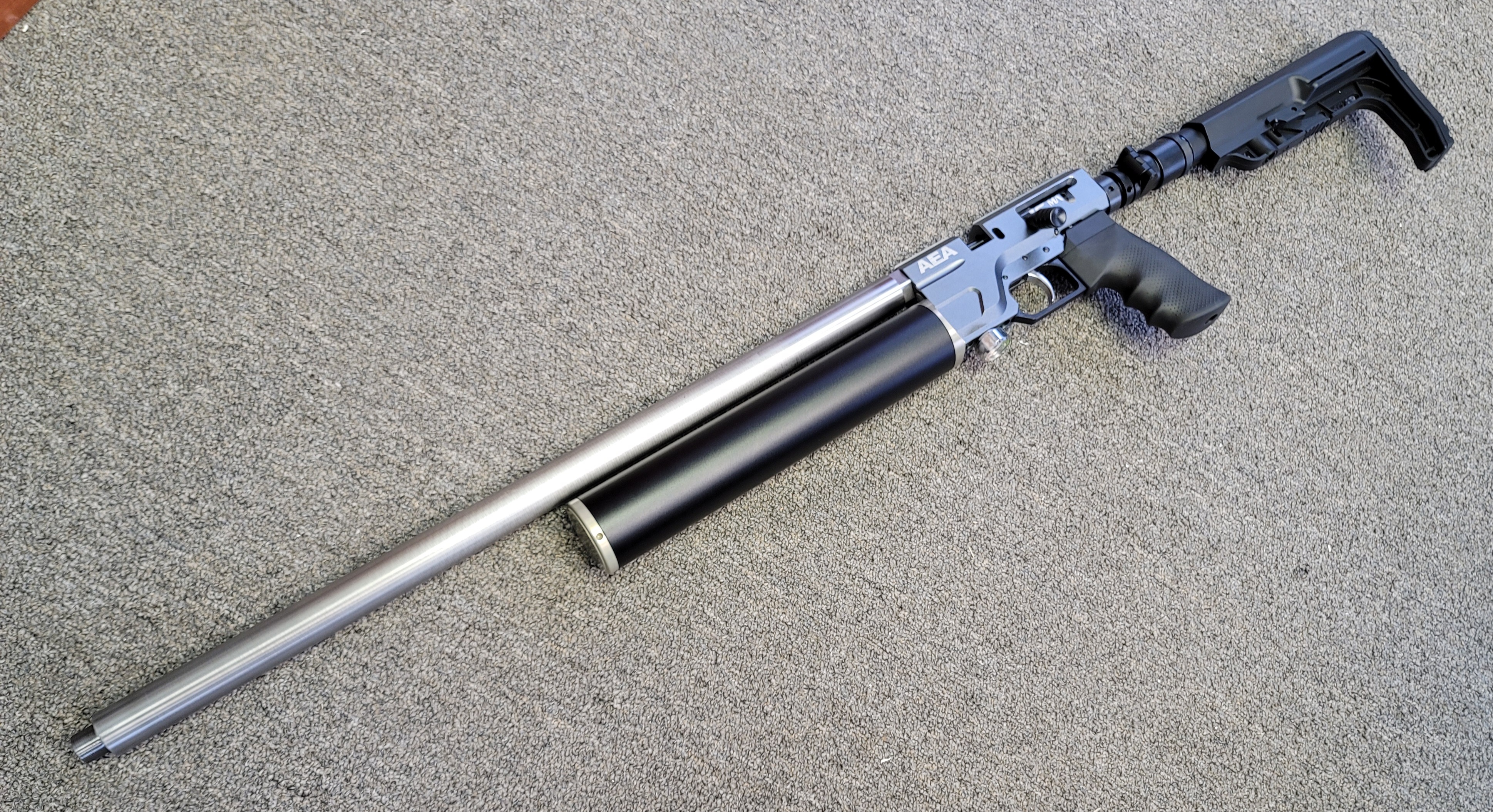

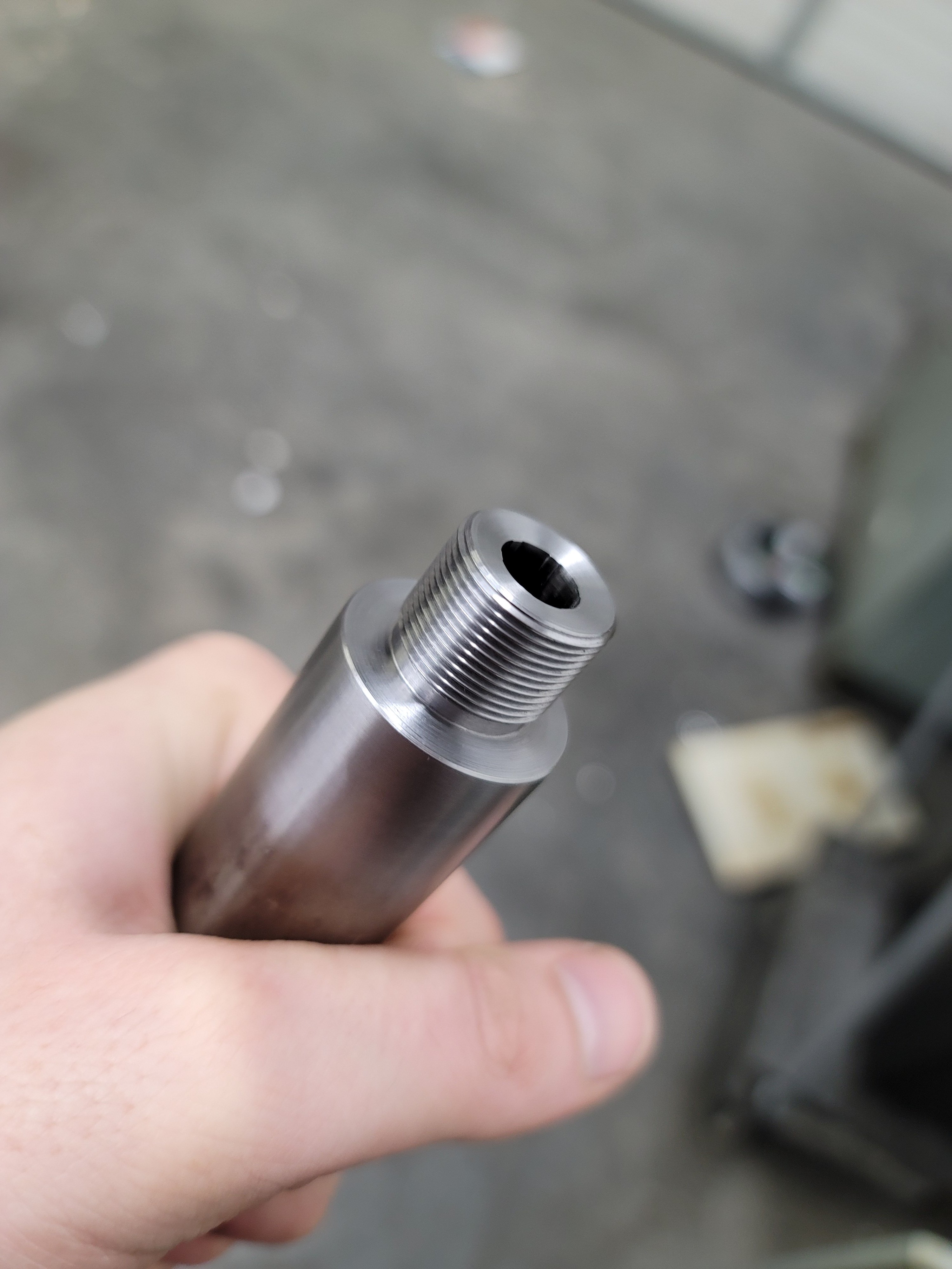

Another thing is that, while the short barrel is very tacticool, a long barrel would be pretty cool too. I called around looking for a longer one with no luck... so... I went shopping for a blank. I've got the machine to do the work, first time working on a barrel, but I've done many similar cuts and features in the past so probably no big deal.

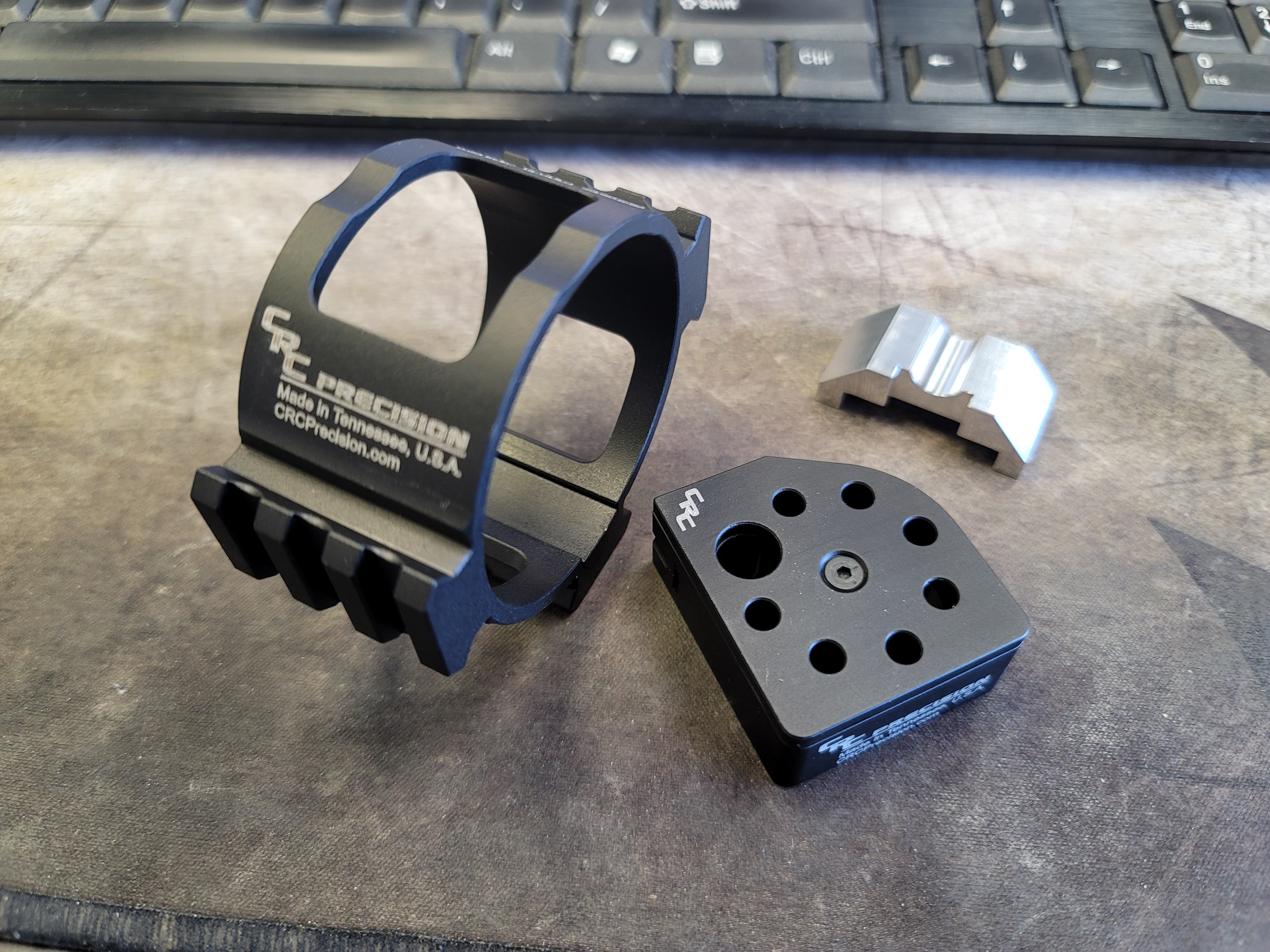

The HP SS Max could also use a few little accessories... some have already been made and are getting anodized at the moment. Still have a couple more ideas for accessories that may or may not work out.

I only had a chance to put a few rounds through it before the sun went down... but about 220 foot pounds with a 108 slug at 4kpsi. Based on the 3 or 4 mags I ran through it accuracy has noticeablely improved as well. I'm very excited to sit down and spend some time tuning!

It weighs a whole lot now lol. The barrel alone is 5lbs. It shoots well so far, going to contour the barrel which will bring it down from 5 to 1.7lbs.

You might want to remove the barrel and push some slugs through it. Also inspect the leade and crown. You might want to lap it if the bore is tight and of course polish it too.
What am I inspecting the leade and crown for? I machined them myself, they're clean, smooth and burr free. Crown is 11deg, leade gently tapers into the rifling. Both dead on concentric with the bore. I've got the machining thing down, but I don't have a clue about the minutia of crown angles, chamber dimensions etc. More or less copied the chamber from stock, with a slightly tighter leade.
Grooves are spot on .357, bore at .347. Both slightly bigger on one side which became the chamber end.
I've noticed some differences between the new barrel and the stock one... no idea if they're changing things for better or worse... Stock twist is greater than 1 in 24", this is 1 in 20". Stock rifling is a rounded profile, new barrel has sharp square profile. Stock barrel had a bigger bore. Both grooves mic at .357, stock barrel bore is .3525" and new bore is .347".
