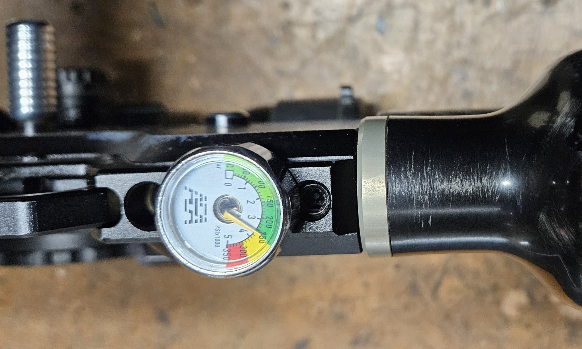

Still will work. You move your gauge to the second hole in the receiver after removing the inner screw.

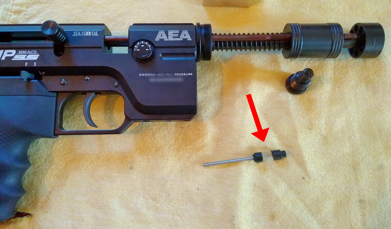

Glad you got it working again.The valve finally arrived and the airgun is in working order again, apart from the usual magazine jams...
So the issue was only the broken valve, not the trigger or a stuck pellet in the trigger block.
Basically the valve of this airgun is trash... I have also ordered the reinforced version from ebay
just to be on the safe side. This airgun would have been top if it had a proper valve pin and the
metal magazine from the JTS Airacuda max.
The airgun was left in the closet for 5 months with 220 bar pressure and when I tried to use it again,
the valve broke in half on the first shot. It looks like that this valve cannot handle the 220 bar, so
in my opinion if you store the airgun, at least do it with a lower pressure like 120 bar or so.

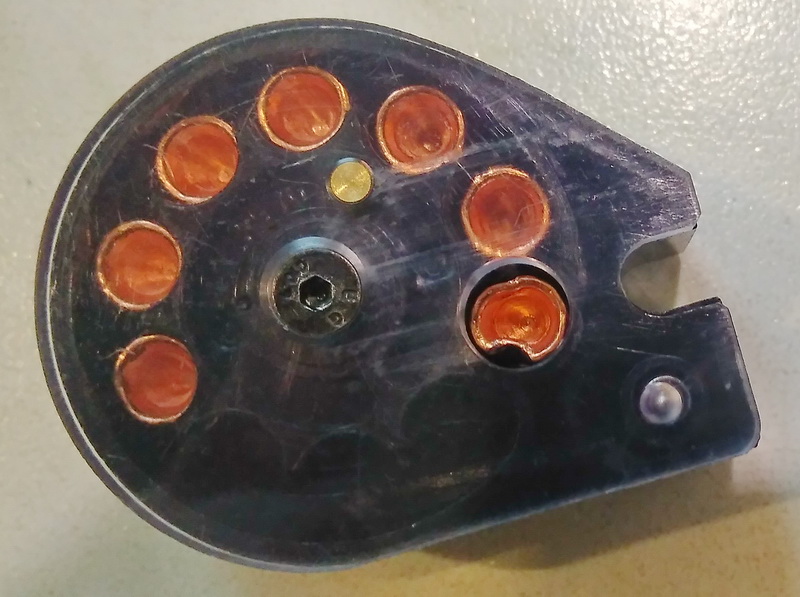

It does look like the probe but I’ll let Siccumj or Firewalker answer this. I was confused at your picture but remembered you aren’t shooting lead pelllets but copper.Can you (or someone else) think of what might be causing this kind of pellet deformation?
Before I installed the valve, I cleaned and lubed all the metal to metal moving parts and
it is cycling much smoother now. The mark is on the bottom of the pellet. Could it be that
the pellet probe is returning now faster than the magazine can rotate? It looks like that I need
a stronger magazine spring, what do you think?
