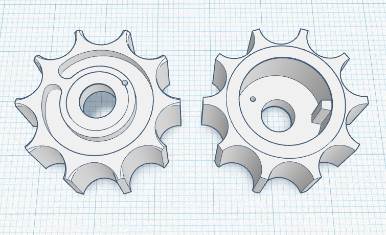

I don't really like the SF, it looks bodged and it still has the same magazine issues!
Despite all the complaints from all the HP owners, they still supplied the same
crappy magazines. That is why I am saying no more AEA for me.
I have already designed a replacement magazine that I was going to produce using
titanium, custom springs together with their aluminum housing but then all their
metal magazines disappeared and I was not willing to spend more time to fix all their issues.
Especially after what happened now!

Friend of mine just purchased both pistol and rifle. He sold the pistol couple days ago after shooting the rifle. About 3 G's all said and done. He has had AEA HP and SF. The SF regulator helps with consistancy. Making mags out of titanium sounds a bit overboard, why would you use that? If you have that skill set surprises me you couldn't keep a HP running. You could have made a poppet out of PEEK and been done with that issue. Your pellets in the trigger will cause it to not cock but not self discharge. That issue by the way is normally do to bolt bounce. People cure that by fill pressure or adjustiing the cylinder at the end of the barrel. Take care and good luck in your rifle hunting.
You could sell the rotory wheel if you could 3D print it. Looks like you have most the work done.
