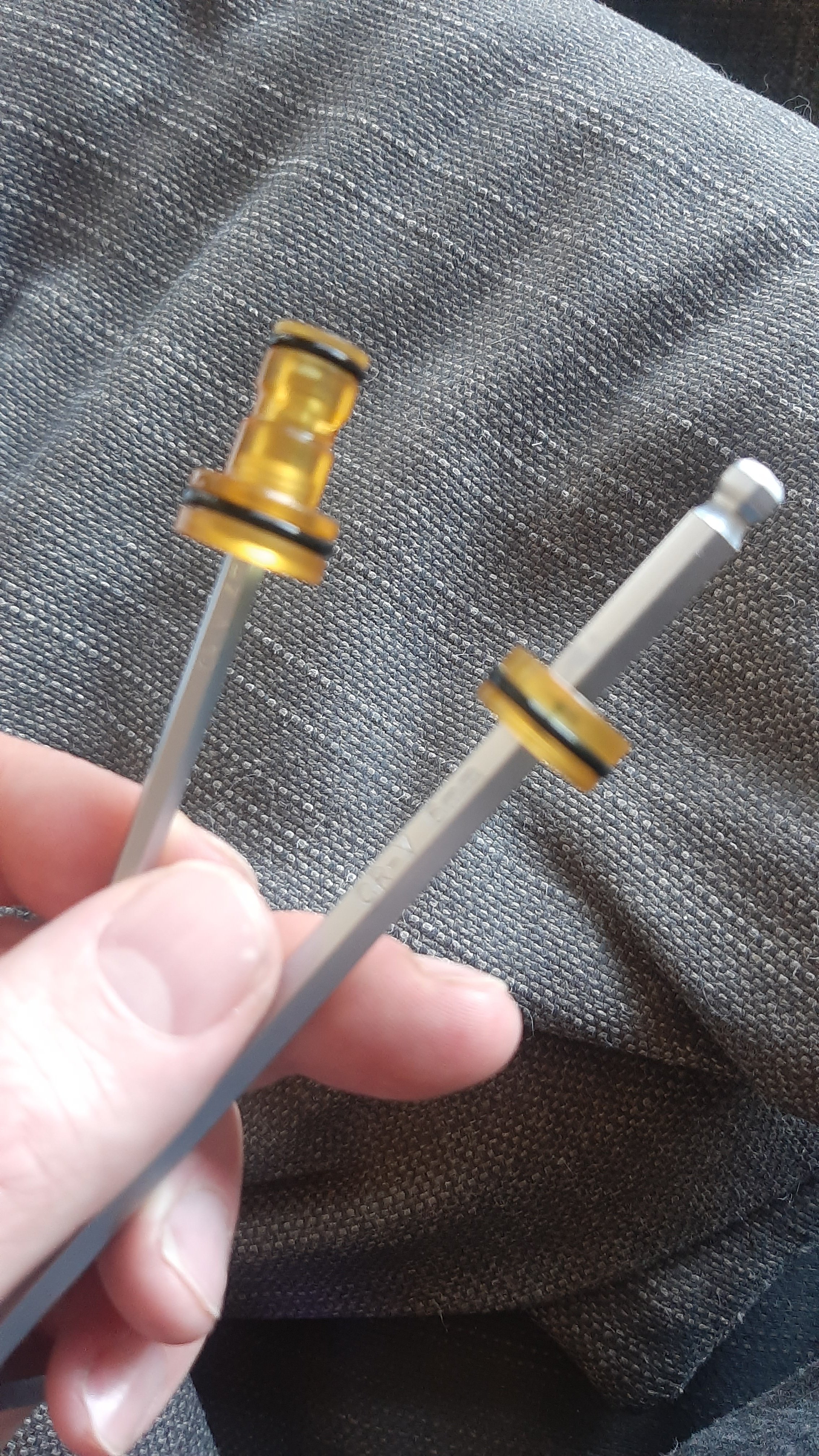

I also live in NL and have two HP MAX .45's with the exact same problem with O-rings being sliced. I got ID15x1.5mm rings like you said you used in your rifle but for me they wouldn't seal...

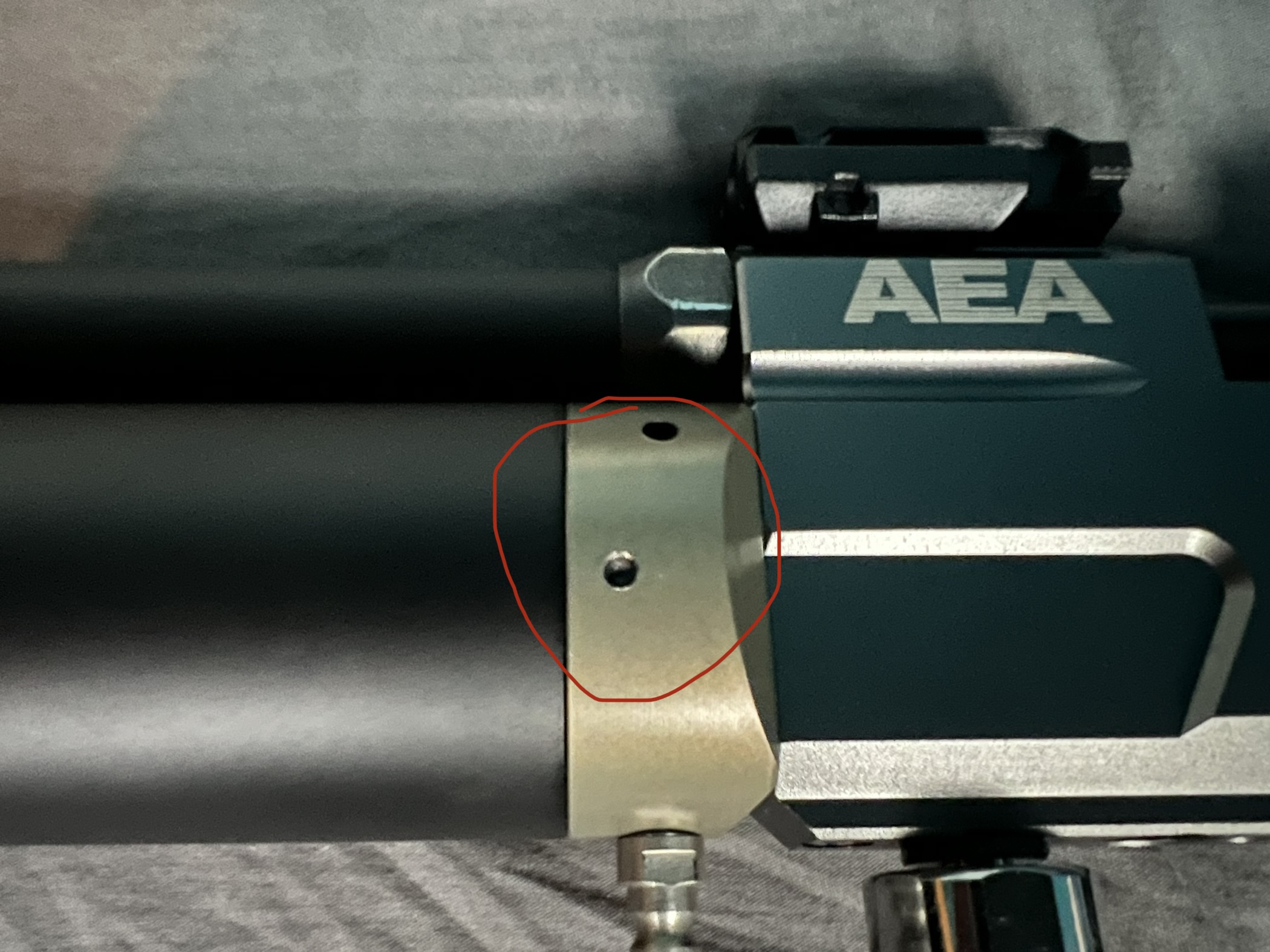

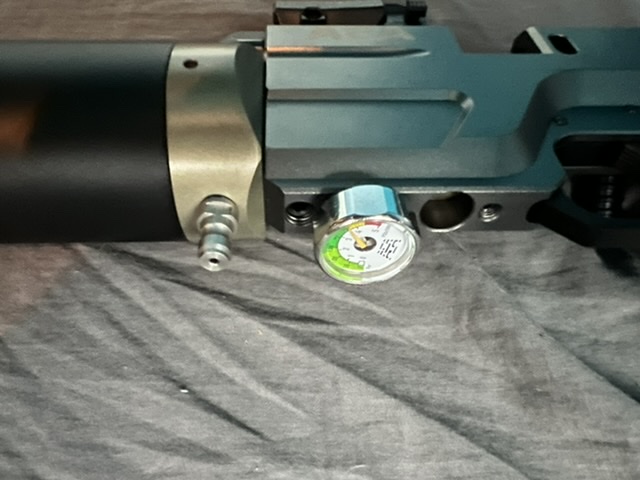

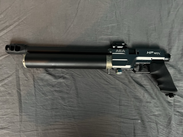

Hello Dutchies, I have the HP Max .50 from AEA Spain Wolfiek group. I'm also from the Netherlands. Mine was also regulated and rebuild to full power. First with the full power kit, but the ring which closes the regulator port was blocking 1/4 of the hole to the transfer port. So I got rid of it. I drilled out the atmospheric hole to 2,5mm and threaded the hole in M3 thread. I put 3 M3 x 5mm headless allen screws in with mastic kit to make it airtight. The second manometer / gaugemeter made place for a M8 foster valve, so I don't need the fill probe to fill her up. Pictures will follow.

Wolfiek promised me the original bottle adapter which is thinner and hasn't got the second manometer. I can't fit any muzzle device with this thick one!
The foster valve sounds like a great idea though. Might try that myself...

And did you also have damaged O-rings on the bottle adapter?
