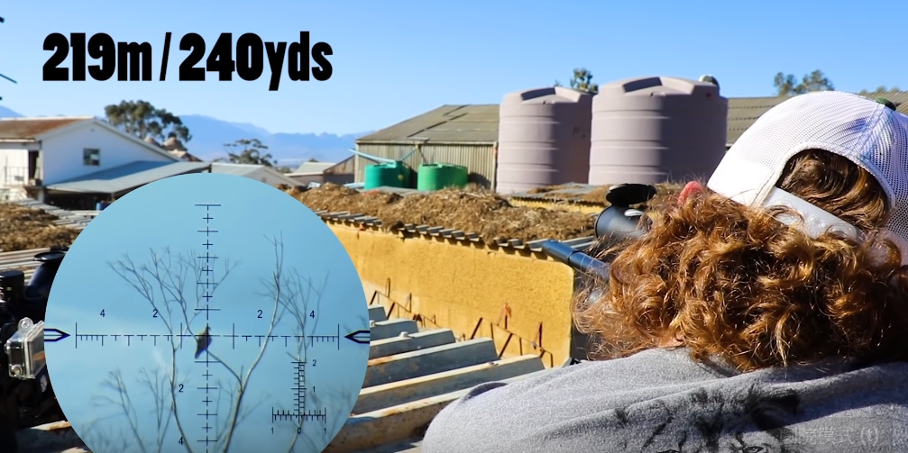

Hello Everyone,

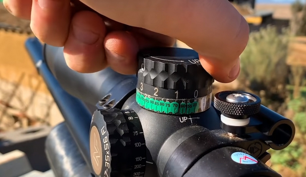

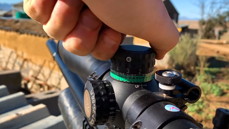

I believe that a lot of shooters have not enough elevation to adjust the long range shooting.

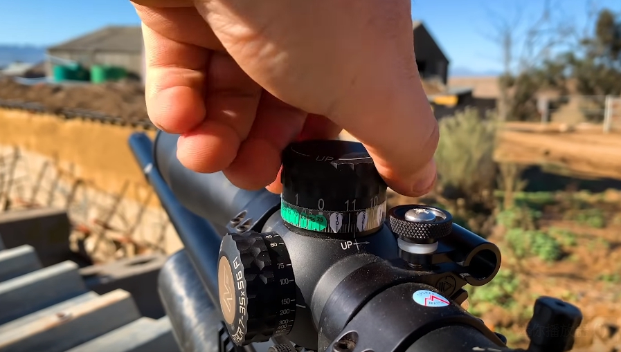

But found the Matt's video which he can shoot over 200+yr easily. From the video 11:22". You can see:
0 elevation to 25yr
2.8 elevation to 100yr
8 elevation to 170yr
11.5 elevation to 210yr
I Check his scope is ATACR 7-35 X 56 F1 34mm tube and Sportsmatch scope mounts. The scope ring should be not adjustable, because Sportsmatch doesn't have Picatinny adjustable mount for 34mm tube.
I used Strelok app to simulated all the conditions. hard to reach Matt's setting. And it's unbelievable he can shoot 240yr and still can use the center of reticle.
https://youtu.be/U2Hvrm6pmXc?t=683
https://nightforceoptics.com/atacr/7-35x56-f1
https://www.sportsmatch-uk.com/products
Does anyone know how he did?
Thanks.

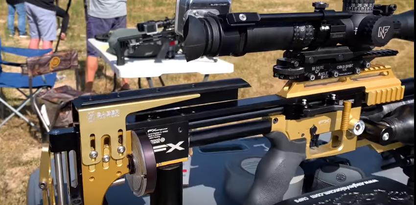

He may have built his scope rings for additional MOA as well. It would be an easy thing to machine in the additional angle on the rings and have the scope turret dial down the reticle to the desired range. Sportsmatch may even make the desired rings with a built in MOA for a customer's specifications. Matt is known for taking that scope with him overseas to shoot competition with a borrowed Impact from the local airgun supplier. He just mounts his scope and tunes the Impact to the scope settings; a brilliant idea really!

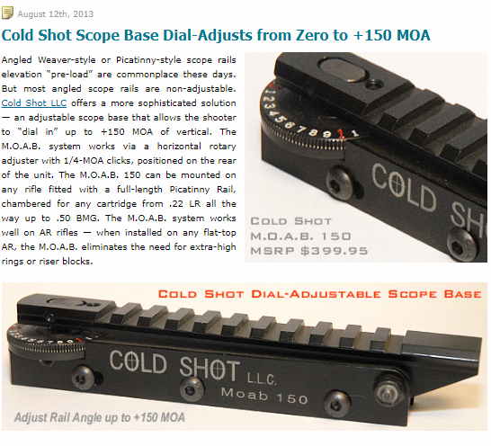

I spotted a Cold Shot 150 moa adjustable rail on an Impact Matt was using while shooting with the Utah Airguns crew.

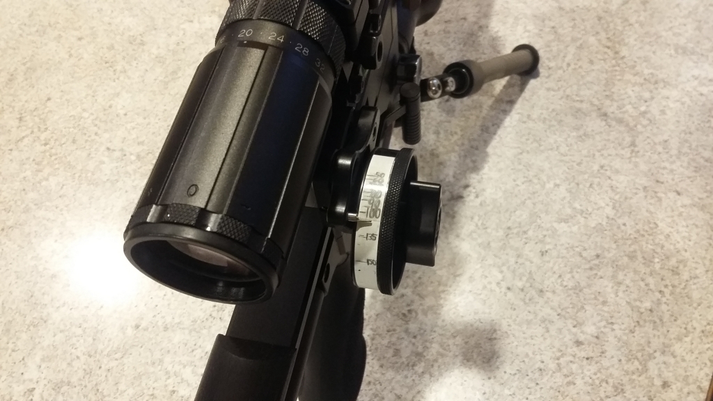

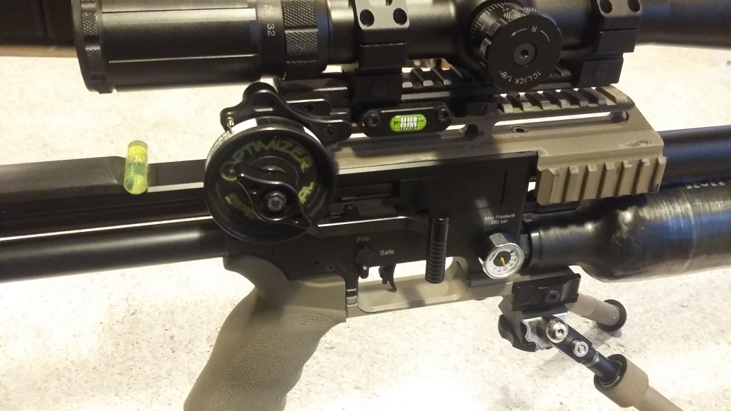

I noticed that as well. I've tried to turn folks on to the HHA Optimizer a few times now and I'm always suprized how few people take advantage of them.
Long_Shot and I were shooting his rig out to 356 yards yesterday. His generic wheel tape goes from 0-80 and at 356 yards it was set just under the 50 mark.
 This is the Optimizer on my Impact. They have a nice snug feel to the wheel and are very repeatable and precise. You don't have to stress your scope out or have it out of optical center to shoot various extreme ranges.
