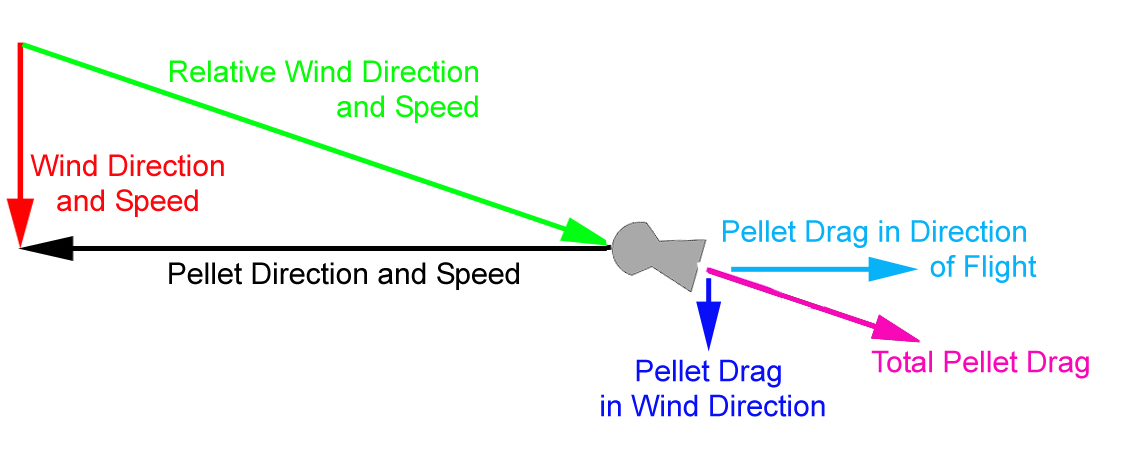

When there is a cross wind, the air direction is not just due to the pellet speed. There is also the wind speed to think of. The pellet though does not see two separate wind directions, it sees a combination of the directions of the cross wind speed and the wind speed from the pellets own movement creating a relative airflow. Again, by the definition of a stable pellet, the pellet will turn to face the direction of the relative air flow from the cross wind and the pellet speed. The diagram below shows what is happening.
If the pellet is facing into the combined relative airflow, then there cannot be any flow on the side of the pellet to push it sideways down wind.
Since the pellet is facing the airflow, the only force acting on it is drag, and it is part of the drag force which produces the downwind drift. The next diagram shows how this happens.
It all comes about because the pellet is not actually pointing in the direction in which it is travelling, so the drag force is at an angle to the pellet's direction of travel, which makes some of the drag act in the direction of the wind. It is this small component of the drag which produces your downwind drift.

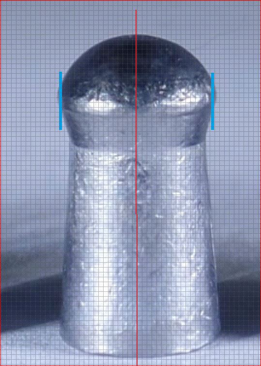

I just received my pellet sizer last week and already did some modifications to it. Finished and working well now.
My intention is to fix or try to fix some anomalies with .22 MRD's (25gr), these groups reasonably better @50 in milder windy conditions then the lighter pellets but doesn't group well at 100 even without a wind, and that bothers me.
In mean time the Canadian winter started at my place, so intensive testing or paying full and undivided attention outdoors - these days - is not for my liking.
So tinkering only in my room in front of a PC ... sizing pellets (meaning making a flat ring on the head where is a blue line shown) - would that improve on aerodynamics?

It will not make any noticeable change to the aerodynamics. Depending on the pellet fit in your barrel, there may be an improvement in the pellet yaw behaviour after leaving the barrel, or it may get worse and open up your groups. You are unlikely to see any large change in the cross wind behaviour.

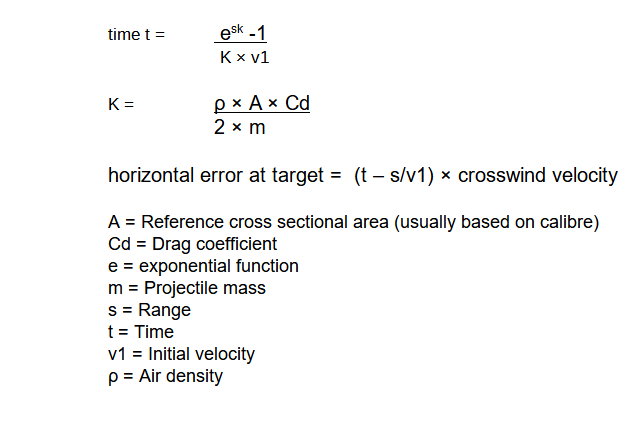

@Ballisticboy, would it be possible for you to write a general function that explains this phenomenon. I do comprehend your theory in this explanation.
Depending on the degree of the drag and/or force, whether from the relative wind direction or pellet direction, would help me better master the art of shooting in the wind.
Picture me having an equation in my head while assessing every pellet that's shot from my gun. Thanks!
The only relatively simple equations are the ones below, which will only apply for short ranges and low angle fire, where Cd can be assumed to be constant.
For long ranges, Cd and V1 are both changing and are interdependent, so an analytical solution is not possible. Then you need a trajectory model.
You can get a rough idea of the Cd from the form factor of the pellet used in the BC and the reference drag law.

@Ballisticboy, thanks this is a good start to the theoretical model. I'm glad you provided the definitions to the variables. However, there's one left. What's the definition to "k"? I assume it must be related to the general model of bullet coefficient (BC).
In long range shooting, BC is not constant.
In all of this, I'm just being unscientific by applying the theoretical model in a practical manner from observing my own shooting. I enjoy the math just as much as I enjoy shooting.
K is defined in the second equation.
