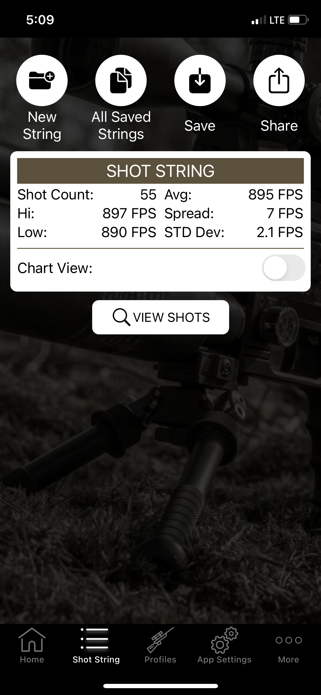

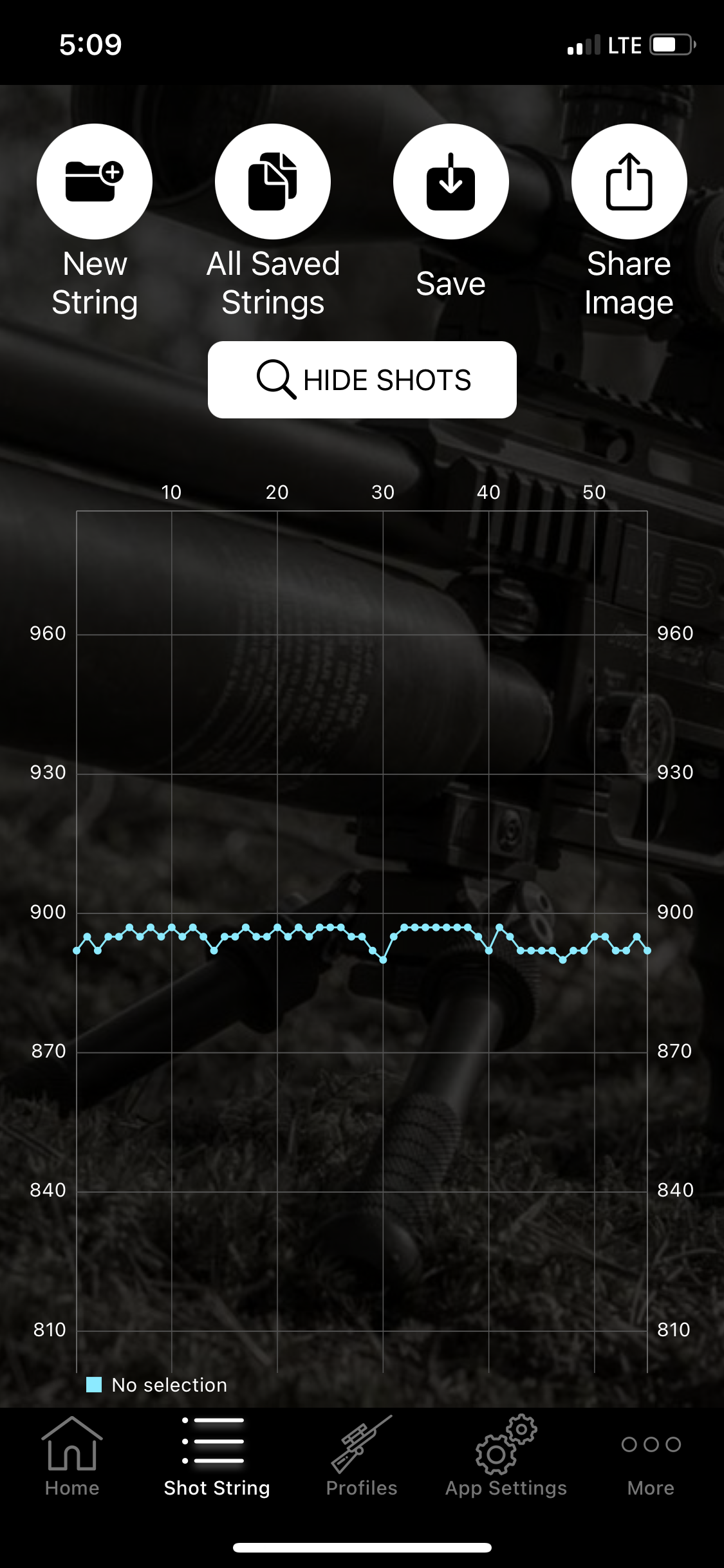

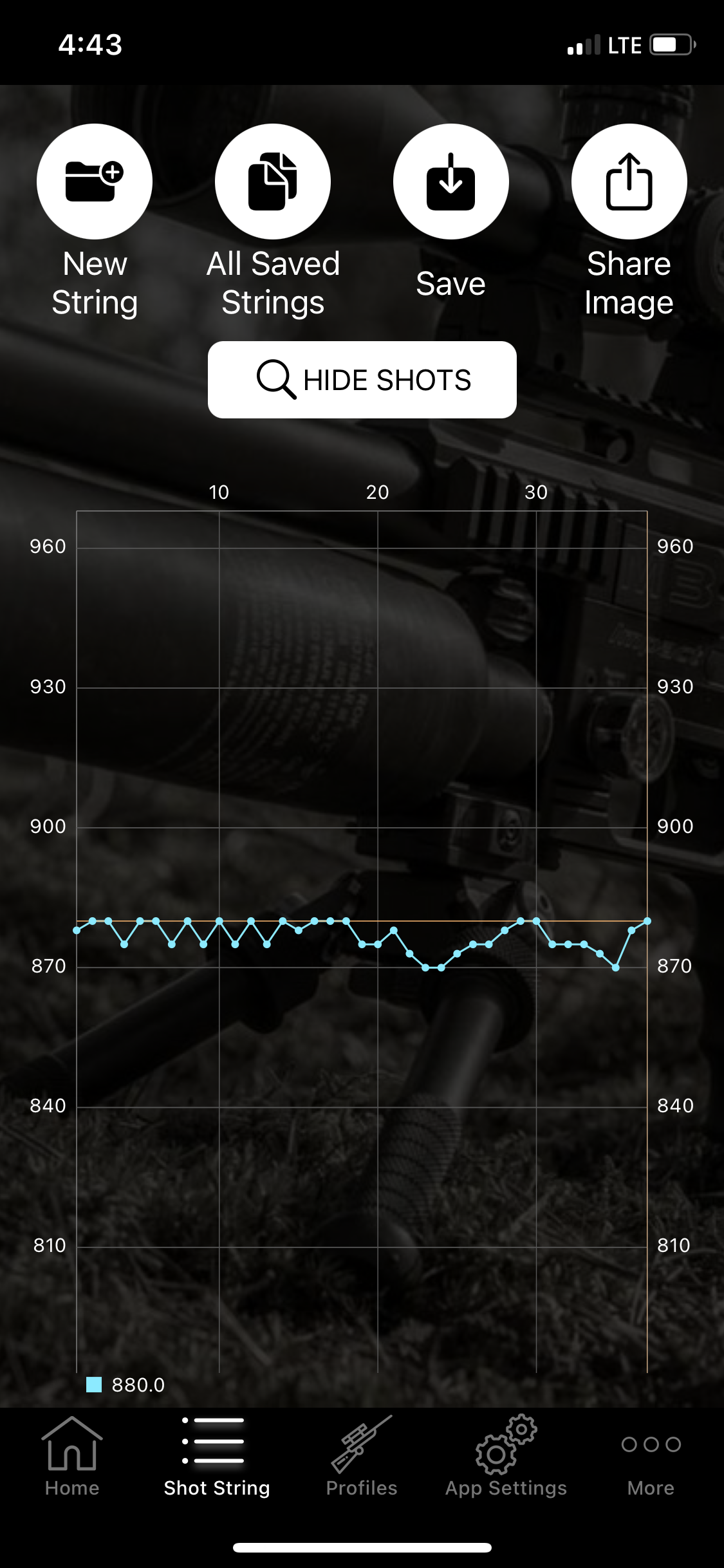

The S510 XS is no less tunable than any other platform - the trick is that it is not easy to tune externally. In my experience all of the AA PCP's come with outstanding tunes right out of the box. I've posted screenshots below for my S510 Tactical in .177. The first shot string is on full power with the 16gr JSB Beasts and the second is on power level "3" with the 10.3 AA pellets. Absolutely outstanding ES and StdDev.
Here is full power (16gr JSB's).
Power level 3 (20 FPE)
Again, this is the STOCK tune that came with my .177 S510 Tactical.
