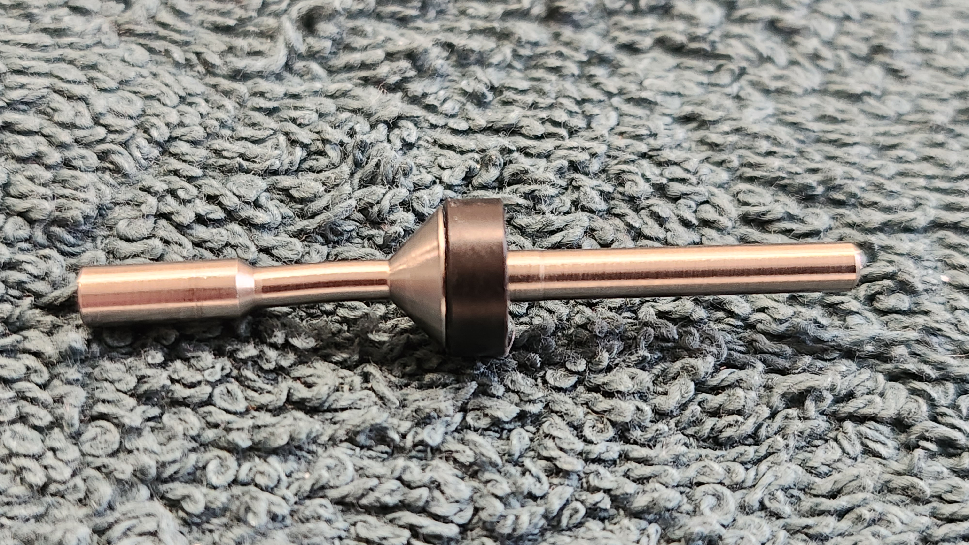

Forget heavy hammers. A lot of people are finding bend valverods in their Panthera. You can get new ones under waranty, but how long will they hold. Cause of this is the hammer hitting the valve with the side.
