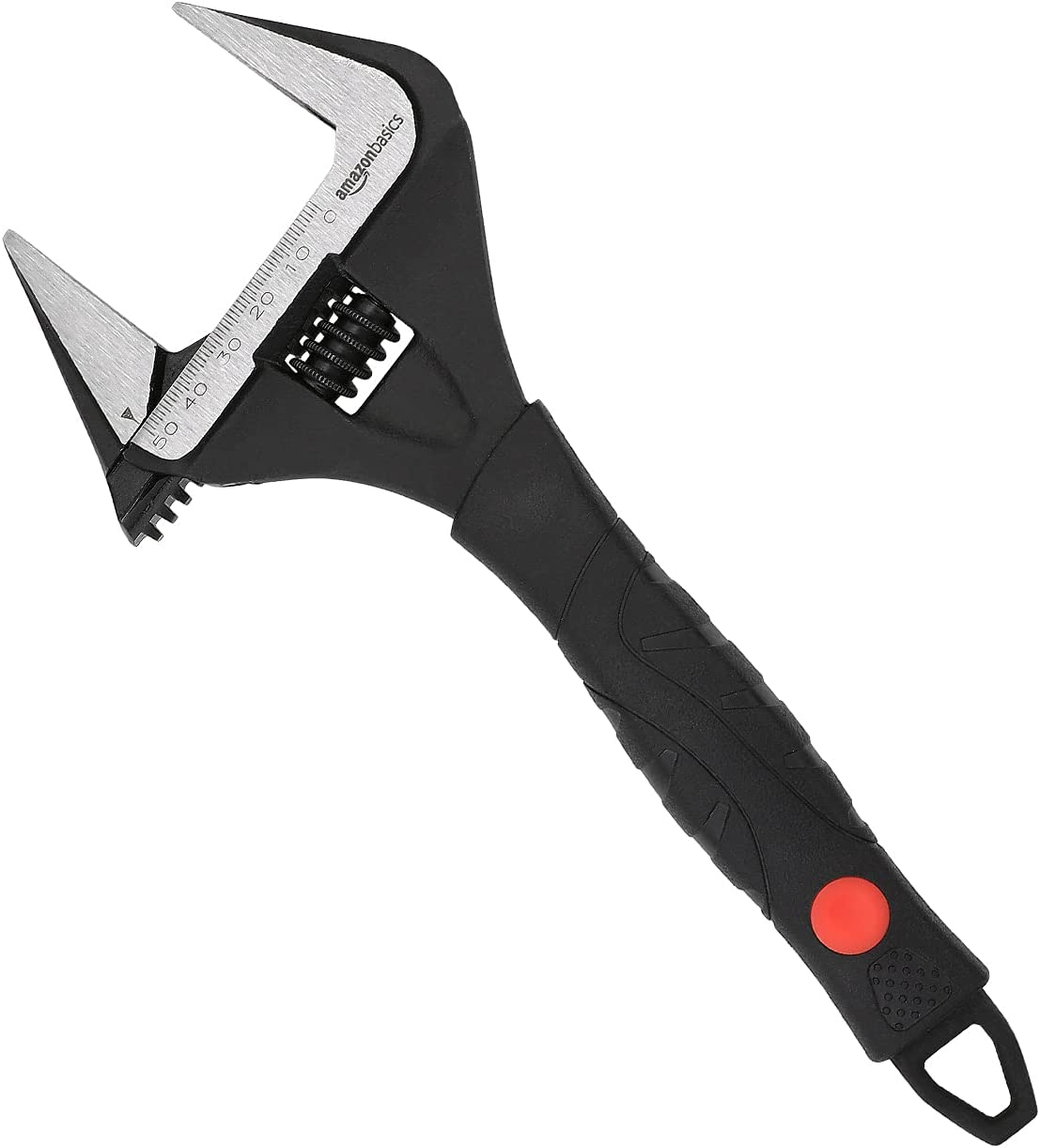

I never found this old thread when I was searching for how to remove an SCBA valve. Good find. When removing the valve assembly, a firm blow on the wrench handle with a heavy plastic / dead blow mallet should do the trick. I was able to remove two valves on 10+ year old tanks with a wrench and a deadblow hammer. I was able to get the valves broken free with no need to secure the tank other than knee pressure on it on the floor and thanks to the advice from Scotty1 in this thread of mine. Just make sure you get the lefty loosey part down before you strike the wrench. You may need to remove the hanging bracket and / or the burst disk to get the wrench on the flats depending on the model. One of these $17 wrenches from Amazon comes in handy if you don't have an open end or or adjustable wrench that fits your valve.
