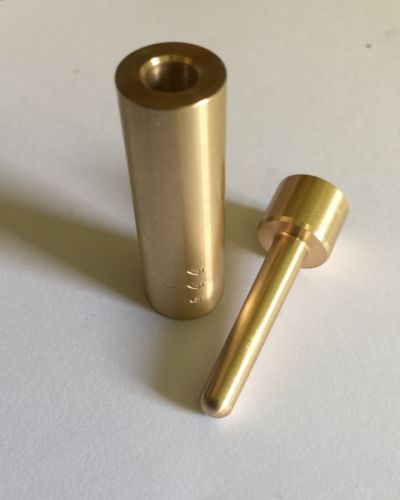

If this sizer makes the heads and the skirts the same size, that would be undesirable. You always want the skirts larger than the heads. The TR Robb sizer does this, it is more expensive, but 1000% worth it. I explain all this and more on my U Tube Channel, Field Target Tech. I describe my methods of pellet sorting from washing and lubing, weighing and sizing, as well as rolling, and I describe how and why you should do this for supreme accuracy. It's filmed crappy, in my opinion, but it's the information that is important.
