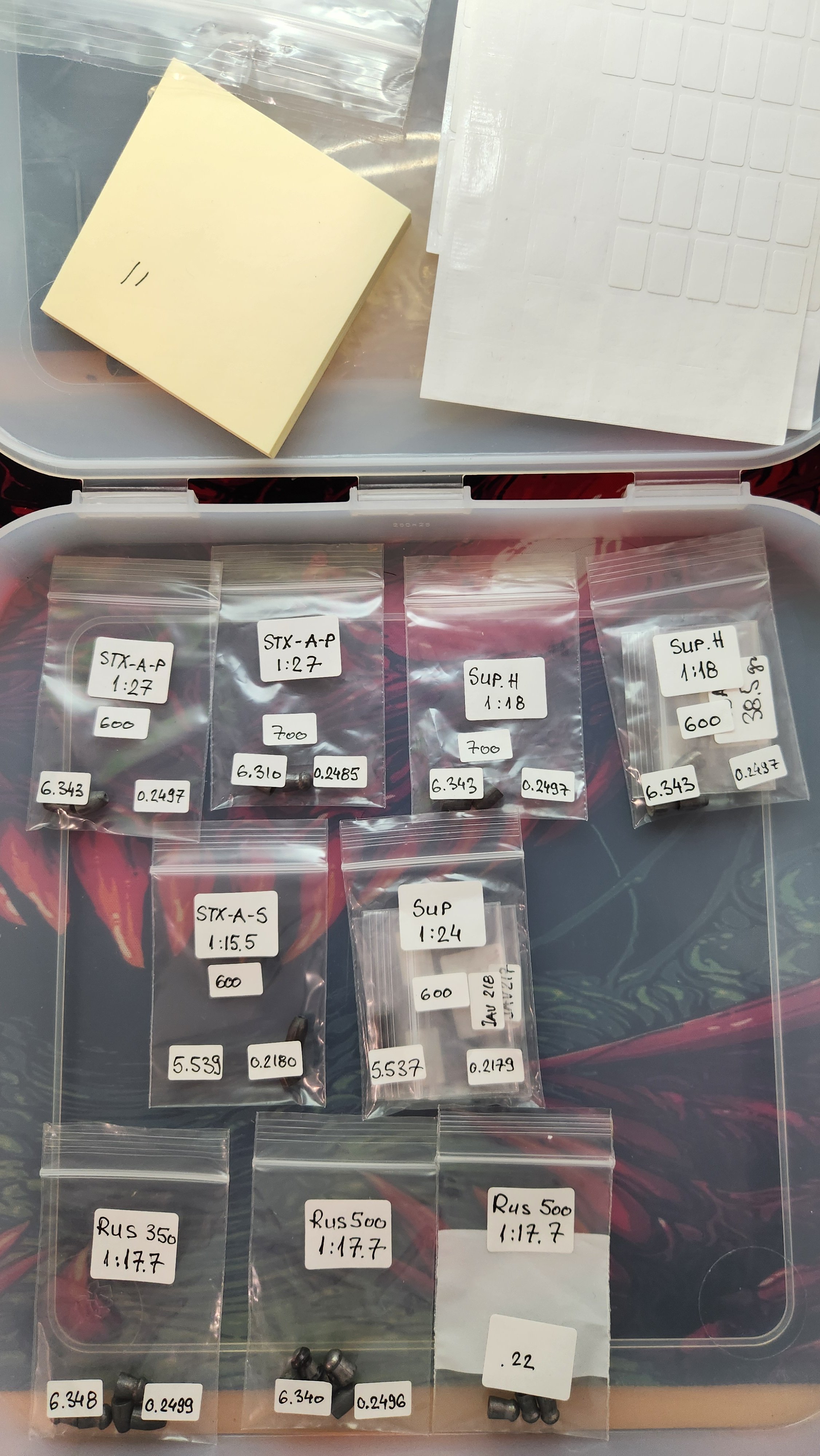

I have small zip loc bags I put a sticker on with my notes which caliber / barrel / twist rate / and the measured size.

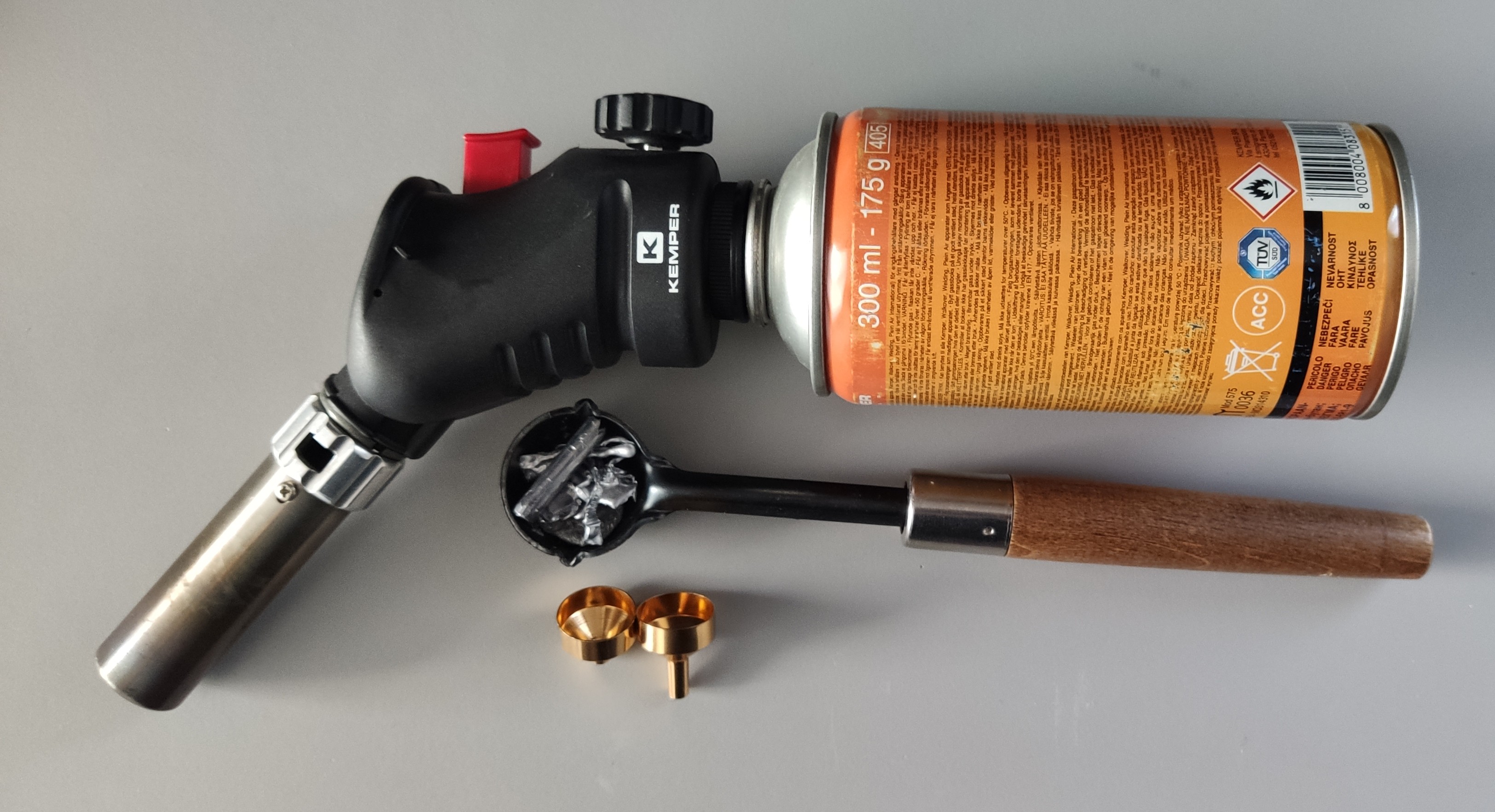

nice.. what does it cost to get into that, how do you melt the lead, grandpa used a white gas blowtorch and a ladle for sinkers.. I still have it, but I assume that there's a modern way now.. how many slugs per mold? just wondering how long it takes to make a decent batch..
myself I have not cast anything except babbit bearings and I was working with the supervision of a good old timer, but unfortunately I don't remember all the details.. was probably 15 years ago and only once..

looks like a propane torch and a funnel?

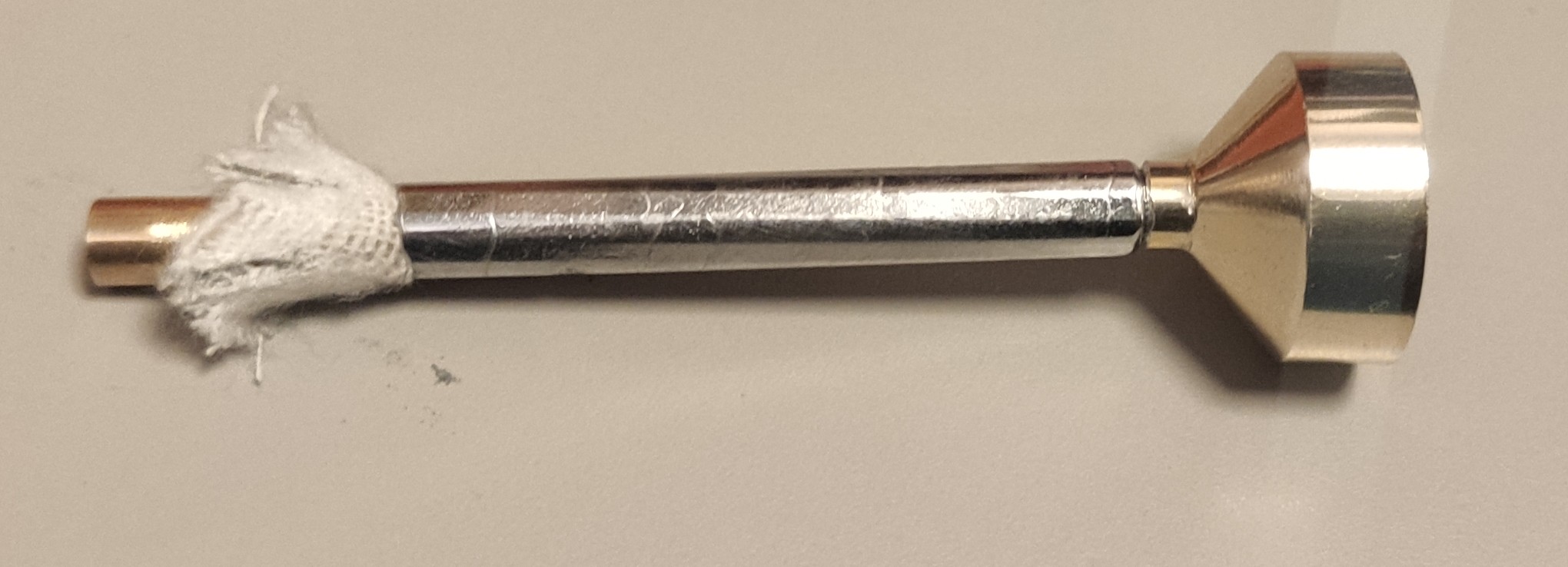

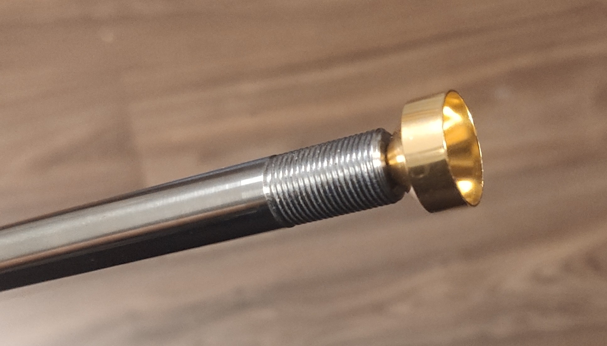

I don't understand about the title for lapping with the pictures.. I assume that it's for casting? any pics of the molds?

When you perform barrel lapping you need to have so called barrel lead lap. You pour melted lead into the bore and that is your mold which produces a negative sculpture of your bore. Then you apply some polishing compound on the lap and you are ready to make your bore as consistent as possible. However, it is a time consuming process and it needs some practice to be done correctly. The funnel is there to make it easier to pour the lead into the bore.
You may ask what it has in common with slugging of the bore. When you slug a bore you may notice some loose and tight spots. Lapping is a process to achieve a very consistent bore. So slugging and lapping are correlated. You slug then lap then slug and lap again. It takes a lot of time and patience but it allows you to achieve a perfect bore.

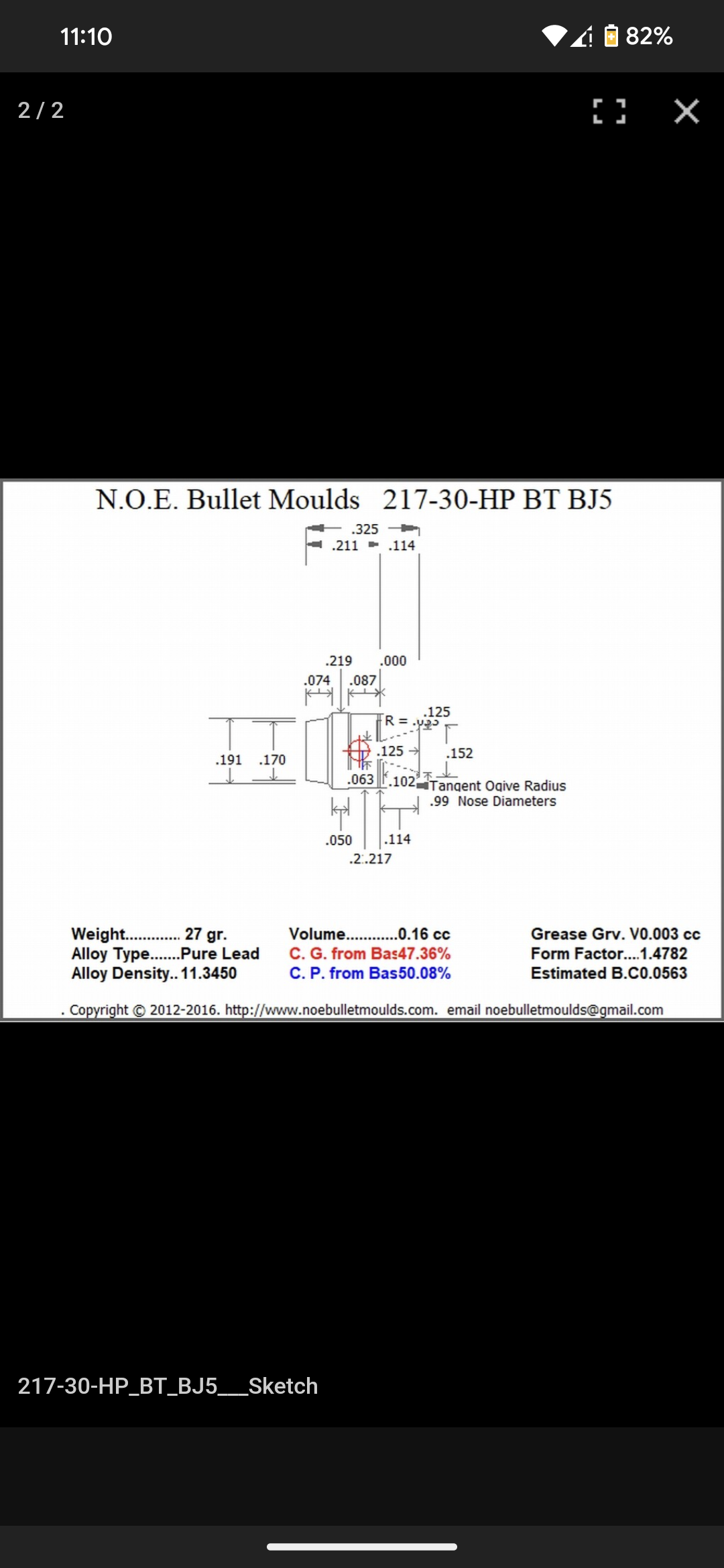

You won't be happy with those slugs in your avenger. It has a very tight .215 groove diameter and the 30 grain BBT can't be sized down that far. The 25 grain slugs work much better after being sized down to .215.
https://noebulletmolds.com/site/shop/bullet-moulds/224/218-25-rf-d6/218-25-rf-d6-rg2-2-cavity/
I have a liberty which uses the same barrel as the Aspen, freedom, and avenger. Not sure about the X but I have a suspicion that it's the same barrel also. My liberty did real well with the 25 grain slug.
