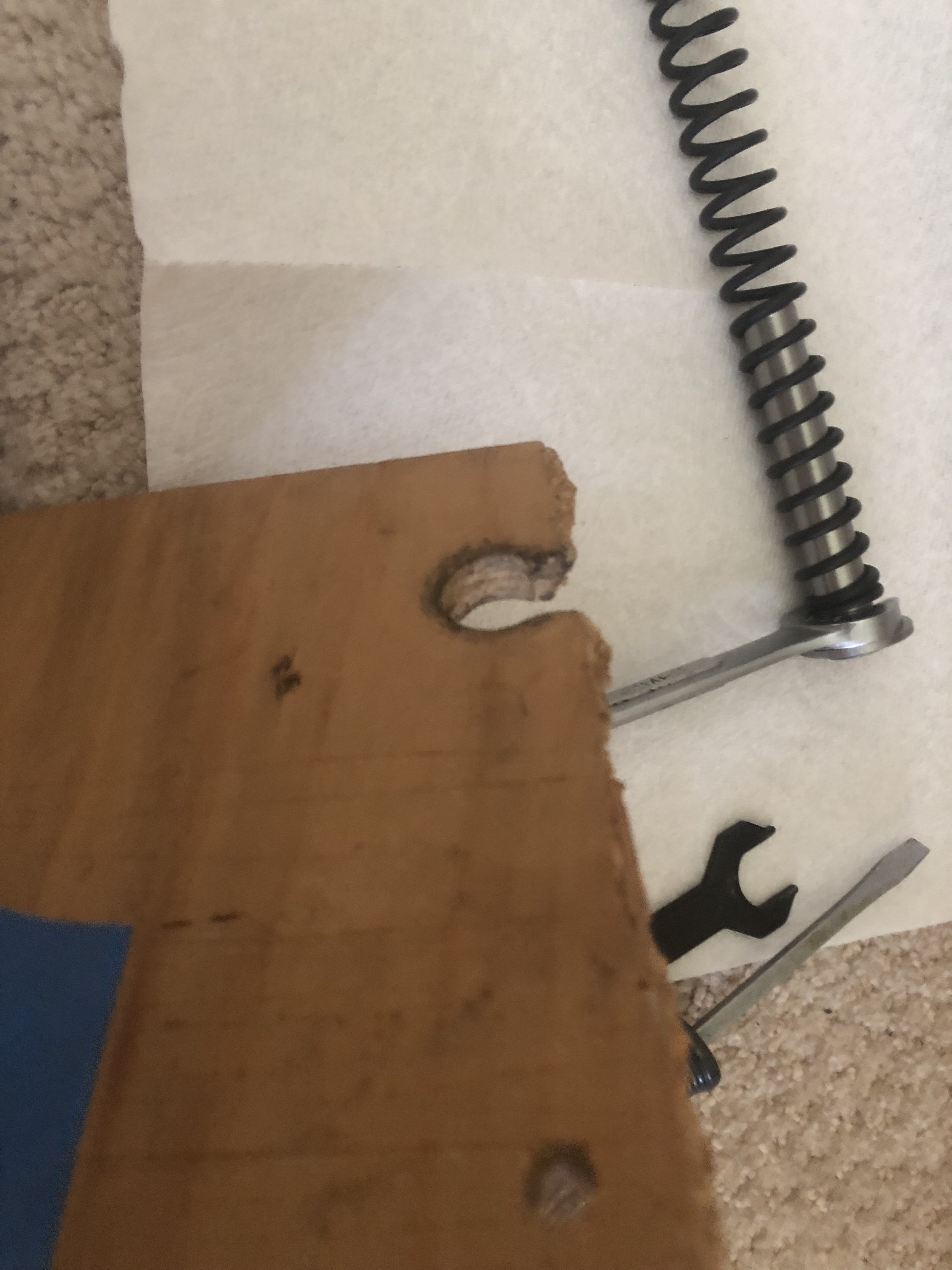

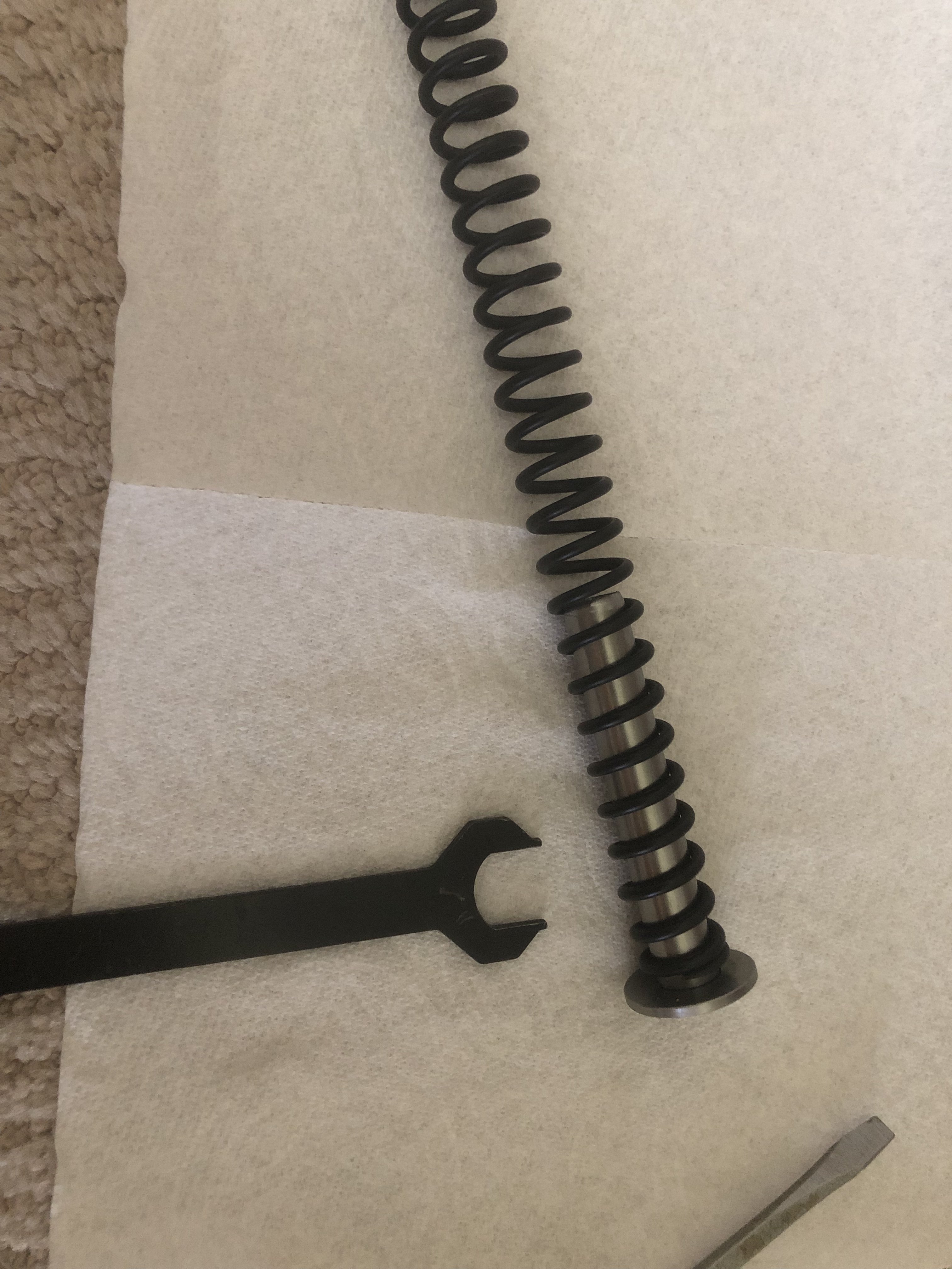

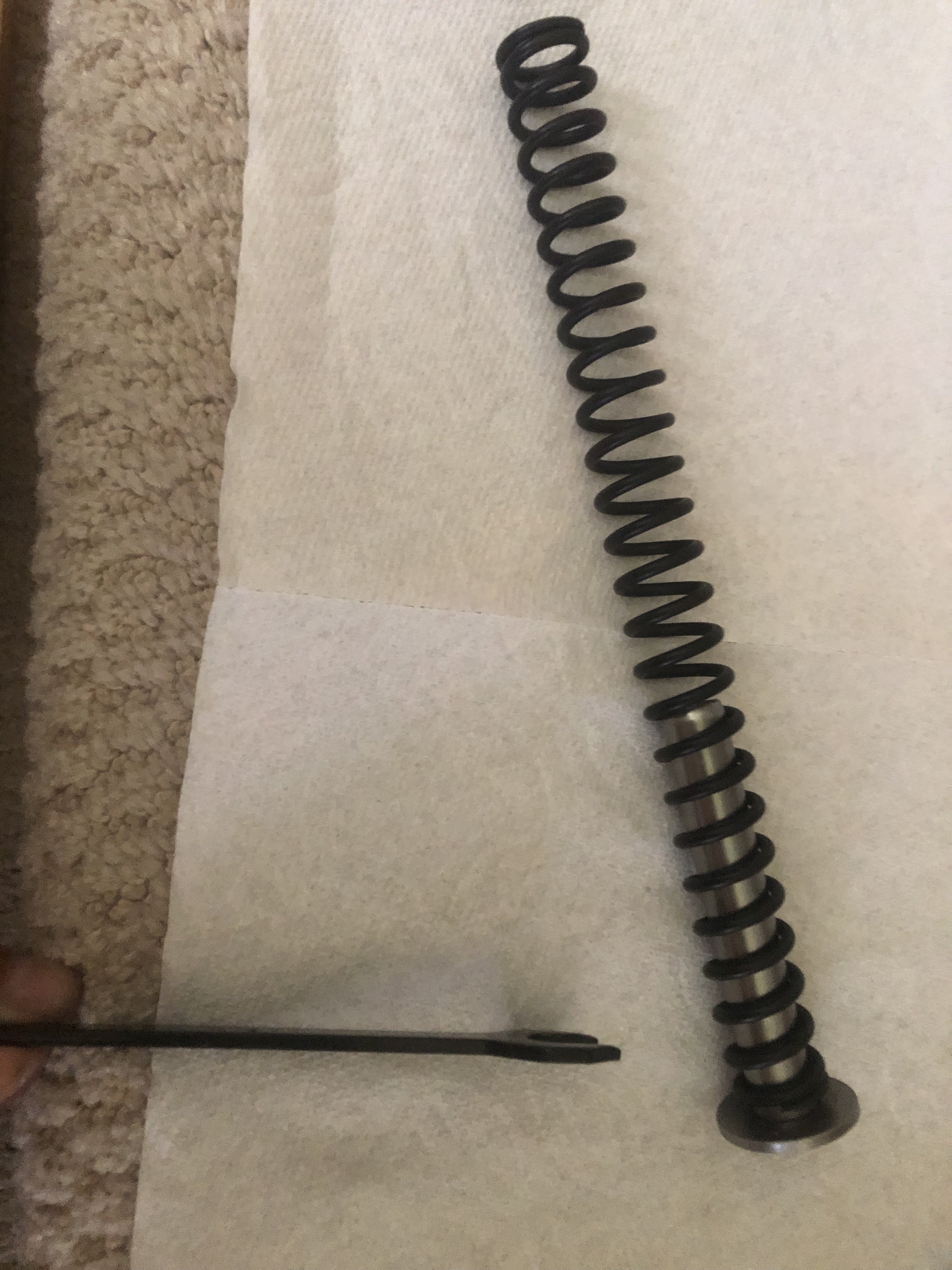

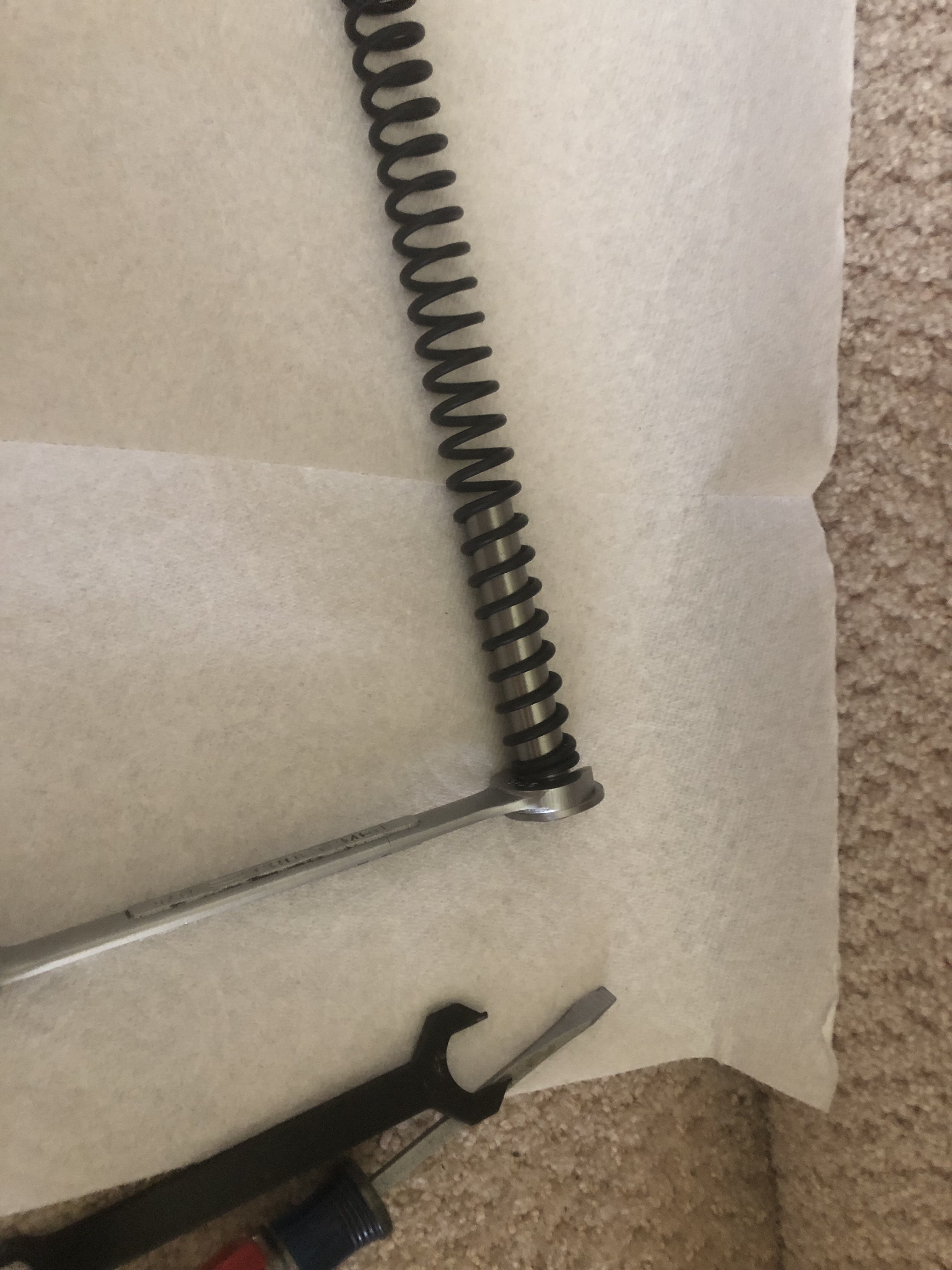

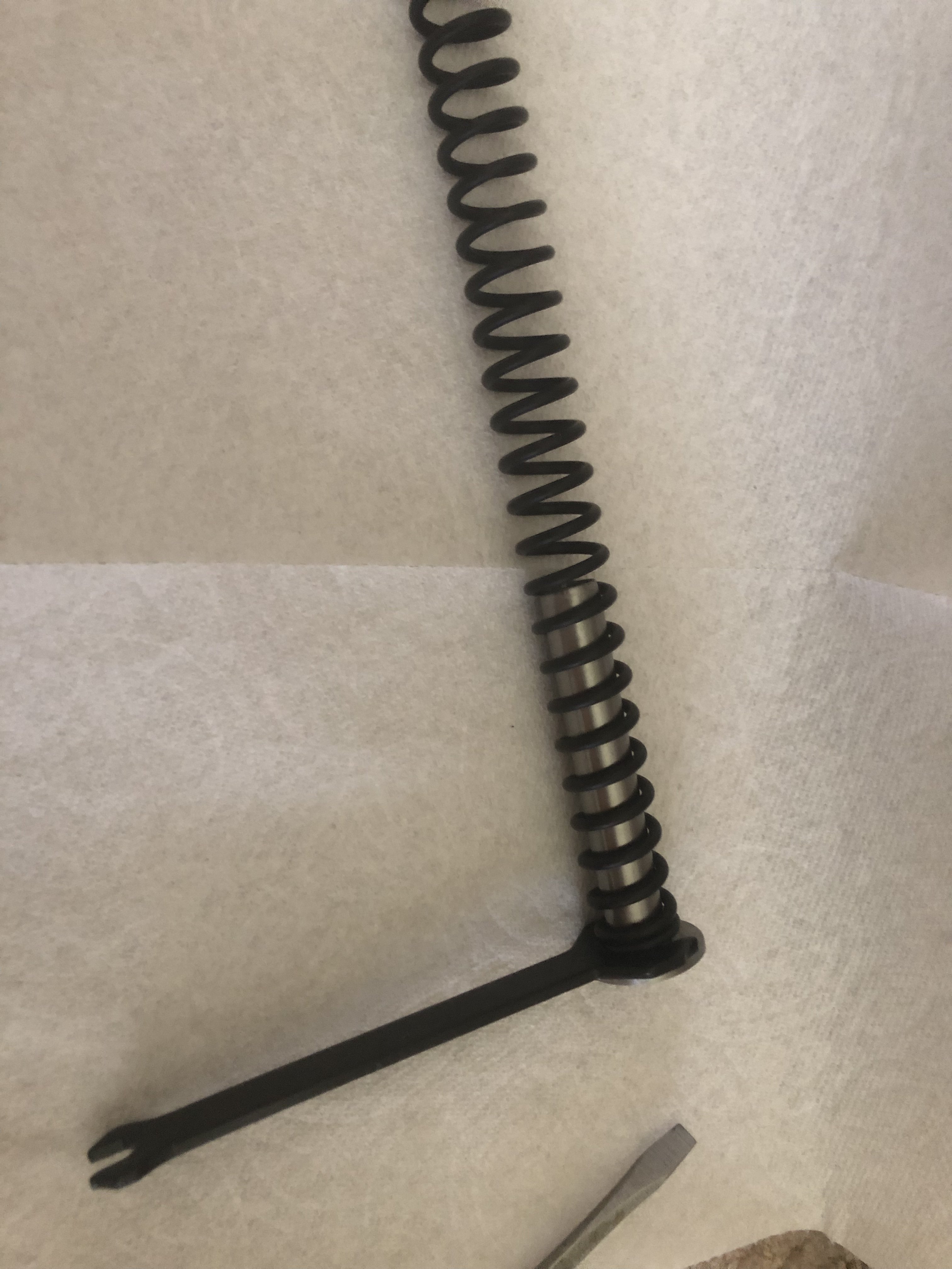

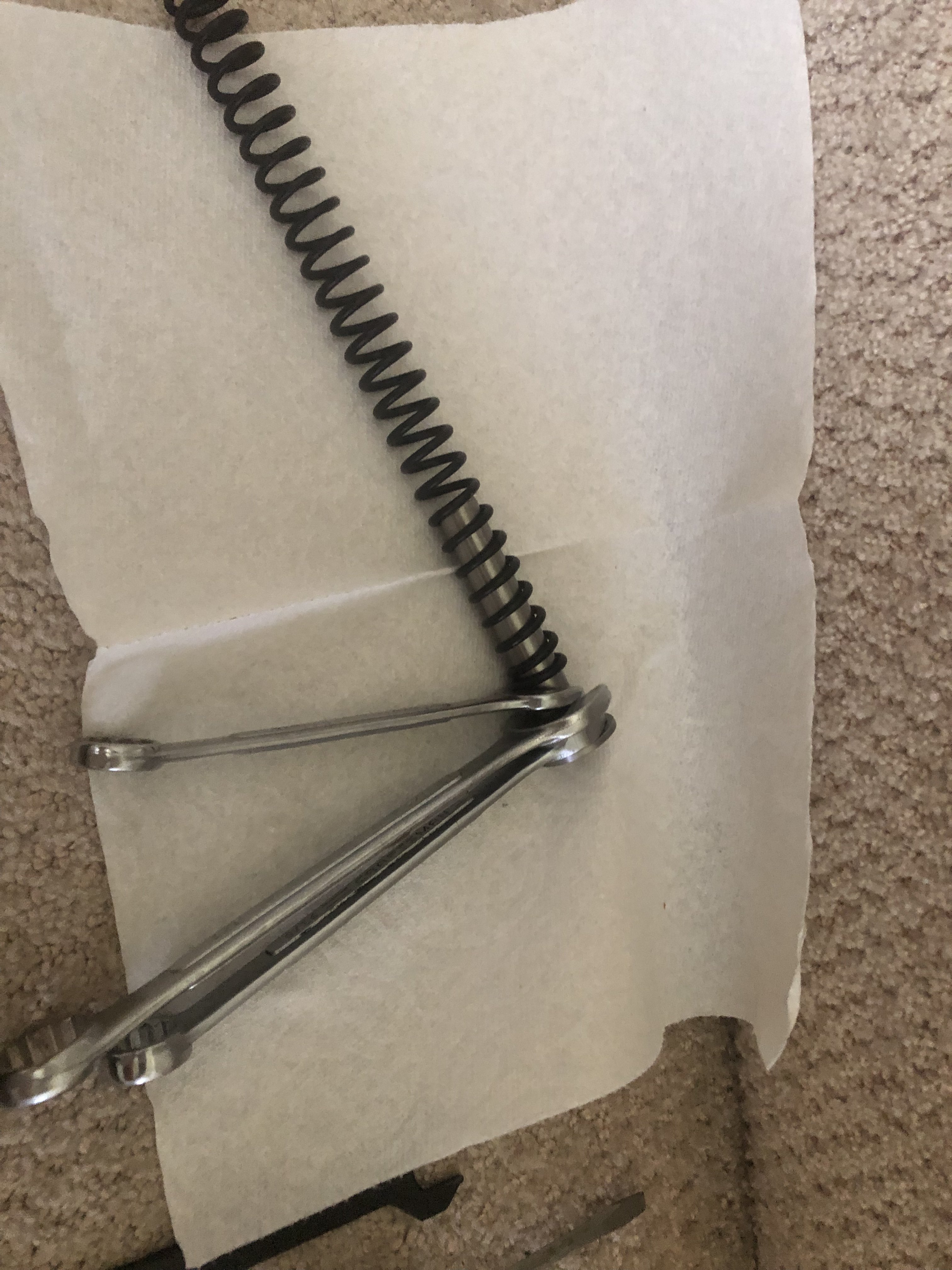

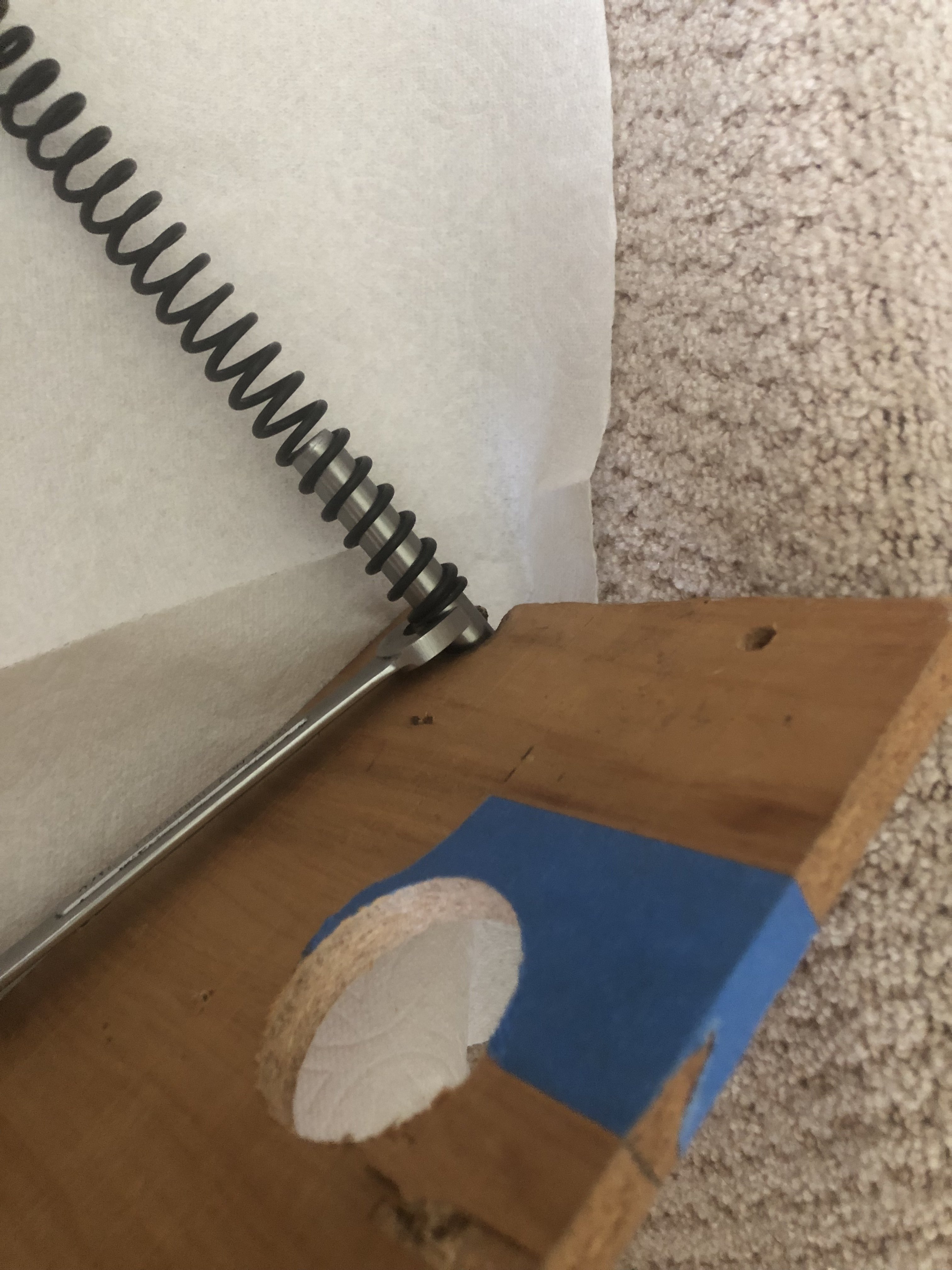

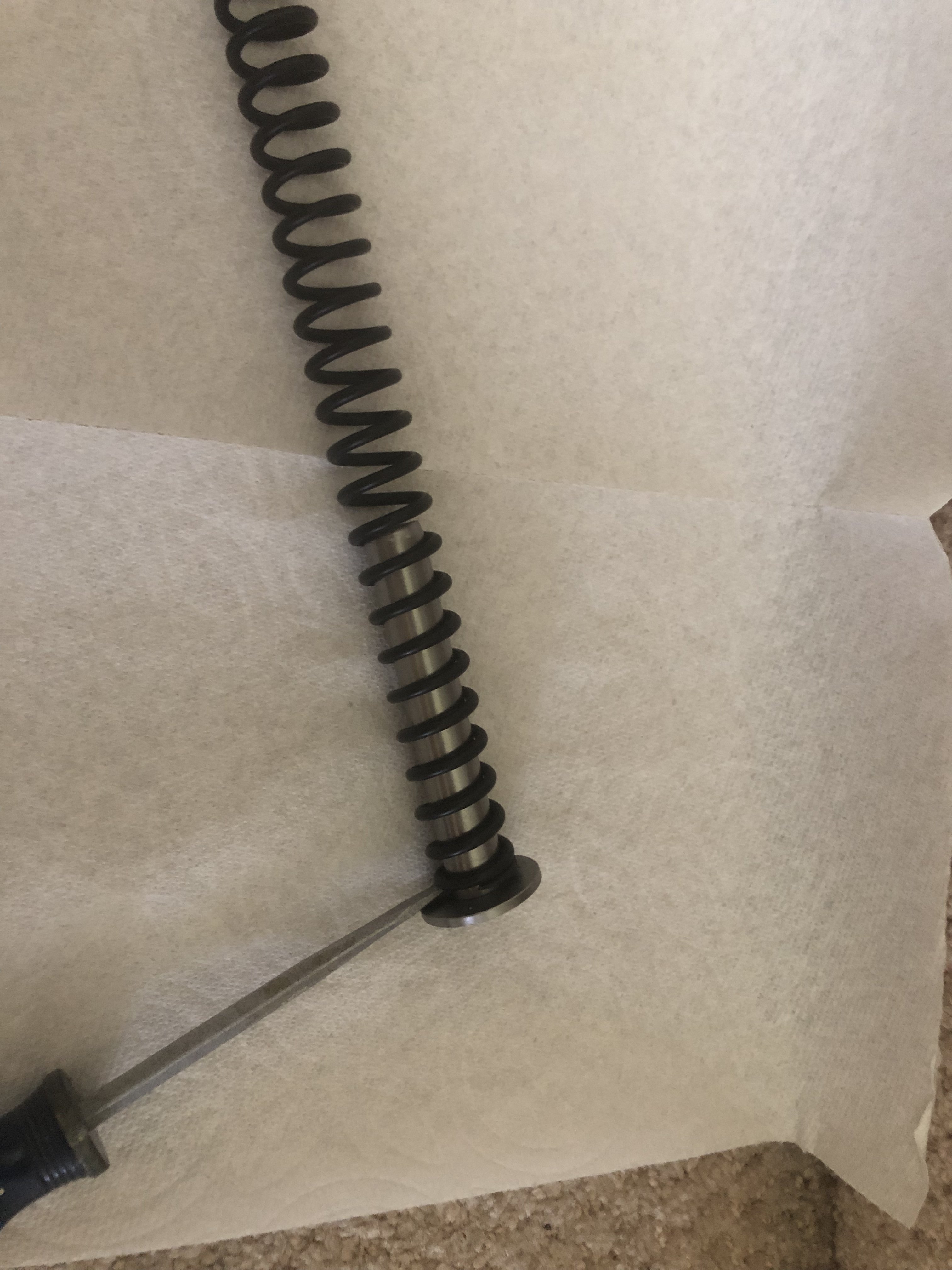

Thank you Frank. You inspired me to take some pictures. This is a simulation. This spring isn't really tight against the guide. Apologies ...Scott, had to find another way to compress the spring.
1. use a strong thin blade flat head screw driver to wedge between last coil and the bottom of the spring guide. Try to gingerly pry/lever the spring out.
2. I was fortunate enough to find a very thin blade wrench that I can use once the screw driver creates enough of a gap. This gives me a safer way to lever the spring out.
3. Then use a progressively thicker wrench to lever the spring out.
4. If you have multiple wrenches, you can stack them together to lever the spring.
5. If you don't have multiple wrenches, you can cut a hole near the end of a piece of wood, cut a u shape. Then use the wood and wrench to help you lever out the spring. (cut this u shape in wood of varying thickness, you can stack them together to help you lever the spring out)
