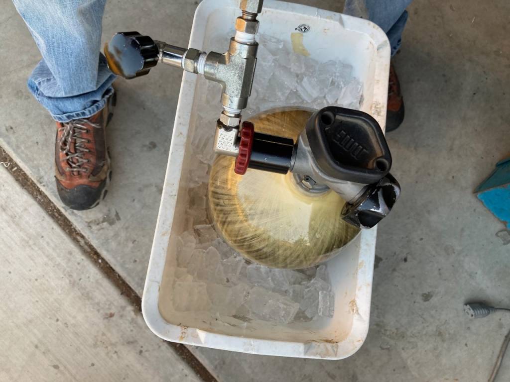

How to push your CF tank pressure to 4500 psi w/o pushing your compressor to it

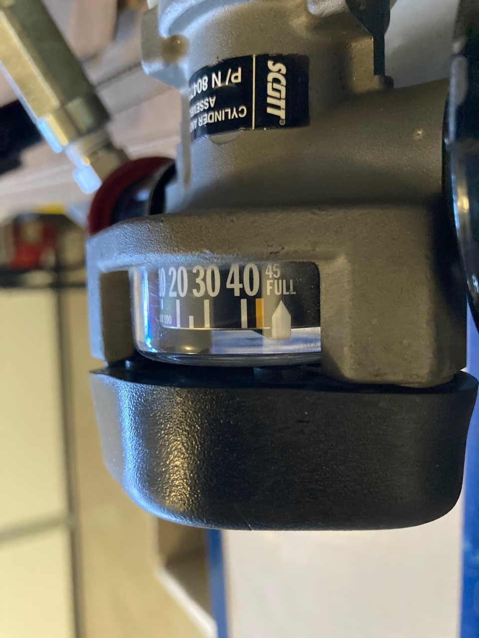

I never professed to "invent" anything. I'm simply sharing a technique to get more air into the tank thank without pushing your pump beyond it's capacity (or people's comfort level). That's all. I realize it's basic physics. But most of the guys on here feel totally comfortable putting 4500 psi in their CF tanks. But not all of those guys feel comfortable pushing their compressors to that level. So they settle for a lower pressure and miss out on the extra shot count and refills on their air rifle bottles. I provided them a technique to achieve a 4500 psi fill by pushing their pump to 4100 or 4200 psi (which seems to be the sweet spot for their comfort level).

It's been a while since I posted this thread- but I still stand by what I said. The temperature of the water will have zero impact on the durability and integrity of the CF bottle. It's impossible for the water to get below 30 degrees F (that's if you decided to use salt water), and many of you guys live in areas of the country where you're shooting and filling in temperatures below that during the winter time.

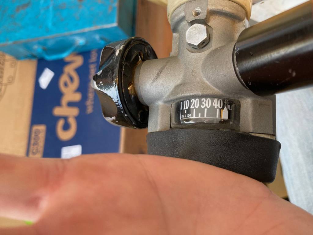

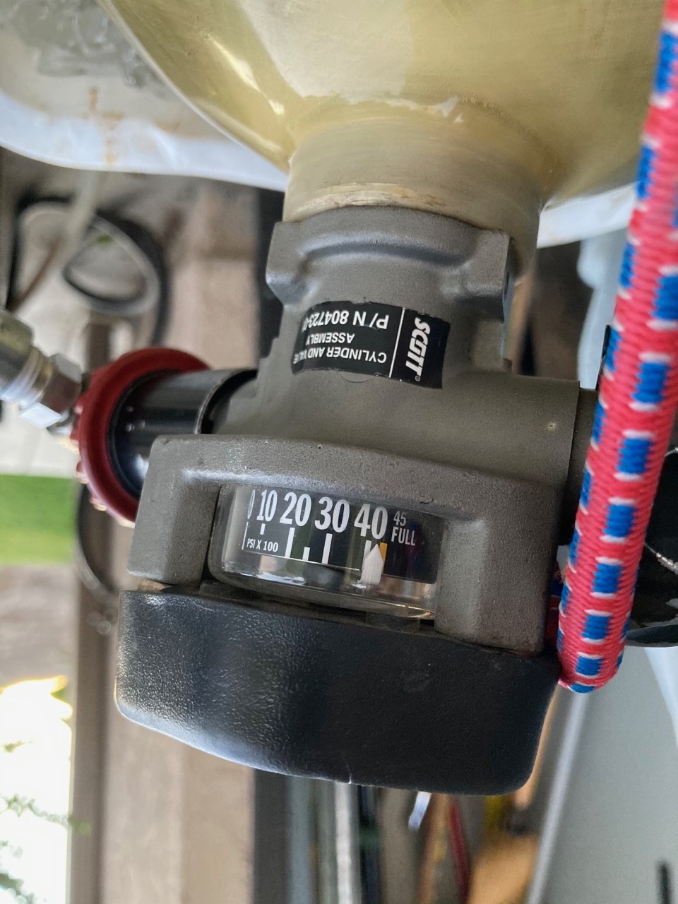

If you're afraid that your bottle will rupture, think again. Those bottles are hydro-tested at over 7000 psi. So going to 5000 is nothing for them. However, if this still gives you the heebie-geebies, then fill your bottle to 4200 psi in the normal ambient air temperature. Give the bottle 30 minutes to settle in, and throw it into the ice bath or the freezer. Give it 30-45 minutes in the cooler environment. The pressure will drop from 4200 psi to about 3750 psi. Then while the bottle is still in the ice bath or in the freezer, fill it back up to 4200 psi. When you hit 4200 psi, close the valves and pull it out. Over the course of the next 30 minutes, as the air in the bottle equalizes with the ambient temperature of the air outside, you will see the pressure climb to 4500-4600 psi. That equates to 4 or 5 extra top off's.
