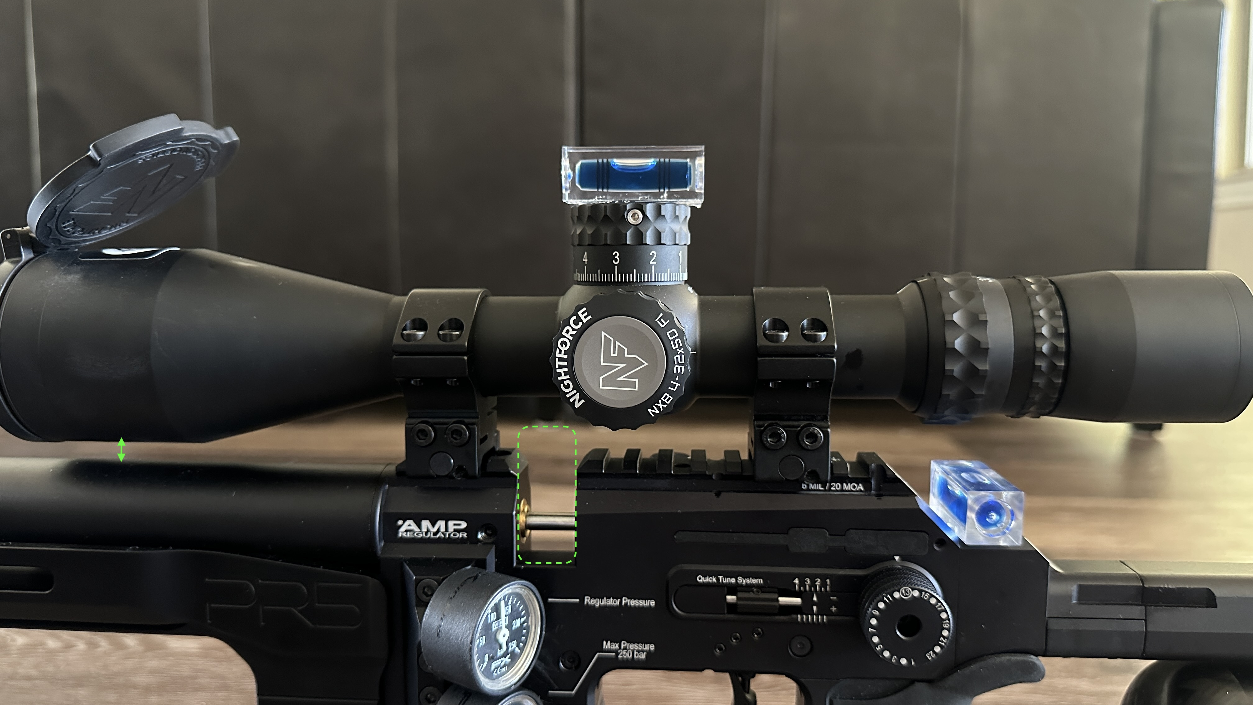

There are several ways to mount and level a scope. Some are more complex than others. The most common method is to level the action, and then level the vertical reticle of the scope with a plumb bob.

One or more levels

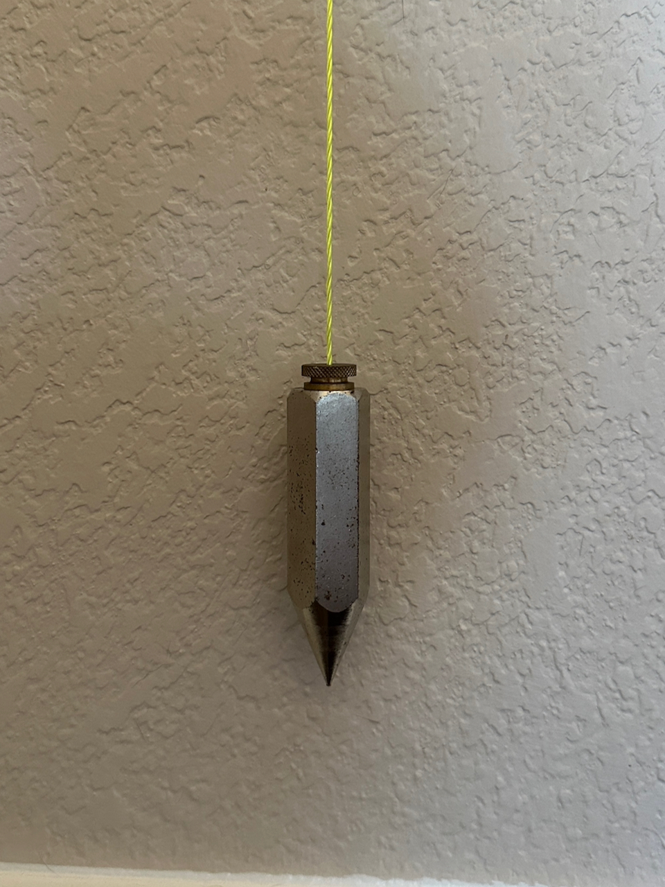

A plumb bob or line marked on a wall using a level

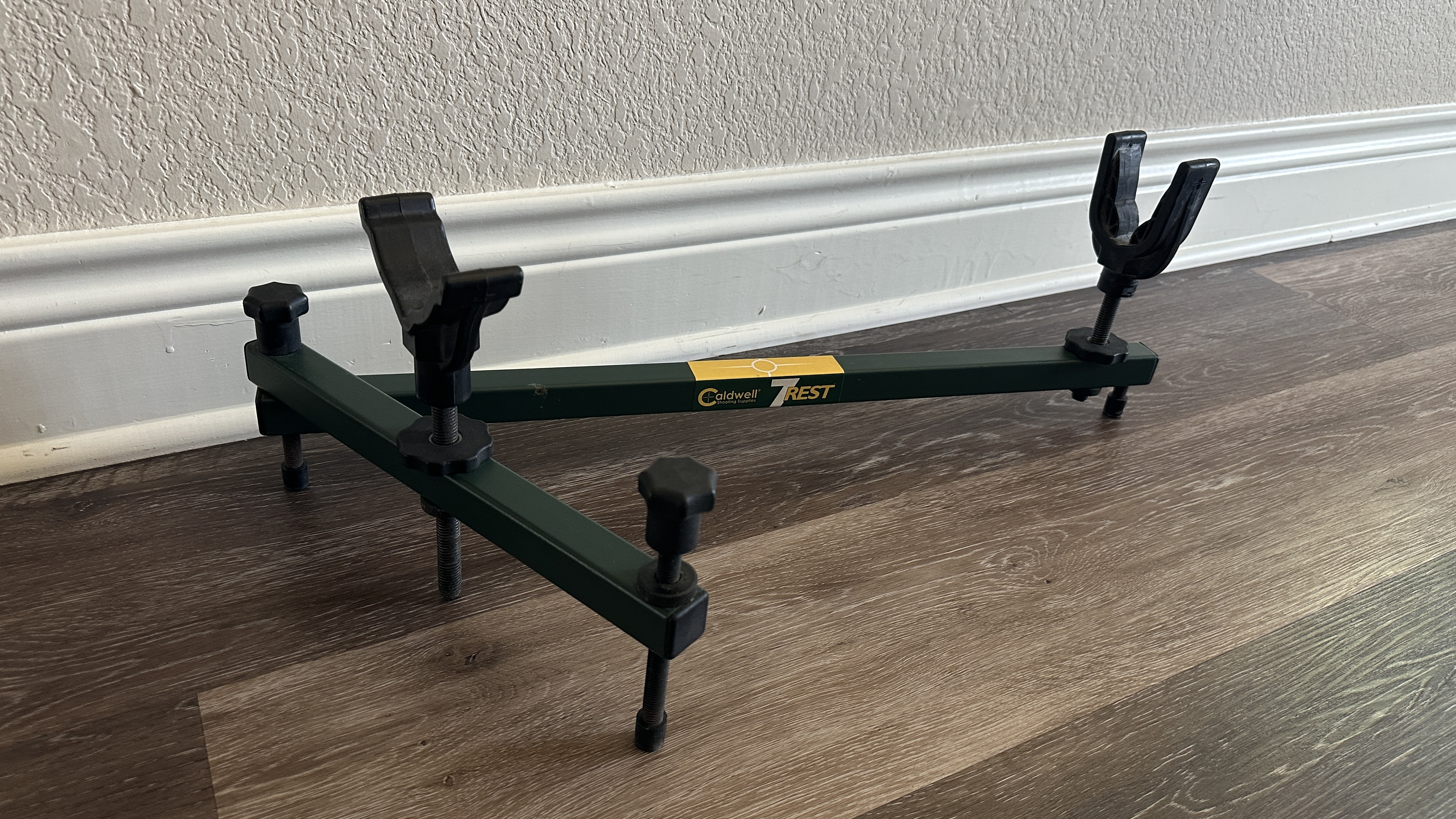

A bipod or some sort of gun rest to hold the airgun firmly in place

2. Secure your airgun in the rest or connect the bipod.

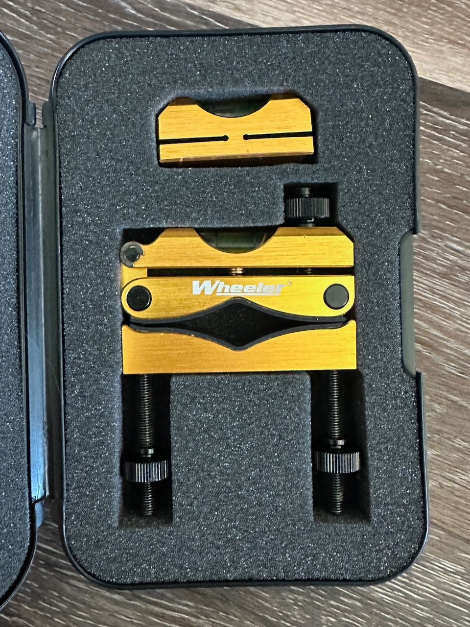

3. If you are using a Wheeler (or similar) leveling kit that connects to the barrel; mount it now as it will be easier now than after the scope is mounted.

10. Hang the plumb bob.
11. Secure the airgun in the rest (or bipod) and point the airgun in the direction of the plumb bob.
12. Use the level(s) to level the action.
13. Rotate the scope within the rings until the vertical reticle lines up with the string of the plumb bob. This is easiest to do indoors without any wind ;)
14. Tighten the rings onto the scope in an X pattern. First snug, then recheck the alignment with the plumb bob, then tighten all the way. *Always tighten the mounts according to the manufacturers specs. Over-tightening can damage the scope and affect how the scope internals operate.
