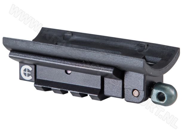

there are adapters to add a pic rail to the sling stud if you have one, which allows for mounting a bipod or light.
ideally you want to have the light as far forward as possible so it isn't shining on the rifle more than necessary.
here is one kind...
