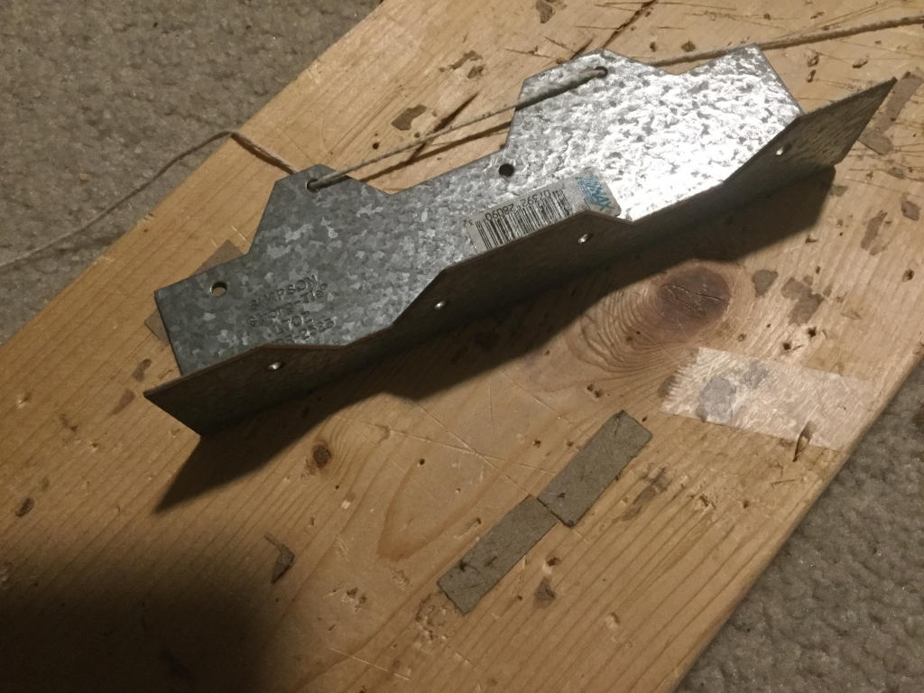

1575418585_16318723475de6fad93f9ac7.40963996_360FA046-E9B5-4717-B2AD-99528B57F96E.jpeg
Once you have gathered the materials, take the string and run it through the holes of the brace.
1575418691_18446770285de6fb439be2c8.34737375_C9D6CC98-01BD-4A7F-9F98-A77122B18E1B.jpeg
Next, tie the end piece of the string around the arrow above the fletching and secure it with a knot and tape. Do this on both arrows and with both string end pieces.
Finally, anchor both arrows into the ground so that the arrows are bending inward just a little bit. Now you have a small gong target for your air guns!
