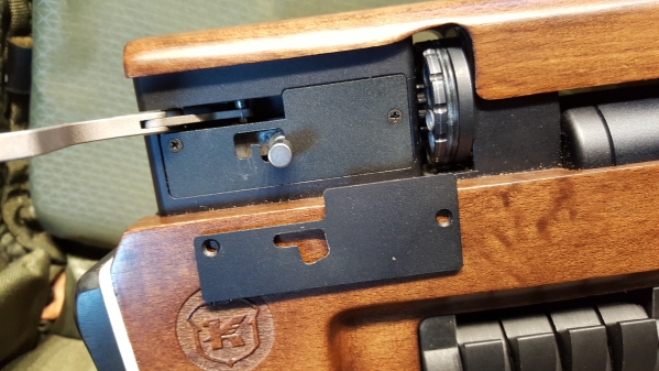

The Donnie FL aftermarket side plate is a big improvement over the original. Here's the Donnie FL installed, the original plate is lying on the stock.
BTW it's just two screws out and two screws in to install.

I did come across a You tube video of how to modify the side plate by cutting a small grove to hold the toggle back while loading the mag essentially what the Donnyfl side plate is doing. I did that. It's a of some benefit but not necessary once you understand how the mechanism works.

I thought about the Donny plate, but it's not like it's some crazy big deal to load the gun. You can do it one-handed if you point the barrel up to the sky...at least I can. And, I didn't want a larger hole to be a potential place more dirt could enter the inner workings. I need to check my OEM plate when I get home, as I didn't think mine had as much space as the one above that Mr. Tubeman posted. Anyhoo, love me some Cricket .25 @ 50+ fpe unmolested!
