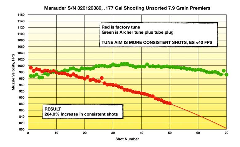

With a flatter shot curve, I was able to give the gun a more aggressive tune, ending-up with more power, more shots, or both. Then a ton of testing with unregulated Marauders in all three calibers proved that it works every time with no less than 12 combinations of gun and pellets. But a little different with every individual gun/pellet combination. Here's some examples...

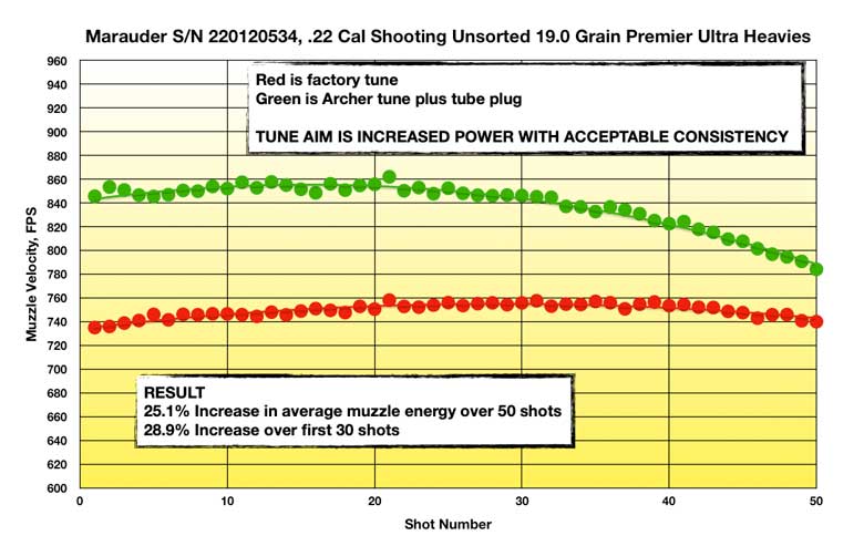

In .177 cal, the result was double the number of consistent shots - in fact more, as you can see above. The next graph shows that much increased FPS (and power) was achieved in .22 caliber - over a 25% increase in FPS over 30 shots.

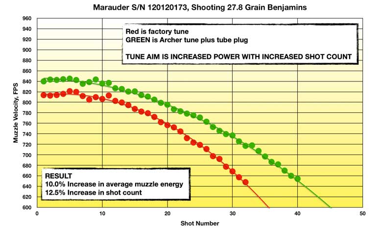

Even the .25 cal Marauder gained up to 10% in power and shot count - as well as eliminating that pesky air puff in the face. And in no case is it necessary to make any change to the gun which could invalidate the factory warranty or requires dismantling the gun - beyond removing the stock, that is.
