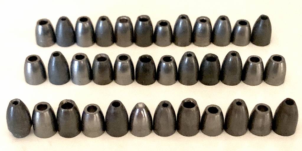

Get some griffin slugs. Get some that are on the shorter/lighter side. Get a superior liner, and a carbon fiber tube to bond to the liner from Earnest Rowes custom shop.
The superior (not heavy) does well with lighter weight/higher speeds. The carbon tube makes the barrel less tune sensative. More accurate overall.
If you're only shooting 75 yards and closer, you may have success with some of the lighter .25 slugs. From my experience testing, an unmodified Crown MK1 with hammer spring maxed out and regulator set to match(140 to 150 bar) just barely has enough power to accurately shoot the lightest of .25 slugs out to 75 yards. Beyond that the group sizes really open up.
The .25 King Heavy MK2, however, can be accurate out to 100 yards shooting as low as 790fps(they won't buck the wind as well as shooting them at higher fps and have a loopier trajectory, tho).
You would have MANY more options options and the ability to shoot good groups out to 125 yards, if you bought at .22 caliber change kit with 600mm Superior barrel. As jps2486 stated above, many Crown owners are having success shooting .217 JSB KO slugs(as well as NSA, H&N, Griffin, etc.) out of 600mm Superior or Super Heavy liners.

The slug A liner is super accurate with the 700mm and the new NSA 34.9gr slugs at about 945fps. My son shoots the 700mm Superior(standard) liner with the Hybrids at about 930fps with great success too.

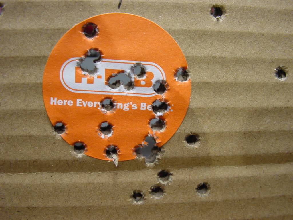

Before and after choke removal.
 At only 50 yards. Now after the work at 80 yards, 1 shot to settle the Reg. and 10 on target.
 How about 60 shots at 80 yards to check for consistency?
This is what happens when you remove the choke, and a bonus is far less leading!

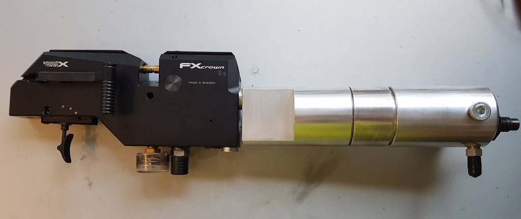

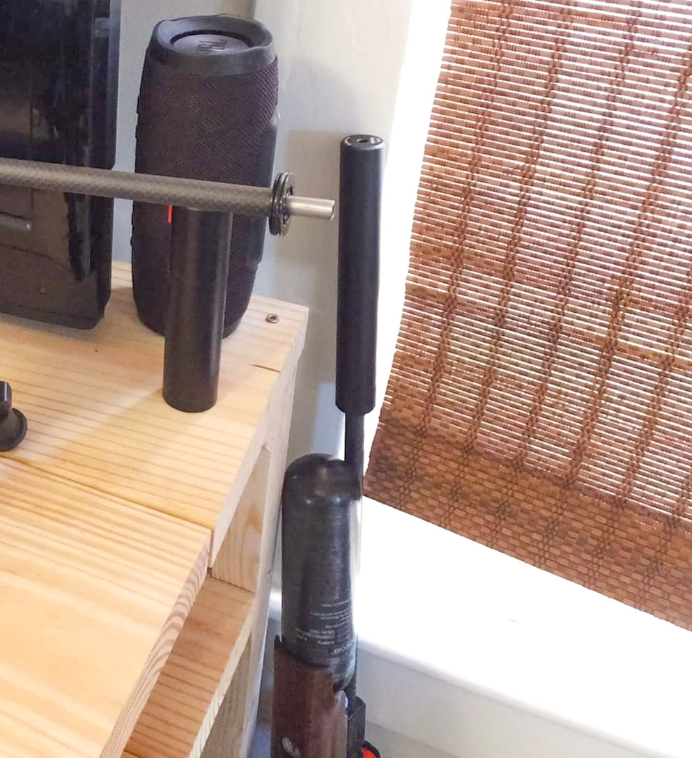

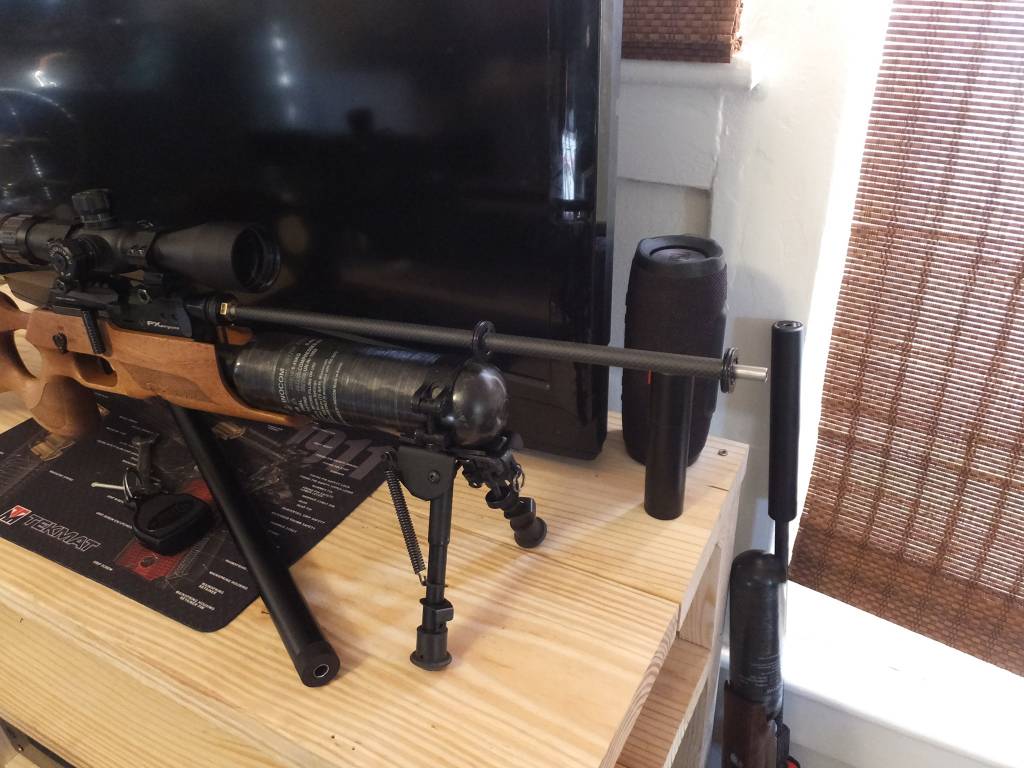

Giving me more ideas to get carried away with (speaking of tensioned bonded liner). 😅 I've got an idea of how to make that work well, but I do not have that kind of configuration currently. I just have mine floating like a standard superlight setup, but with two long sections of CF tube epoxied at full length, at full surface area to the liner. Used acetone prior, so should have a great bond.
The center support is sandwiched, and is there for life. Until it gives out some day. Bur I recon I can 3d print something that will work just as well if I ever need to that would fit onto the CF tube instead.
I've noticed the choke is lighter, and the projectiles that come out of this 500mm superior are SUPER smooth. I thought the STX liner pushed out smooth projectiles 😏
Yes, I believe I have a 6.3mm seat, as well as a 6.5mm. I was going to throw the 6.5 in when I got my .30 barrel, but the USPS misplaced the barrel for me. No telling when or if I will order another. I've been shooting heavy .177s pretty fast lately, and have been REALLY enjoying it.
I have some larger valve seals, but I had not quite ironed out how to get them to stay put. Once you loosen the collar on the valve stem that holds the seal on, it does not like to stay put anymore. Like I'd need a small choking device to really squeeze the collar back onto the pin. Hmmmm That might be pretty simple to make happen.... just need a split piece of stock with the right size bore. And a press. But at 2000psi, will it still stay put? I'd really like to see a new mkii valve pin.... I'm willing to bet it is a direct drop in, and will probably order one if I get my .30 barrel.

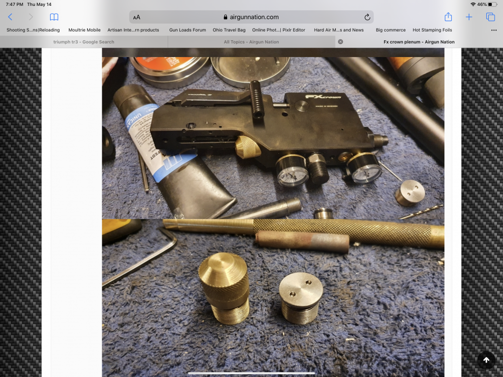

One of my friends has been talking to me about a plenum he is getting that is adjustable in volume. My main issue is that it would only really be useful for shooting from a stationary bench or perch. (which is what he does mostly) Going to REALLY put the bottle out there. But is a solid design to make the gun a REAL powerhouse.
I don't feel the plenum is needed. Though would be useful for sure. I had contemplated getting one made that would come down a little into the trigger guard (there is a bore cap in front of the trigger under there). But would only net about 3cc tops, I believe.
Of course you can install a drop plenum off of the rear gauge port, as well. Similar to some of the first aftermarket plenums for impacts.
I never did care much for the valve adjuster either.... but is a cool feature if you want to REALLY fine tune the gun. I actually have something quite similar on my 1322 pcp, and it's pretty darn handy. But is one more factor that can go askew. Another thing that has a similar effect that I may look into is a peek striker installed in the hammer. Seems to dampen, and create a more consistent valve actuation.
I used to have a VERY tight ES on my crown, but I messed with my reg. too much. I'll likely try and polish it up, clean it out.... I also have spare parts to rebuild if I decide. (it's a huma, but I developed the same issue with the amp from adjusting back and forth too much.) There was also an issue of rough edges on the hammer spring grinding shavings into the trigger/hammer tube. Presumably from the guide. Not sure if my gun ever %100 recovered from that, but will likely look closer and polish there as well.
