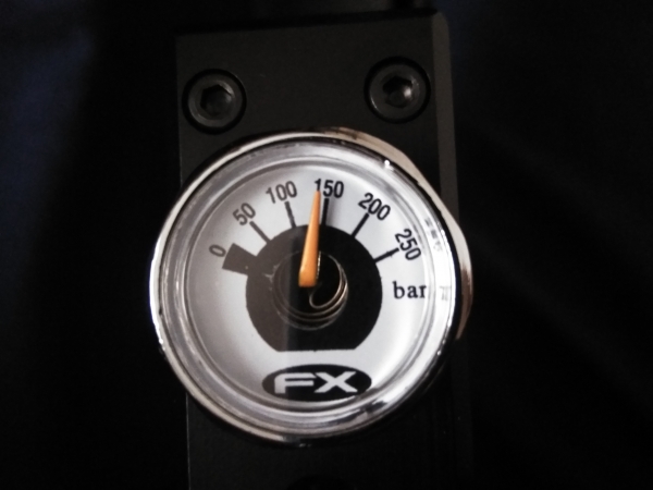

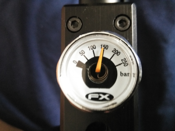

I've seen posts about impact and crown reg creeping overnight. But they don't mention how to fix it. Most just send their guns in. I bought my impact from airgun Depot a month ago. When I got it, it creep overnight. But I read on forums here that some say new reg will creep till it break in. Have it for a month now, shot about 500-600 pellets through it. It still creep overnight. Not by much but is noticable and does effect the fps. My gun is tune to shoot 33.95gr at 850 average. When let it sit overnight, it will shoot 820, then 830 then back to the 850s. So Everytime I let the gun sit overnight, I have to dry fire 1+2 shots to get reg back to normal. Anyone know a fix to stop this? It's a $2000 gun, shouldn't have this problem imo. I have a huma reg on my Marauder that holds reg pressure just fine for over a month and doesnt creep.

It is worth noting that moving your rifle from a low temperature area to a higher temperature area will cause a noticeable increase in plenum pressure. This is not creep, or a defect with the reg, but just the nature of gas expansion with temperature. So if you're shooting out in the cold and then you go inside, you should see an increase in your plenum pressure. If you didn't, it'd mean you have a leak somewhere in your rifle.
Hope that helps. :)
Creep is caused by air weeping through microscopic imperfections in the regulator’s valve seat. The only reliable way I have found to remedy a creeping regulator is to dress the two sides of the valve seat.
One side is usually hard plastic (e.g. Delrin) and the other is usually metal (typ. brass or stainless steel). They need to be dead flat, parallel to each other, and polished free of any scratches. If all it needs is polishing, I’ve managed with nothing more than a thick piece of glass as a backer for wet/dry sandpaper, and a few careful strokes against 400, 600, 1200, and 2000 grit.
Note some regulators have a replaceable plastic piece and that’s convenient to try if you have the option. Ninja paintball regulators are the most familiar example. There’s a little plastic ball that’s press-fit into the regulator piston. You can pop it out from behind and snap a new one in. So long as the conical seat on the reg body is in good shape, that will usually solve the problem. Like any new reg, it will need to be cycled a bit for the fresh surface to wear in. Not 2000 times though :)
FYI, it remains mysterious to me how reconfiguring the Belleville stack has any bearing on creep. If it works, that’s all that matters but I cannot explain it.

Totally agree with you about the "burn in time" on regulators, it needs time to settle, and because the delrin is softer than the brass nose, it will "iron out" the machining marks during use.
The double stacking of the old Crown regulators had got more to do with the fact that around the 150bar mark, the stock BV washers tend to flatten out, resulting in a "overshoot" of pressure. However, the newer regulators should be fine.
I would rather take 2, 3 dry shots before starting a shooting session than to try fixing it and making it worse. I think it happens in many guns but in cse of an Impact the creep gets noticed due to a reg guage.

Good explanation. The creep and resulting higher reg pressure, cause some slower shots due to there now being more pressure for the hammer strike to overcome as its preset and tuned for a constant reg pressure. Similar to a valve-lock situation but different. You can live with it for now but it will worsen.
I've done the same polish technique for the seat of the piston in the reg which closes the pressure off. I've had good results with this and it is part of what I now do every time I rebuild a regulator.
Just a quick comment about taking a couple of dry fires to start with. That’s a reasonable plan for plinking and target shooting. However it’s a deal breaker for hunting and pest control where you may be waiting an hour or more before taking a shot.
I don’t think it was mentioned in this thread but don’t worry about creep until you’ve adjusted the hammer strike to put the rifle on its velocity knee. That is, dial up the hammer strike until the velocity no longer increases, then back it off to 95 - 97% of that max. When adjusted in this manner, the gun is least sensitive to pressure variation (creep).
It is the same principle that allows an unregulated PCP to produce a narrow extreme spread over a wide pressure range.
