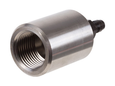

I use this little gem for my LP50...
This is a 300bar DIN to 1/8" bspp....
or this.....
Finally found something.
eBay: https://www.ebay.com/itm/235004585379
aka PCP Filling Station Valve Charging Adapter to 5/8 Adapter 300 bar. $17 with shipping. Plus, looks nice.
I also found "Air Venturi Female DIN Adapter, 1/8" Male BSPP Threads" which would use the quick connect I already have. They fail to describe it as DIN-200, but looks to be. Total is over $40.
Apparently, DIN-200 is equal to 5/8 BSPP. Must be careful to get DIN-200 or DIN-300, depending on your needs. 300 will work in 200, but not the other way around. I was unable to use my short adapter in the regulator inter-connect.
6 names for the same thing, makes searching awful hard!
