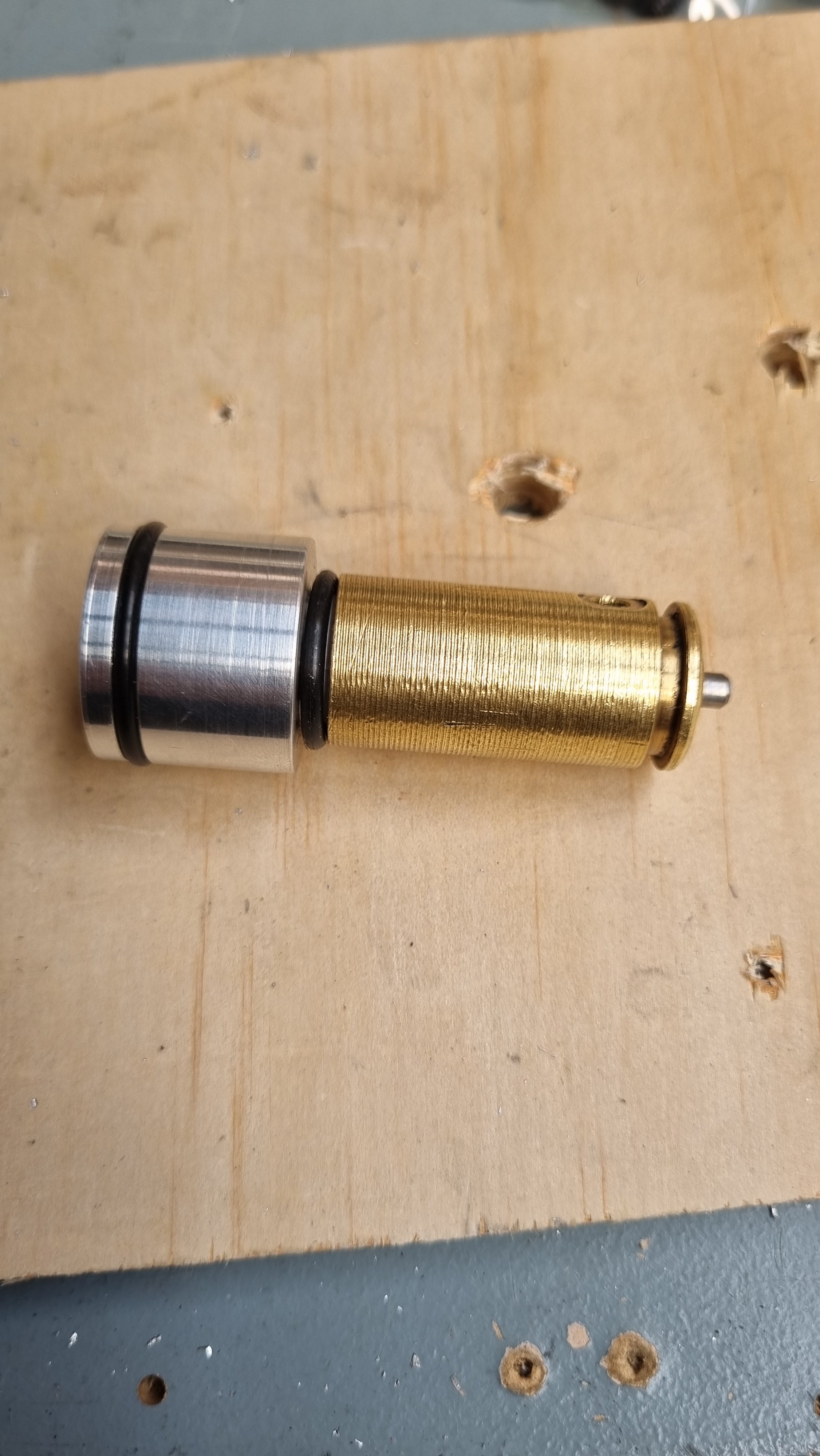

I am building a pcp pistol using the crosman trigger frame. I am a little stuck on the firing valve design as I am wanting a big safety factor for the air pressure. I had wondered about using the crosman valve, but that would leave only the threaded section holding back the tank pressure. I am not going to do that now, but Is that thread strong enough for that? Photo shows my concept. I am using 32 mm alu tube with a 3 mm wall.
