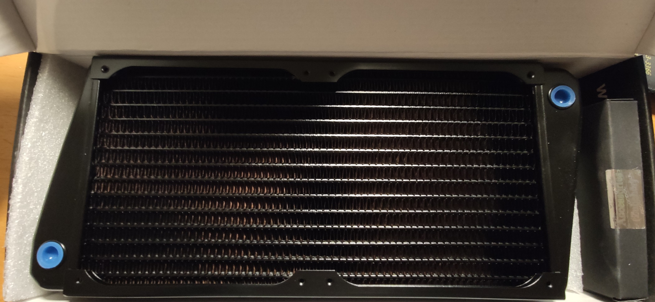

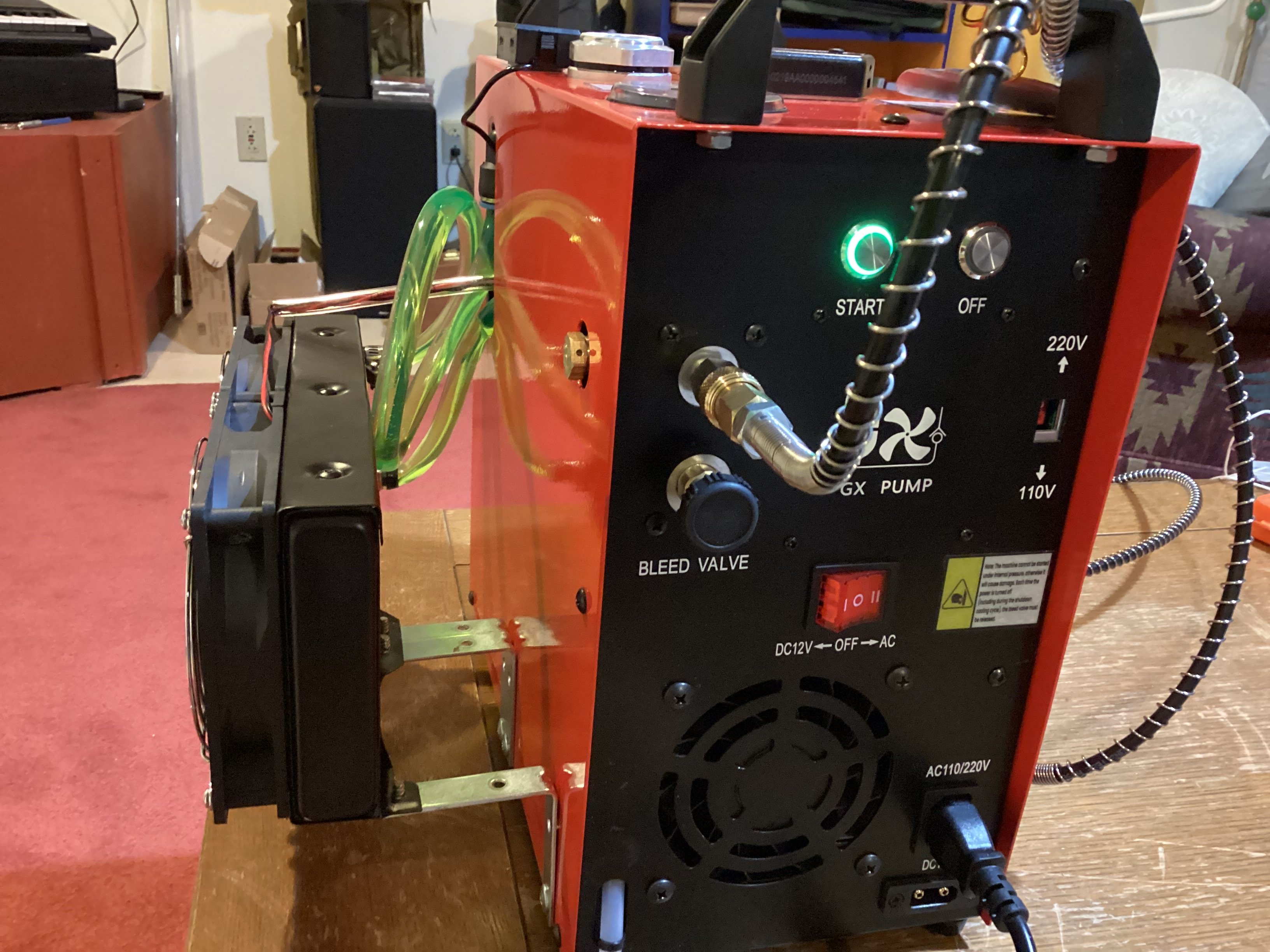

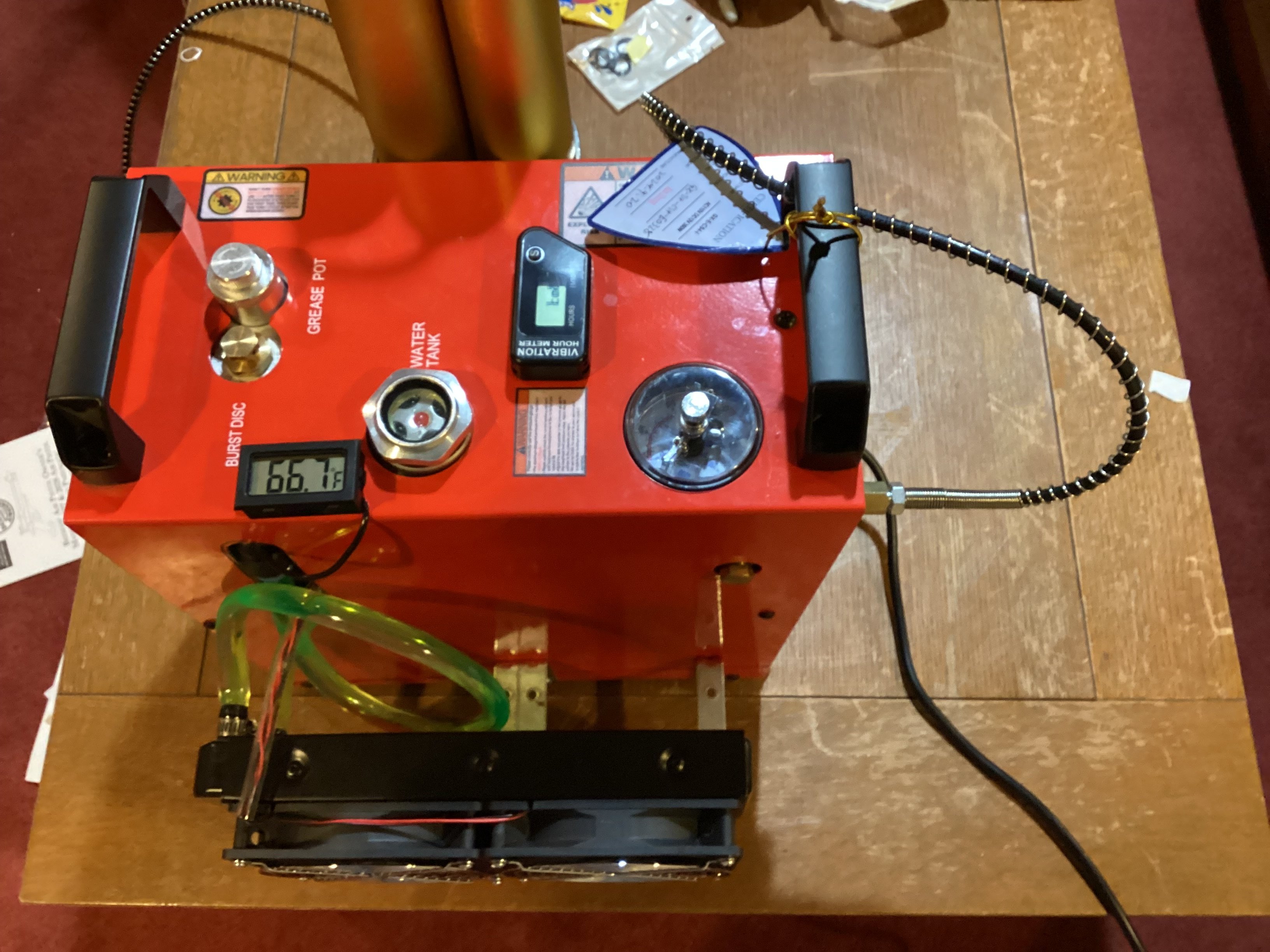

Did you notice any bubbles when you turned in back on?Rotated my radiator a month or so ago. Simply undid the 4 screws, rotated 90°, and reinstalled screws. Didn't unplug any hoses nor drain any water. Took about 5 minutes.
Upvote 0

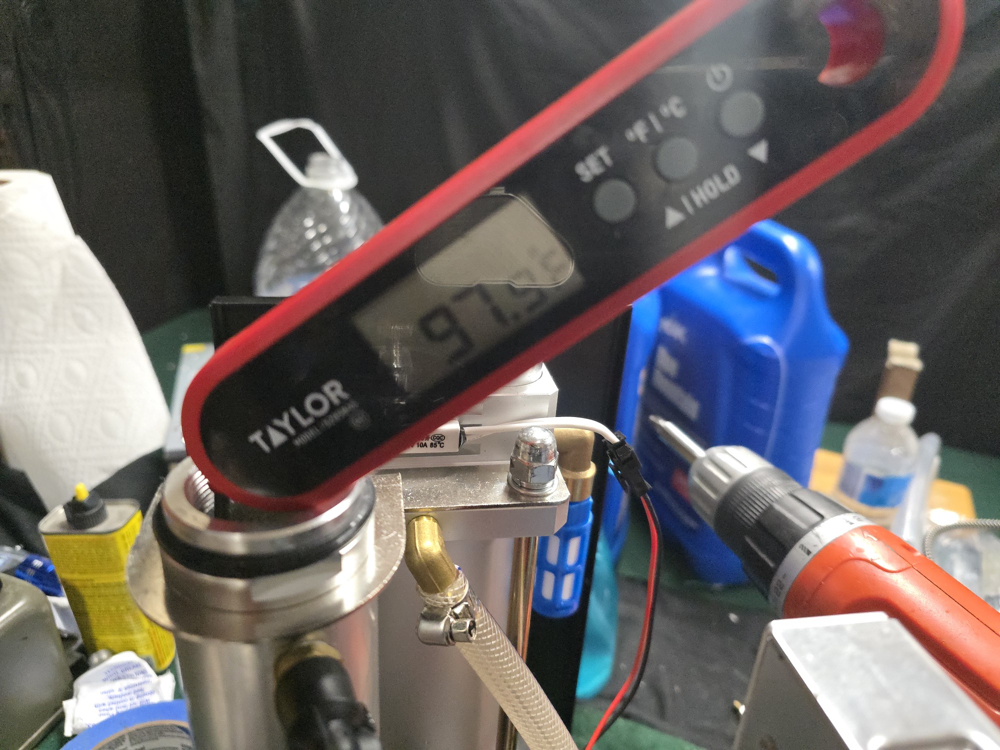

No, but to be fair, when I filled my system back when I first got it, and knowing what I know about these dinky radiators, I picked up the machine and twisted it all about while running to "burp" any air bubbles. I also did not get a temp decrease. Great question though!Did you notice any bubbles when you turned in back on?
Probably those that don't see any difference didn't have any air in the system before they did the mod. Doing the mod ensures air is automatically bleed out. Without the mod you should rotate the compressor a few times to get all the air out every time the coolant is changed or if the inlet to the pump ever sucks air in.don't understand why some are seeing positive results and others not.

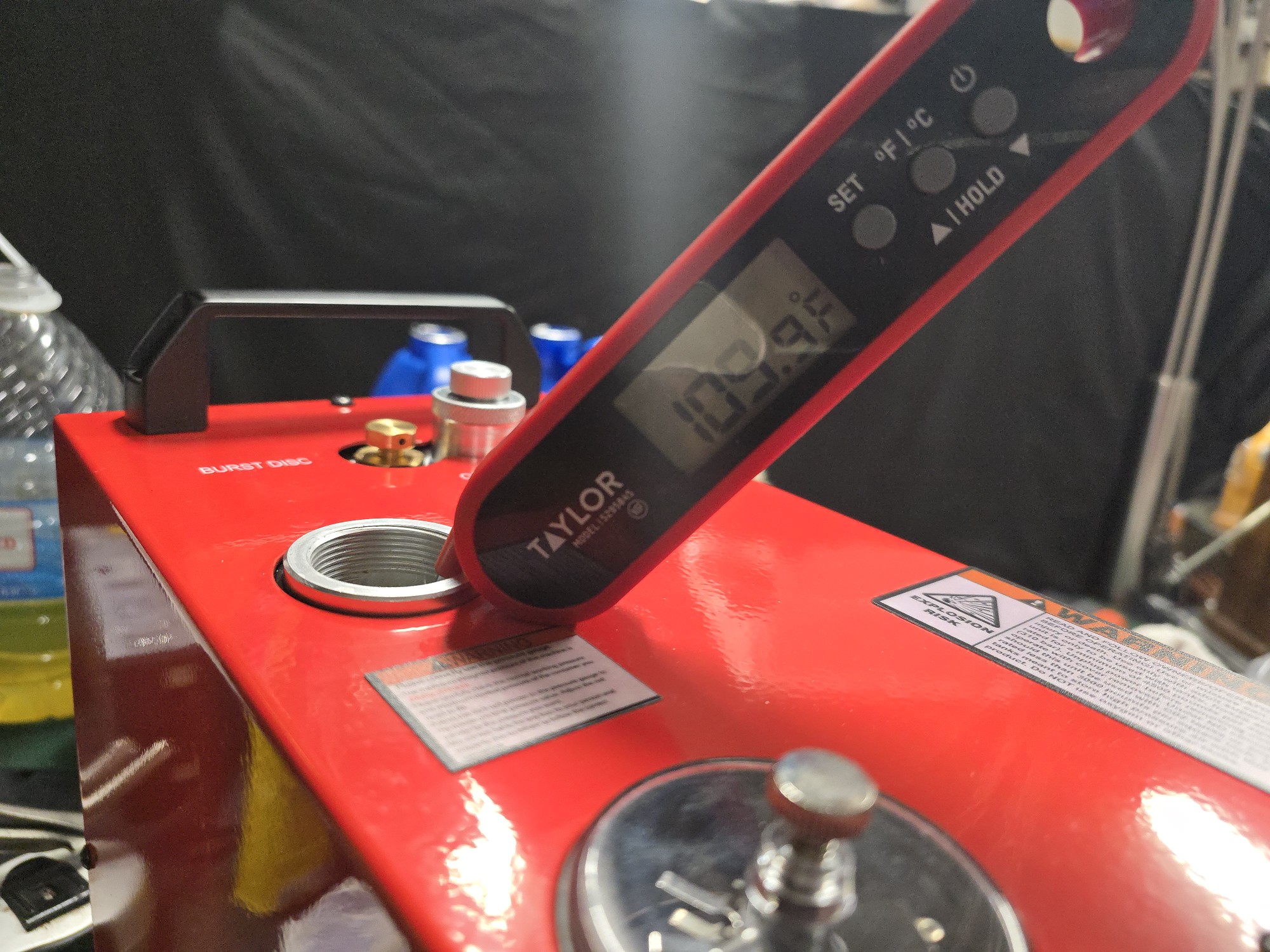

I need to do more testing to be certain, but I think my water temperature went up after the rotate mod. Might have gone up by almost 10 degrees. Like I said though, I need do a few more cycles with it to be certain. Before the mod after one and only one check on a brand new machine I was in the high 90's. After the rotate the water temp was in the 107~108 range, again after only one cycle.don't understand why some are seeing positive results and others not.
