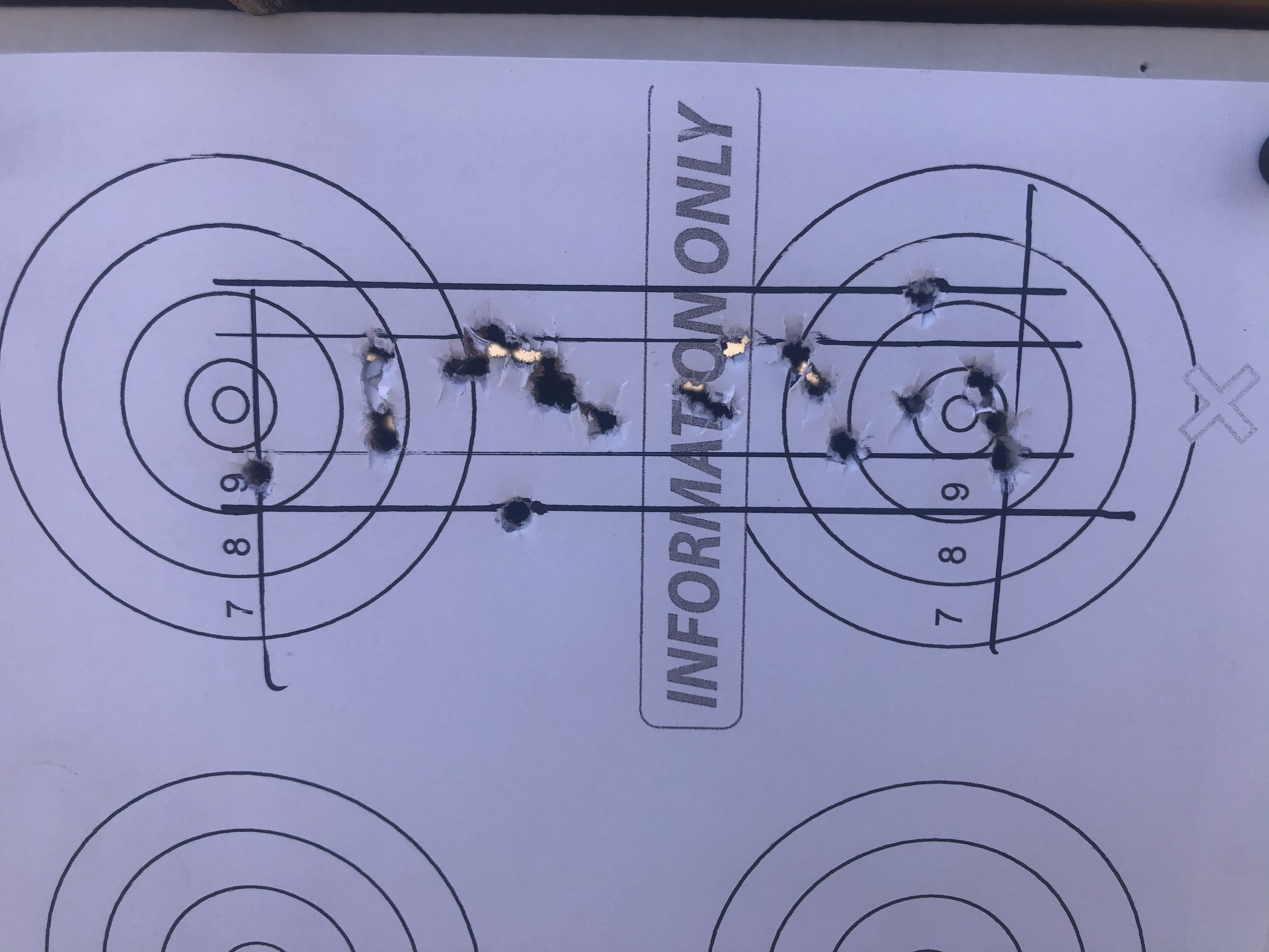

Here is an actual pair of 25 shot groups at 100y obtained in the manner I explained above in my first post. One group has 23 shots that would connect with the 10 with proper windage control and other has 16 shots. The connections take into account the plug used in 100y competition. Someone will likely nit pick the numbers, but anyway you slice it….one group has way more possible connections. This is exactly what this method of testing is intended to figure out.
Mike View attachment 335892View attachment 335893

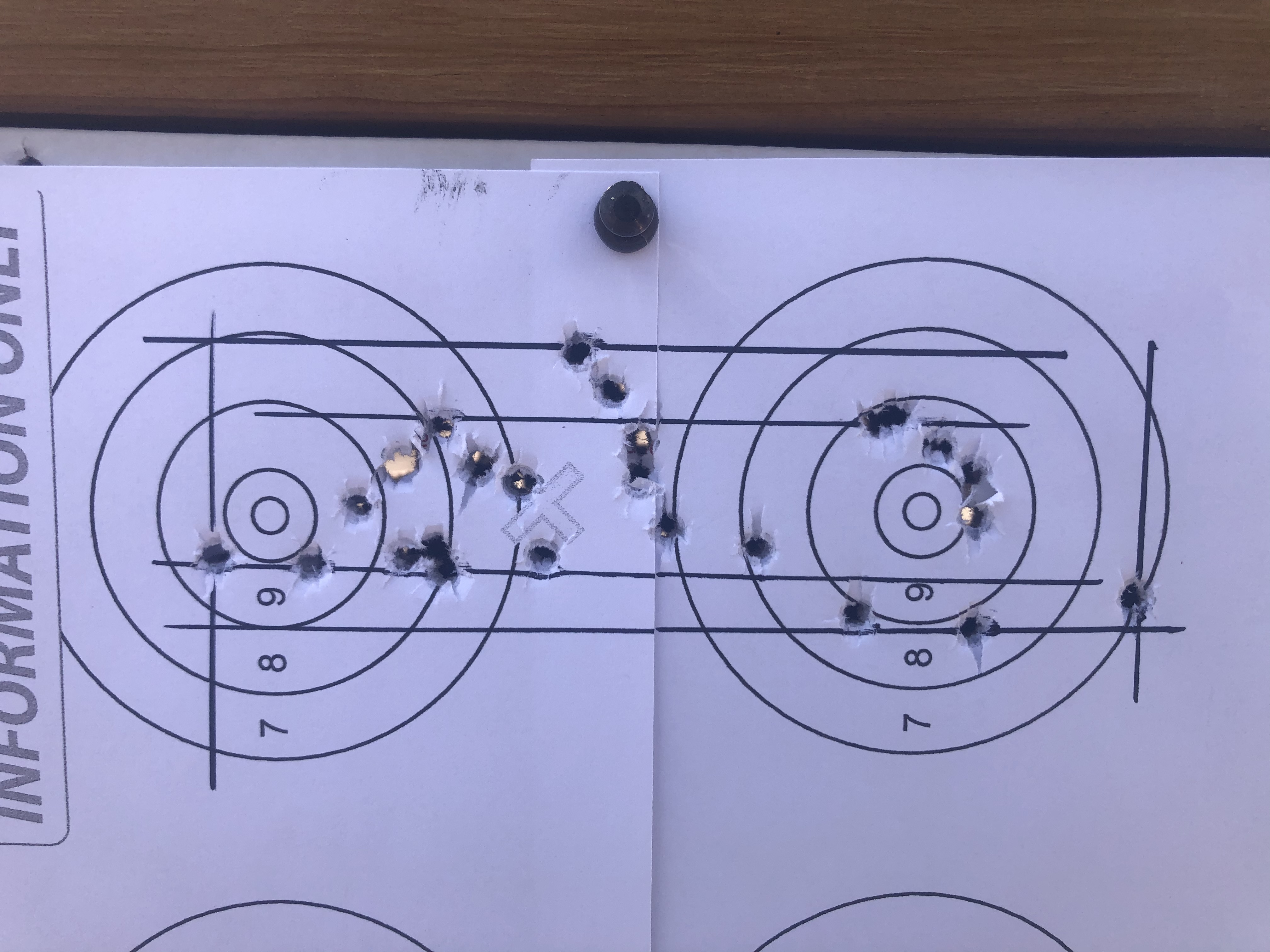

Tommy…the test works at any distance. It doesn’t need to be 100. Here is about 50 shots at 50y in up to 10 mph wind. You can see that the vertical is contained in 1/2” or less. This is a great shooting gun. The shooter will have an excellent opportunity to catch a 10 with every shot if they hold left/right correctly. I held on the right side of the 6 ring and one ring high for every shot.
Mike
Mike View attachment 351725

Well, the post is about how to tell if one gun is better than another if you don’t have an indoor range and want to remove the shooter….but if you guys want to make it about my last sentence…ok.
Here is a simple way of pretty reliably determining how guns compare to each other by taking the shooter out of the equation. Most don’t have indoor ranges, so this method will work for anyone at any distance and it’s not dependent on good conditions.
Set up two benches side by side and as close together as possible. Have two shooters point at the middle of their own bull and fire the rifles to be compared at the exact same moment for 25 shots. You can just count down from 3 or something.
To analyze the groups you are just going to draw straight left and right lines from the shots to the 10 ring. If the targets are scored with a plug, take that diameter into account. What you are trying to determine is the number of shots that have the opportunity to touch the 10 ring if the appropriate left/right hold for wind is made. A gun that has 20 opportunities to catch the 10 will almost always beat a gun that only has 10 even if the shooter with the 10 gun is better at reading wind.
Because of the way certain targets are configured….a very small reduction in 25 shot group size can net way more opportunities to catch the 10. If you asked someone if they wanted 10 tries to hit the 10 ring or 20….nobody will pick 10. However, this is exactly the scenario that unfolds at every BR match ever held.
The “It’s the Indian and not the Arrow” philosophy as it pertains to BR is incredibly naive.
Mike

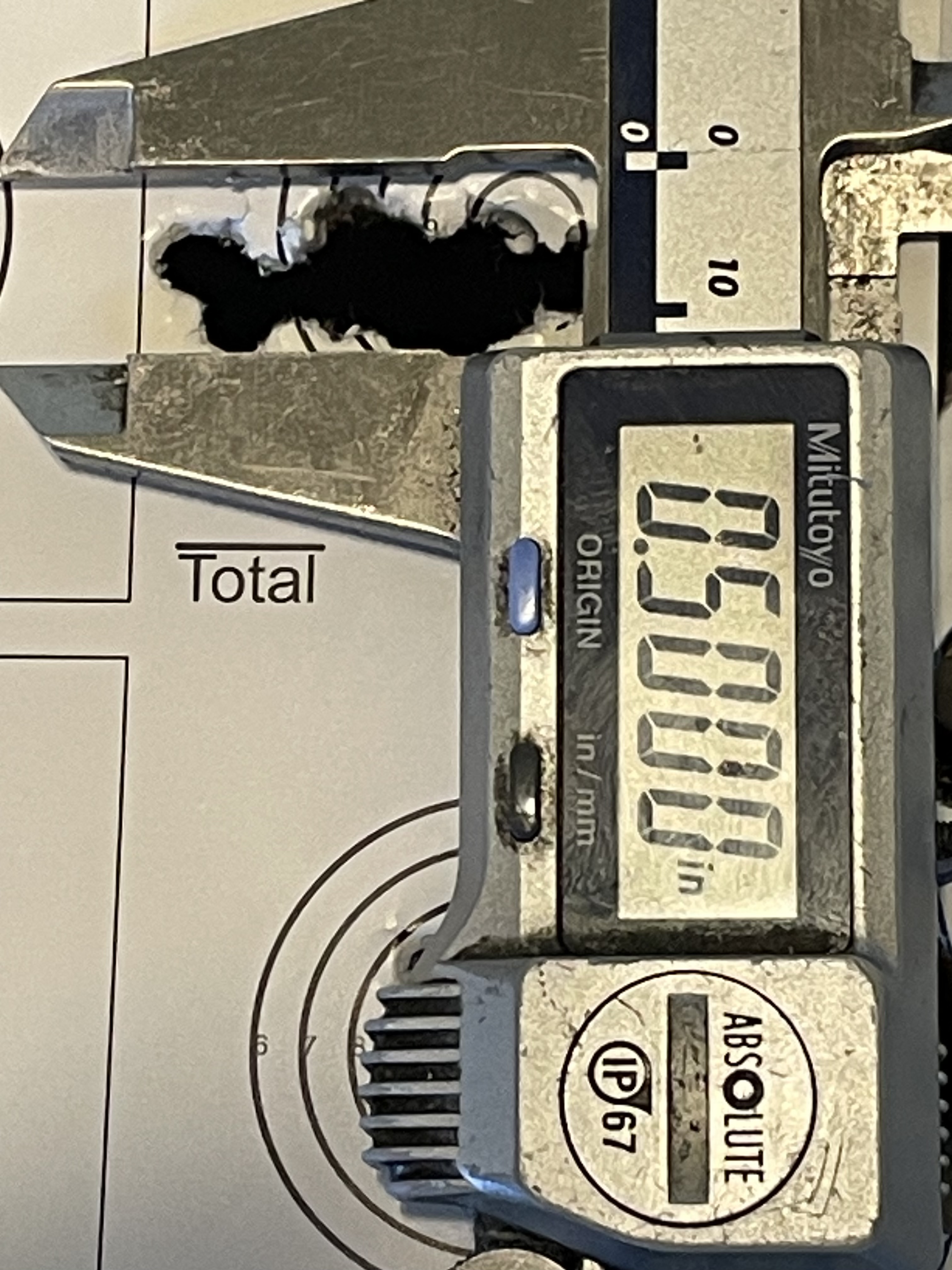

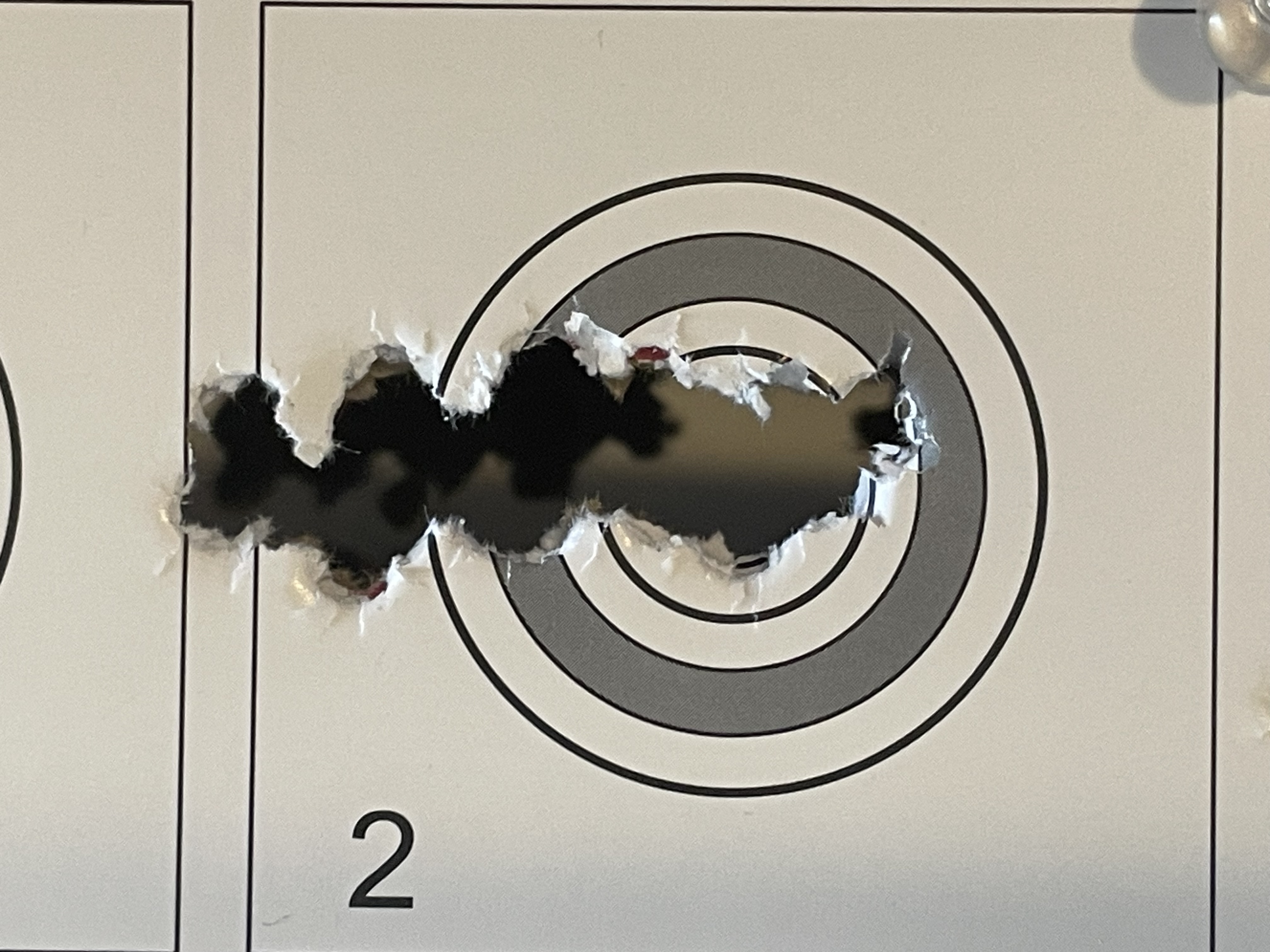

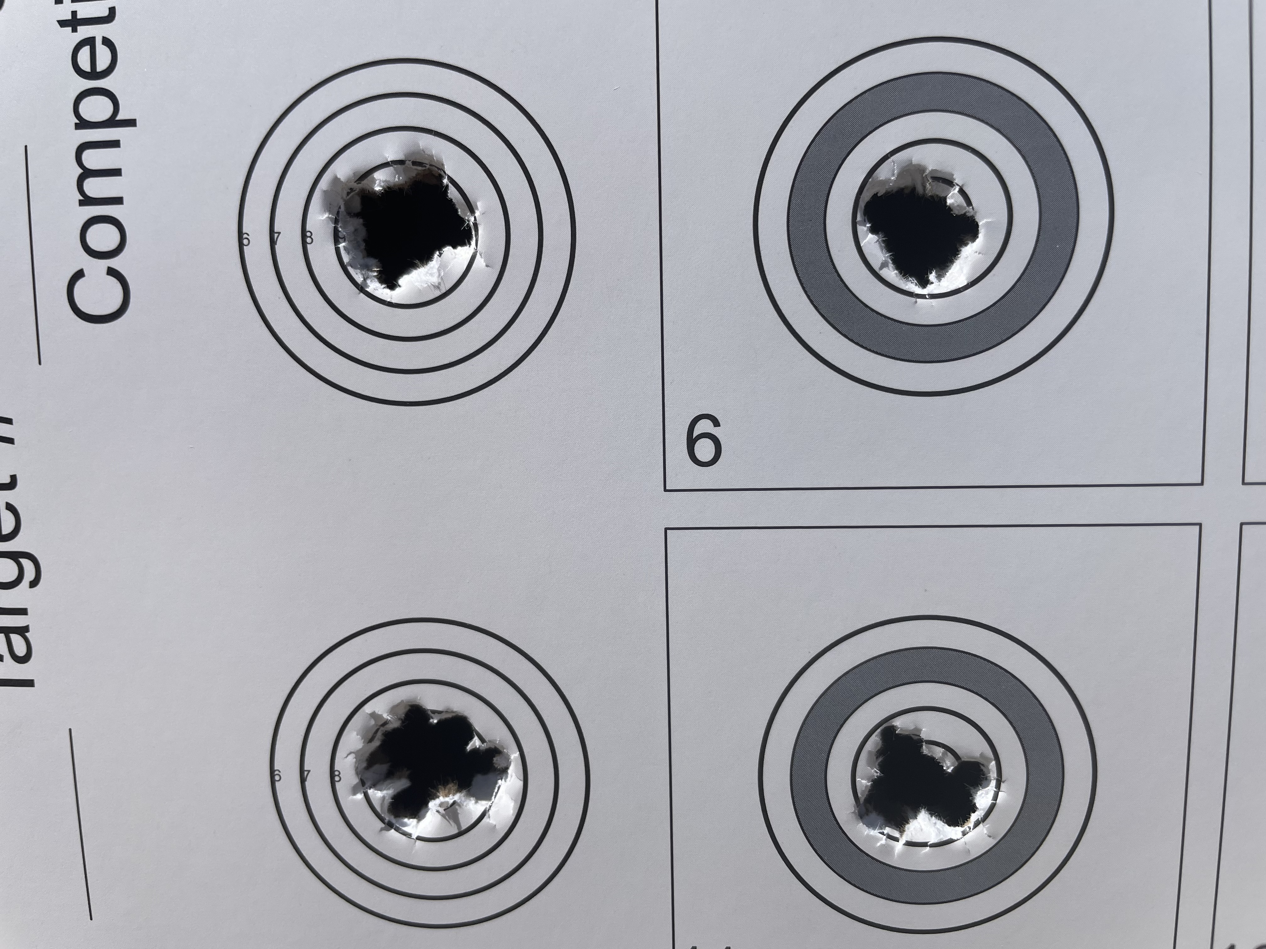

Hi Tommy. This is the 1/2” I’m talking about. 1/2” ctc is a lot bigger…nearly 1/4” bigger. A great shooting pellet gun will keep a very high number (25-75) of shots within a band 1/2 tall. To convert that to ctc… take .500”minus .220”. So ctc of .280”.
The picture is about 35 shots in heavy wind.
Mike

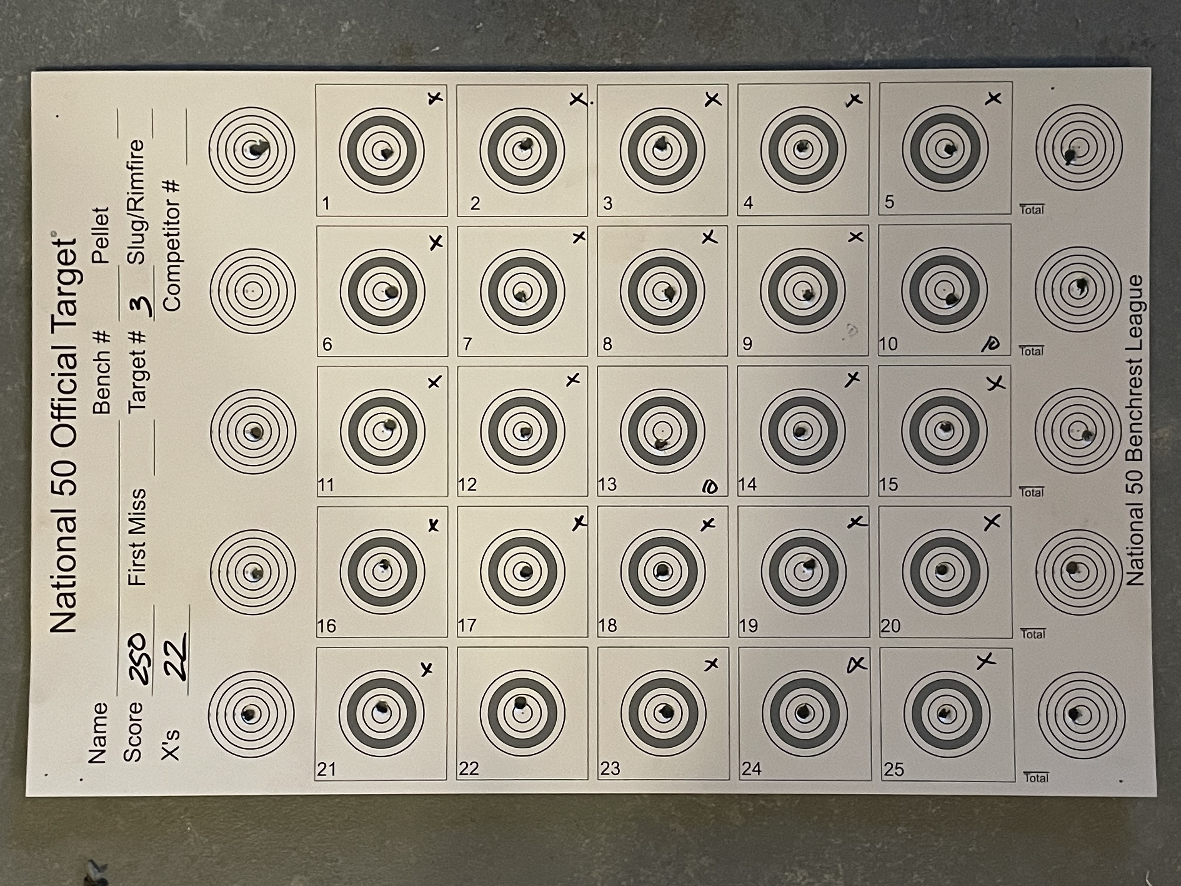

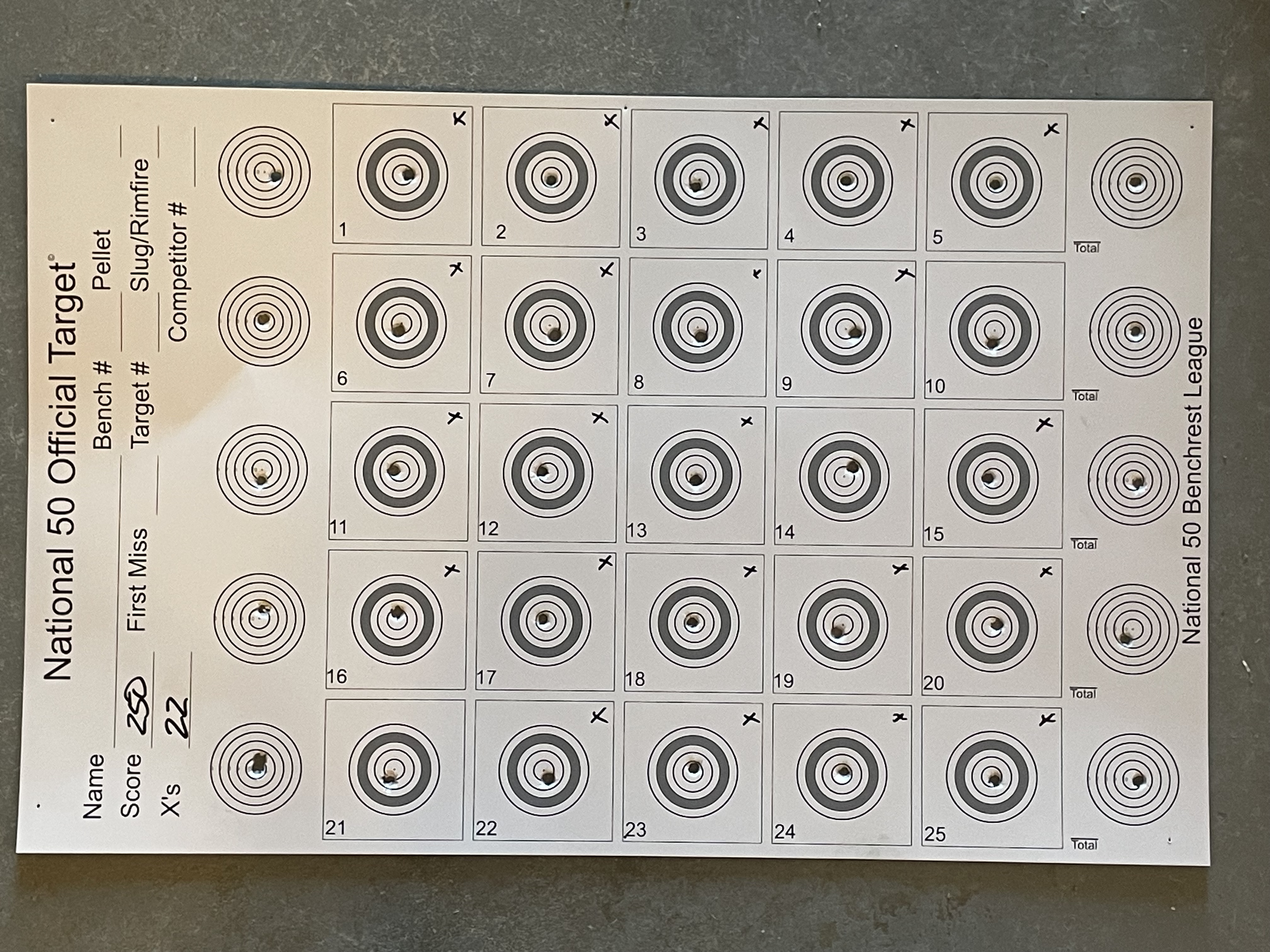

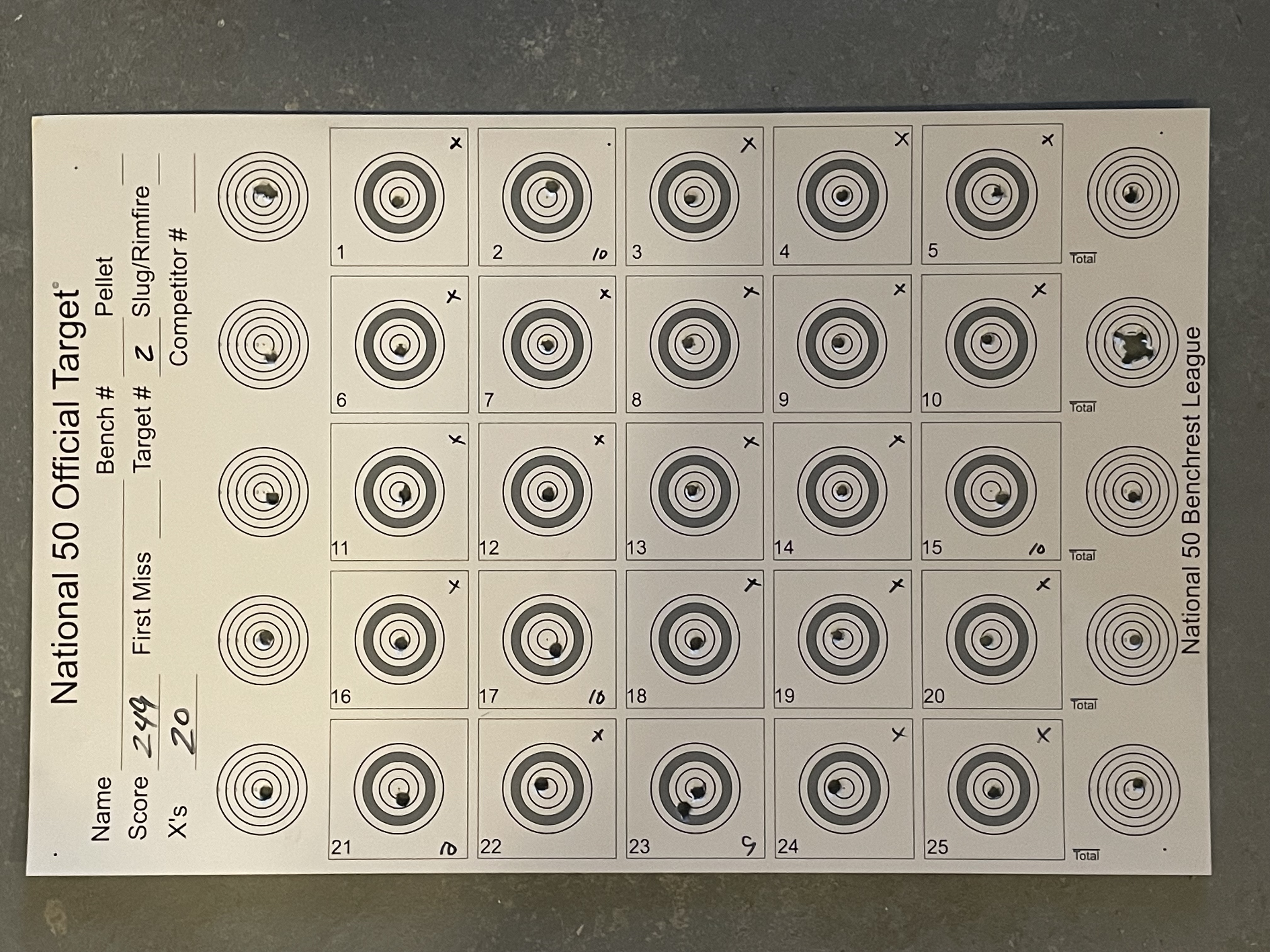

That is really an impressive set of groups and targets. There's 7 250's out of 8 ( counting the 4 groups and your sighters), no telling how many x's. So what it was in calm conditions, the combination still has to work together.( rifle and shooter). There's a lot of rimfires that can not do that let alone any of the other manufactured air rifles.
Very impressive Mike, plus the exciting thing for me is to see and read how far you and your rifles have come..
It’s definitely exciting to see that level of precision and consistency. Not to mention the shooter’s abilities. Do I see a N100 in the future?
