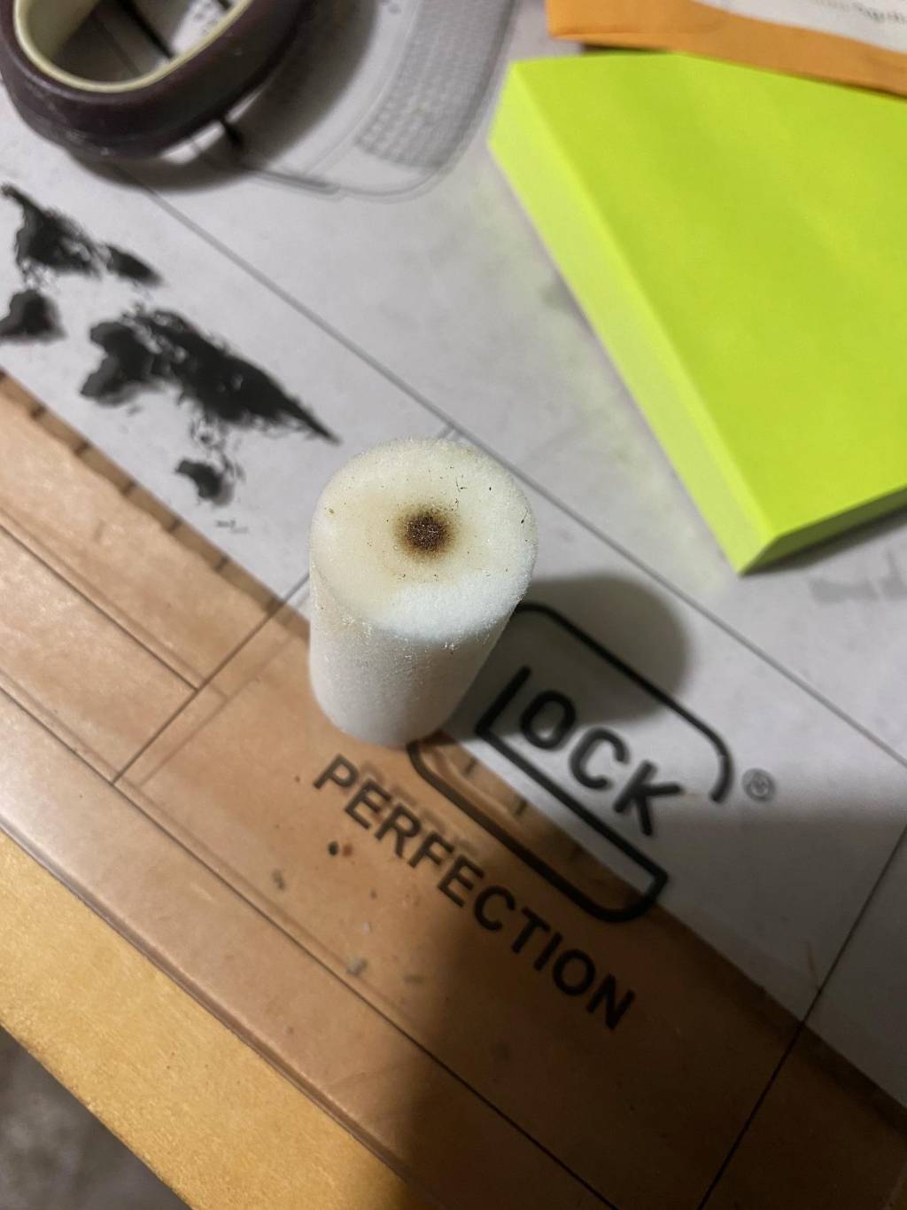

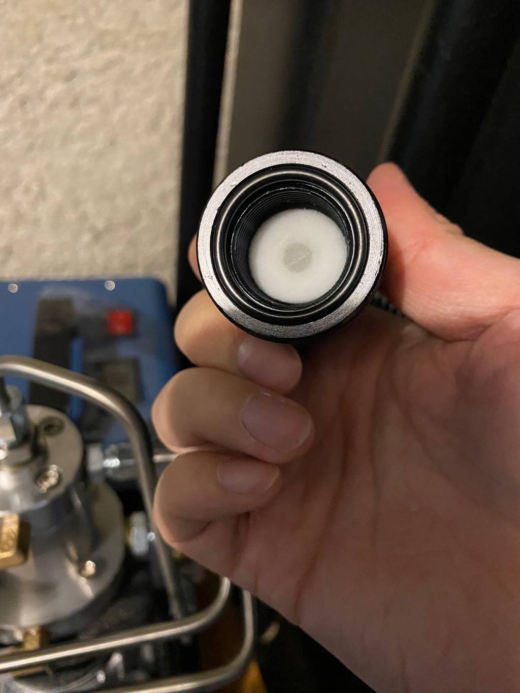

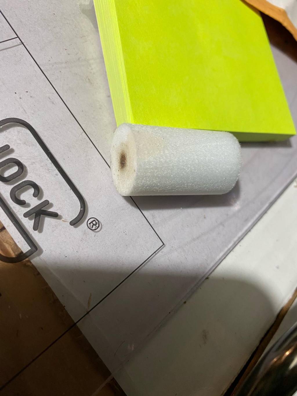

My apologies for the dumb question, but how do you guys change it/take it out when needed for drying? It seems very difficult to remove it without damaging it since it's "one way".
The picture was taken after 5 mins of use, I do have the big gold filter after it.

@siulam: Nope it will not get better but no big deal, just open the filter and pull the filter out with needle nose pliers and let everything dry till next time. I always open it and leave it open so it can dry while in storage. I also let the compressor run for 30 seconds with the bleeder valves open and a lot of moisture comes out of my low pressure side valve.

Yea I just left it open without filter in it, and I did run it a bit with valves open before shutting it off. sounds like I will replace them every once in a while, not a big deal as long as it keeps my tanks dry! Thank you for the info!
That is not bad on the filter. You can leave it in for 10-20 minutes then pull it out and let it dry and use it over a few times until it shows good sized dark oil spots on the output side of the filter.

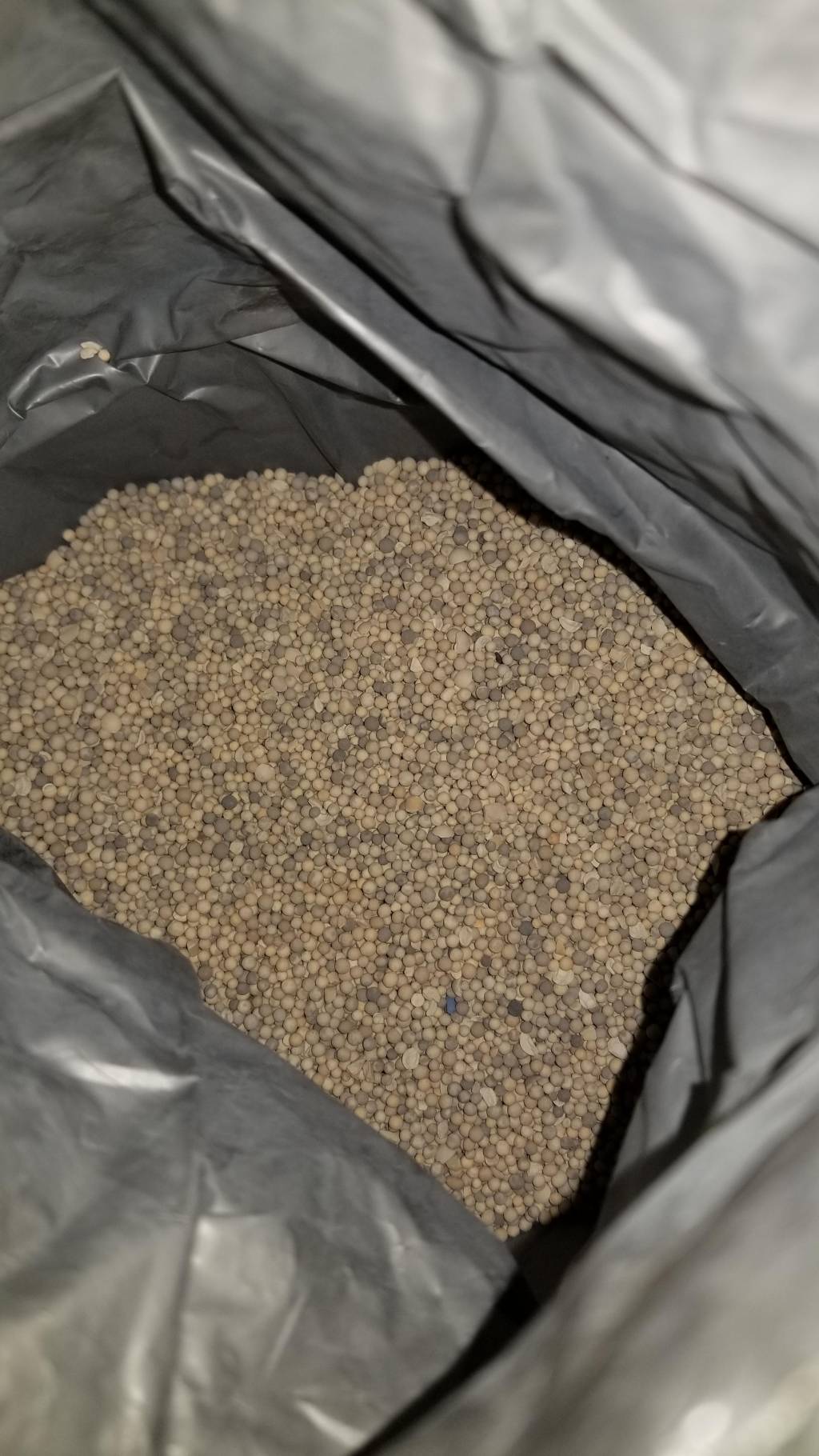

I'd fill these with desiccant, these "filters" are trash and let moisture flow through them very well.
Use slices of these filters as plugs on either end and fill the middle with desiccant. I don't even bother drying it out just toss it and refill every couple fills of my scba.

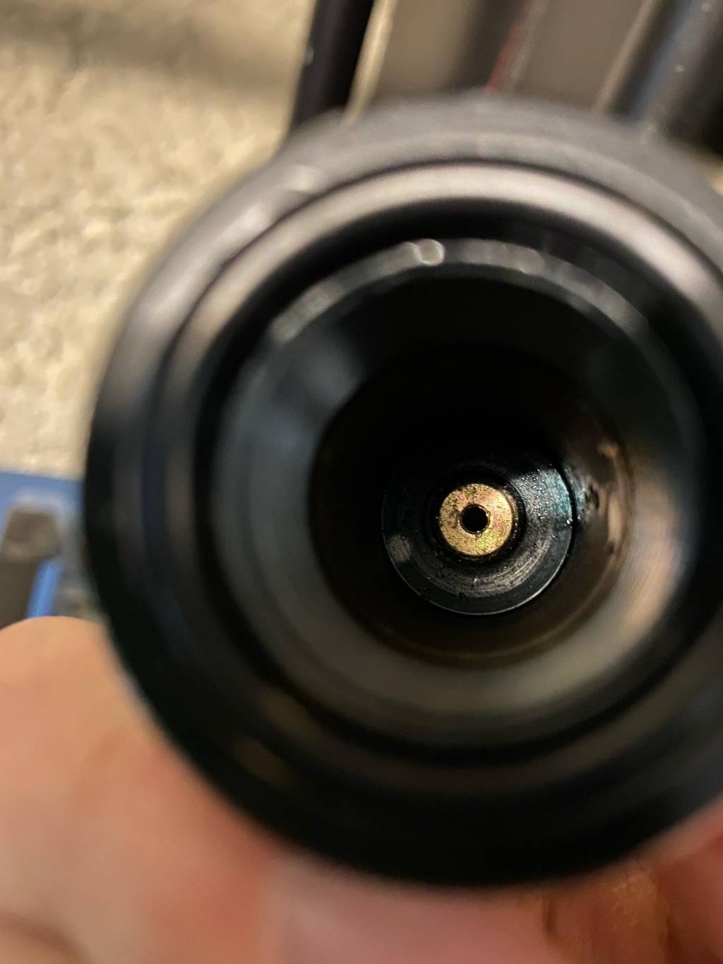

The spot on the outlet side of the filter pictured is from blow back from the in the big gold filter (charcoal dust) . When you bleed the high side of the YH the downstream pressure and volume flows back to replace the volume bled. A check valve at the outlet of the small stock filter will prevent this reverse flow and and possibility of emptying the tank being filled due to a compressor problem. Cheap insurance and improved operation of the system.
Great advice! I'm going to install the check valve soon.
