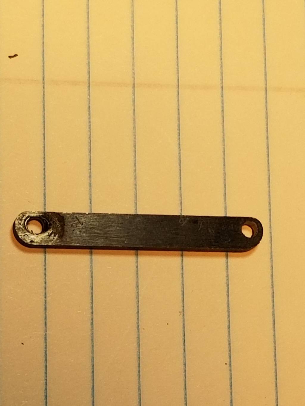

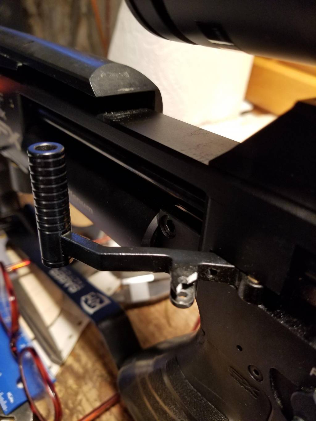

Did it one time too many about 10 days ago. Heard a loud pop and a metal part flew off the rifle. That was the sidelever linkage. The sidelever had failed at the pin hole which links it to the linkage.
Found the linkage and disassemble the rifle. The rear hole of the linkage had become elongated and deformed, but again nothing else was bent, deformed, or peened. Ordered up a new lever, linkage, and related pins. They arrived yesterday. New lever does not have the bronze bushing in its rear hole but it fits its pin fine. Rear hole of linkage fits its pin fine. FRONT hole of linkage is much too small for its pin; pin is about 0.10". Original linkage had holes of identical size, not two different sizes. Carefully drilled out the hole to fit, reassembled and tested, and rifle is back in action and shooting as well as before.
But enlarging the front hole in the linkage does not leave a lot of metal, and I bet it will wear prematurely even though I've learned my lesson about closing the breech. Have the specs of the cocking lever and linkage changed? I thought I read that the pins in the reloading block had been beefed up because of people like me. Maybe the replacement linkage was old-style?
For a while before the failure I was having accuracy problems and shifting zero (though I think the latter is scope-related), and I was feeling a slap from the cocking lever when firing. Probably because lockup was not complete because of the elongated hole. Now there is no slap, and accuracy seems back to normal though it's too windy to be sure. I let FX USA know, and asked about different versions of the linkage.

Hobbyist, I'd love to make my own part, but do not have the equipment right now. Could ask a machinist, I guess. Meanwhile I've learned a couple of new things:
1. Some Crown parts have the same number as their Impact counterparts. My replacement cocking lever lacked the brass or bronze bushing for the pin which attaches it to the rear block. You can just see that bushing in the pic of the broken lever in place on the rifle. Also, it wouldn't quite fit the slot in the original handle, and requires a little work with a fine stone. Turns out it is a Crown lever, which has the same number as the Impact part, that's why. Works fine, though.
2. The replacement linkage has holes of two different sizes, with the front hole which engages the pin on the loading block being smaller than the original. I enlarged it carefully, and installed, and it works fine. Turns out there is a variation, and the drawing shows part 19021 while the original part on my rifle is 19021-1.
The folks at FX-USA were very patient in helping me figure this out, and a second set of parts is on the way. Meanwhile, shooting with the "wrong" parts, I've shot several sub-MOA 5 shot groups at 100 yd in the last 2 days.
