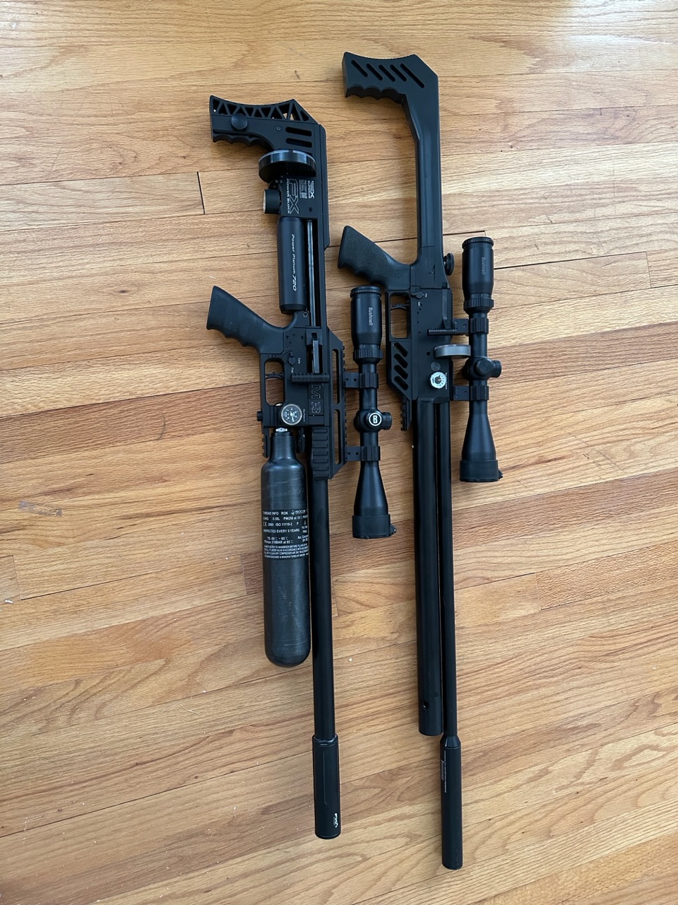

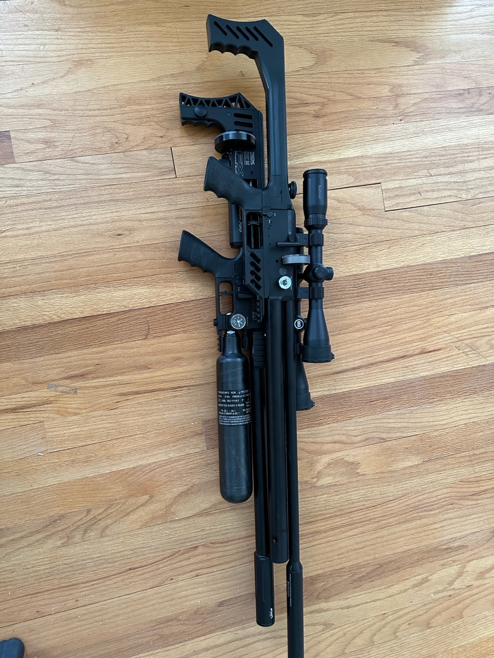

480 is plenty. Do you have the compact barrel or something longer? May run into issues with moderator clearance on the short barrels and the 580 bottle. Mine have 220cc bottles and I can get 4-5 mags before droping below the reg. Shooting 177 and 22 at about 750 fps with the short barrels.
