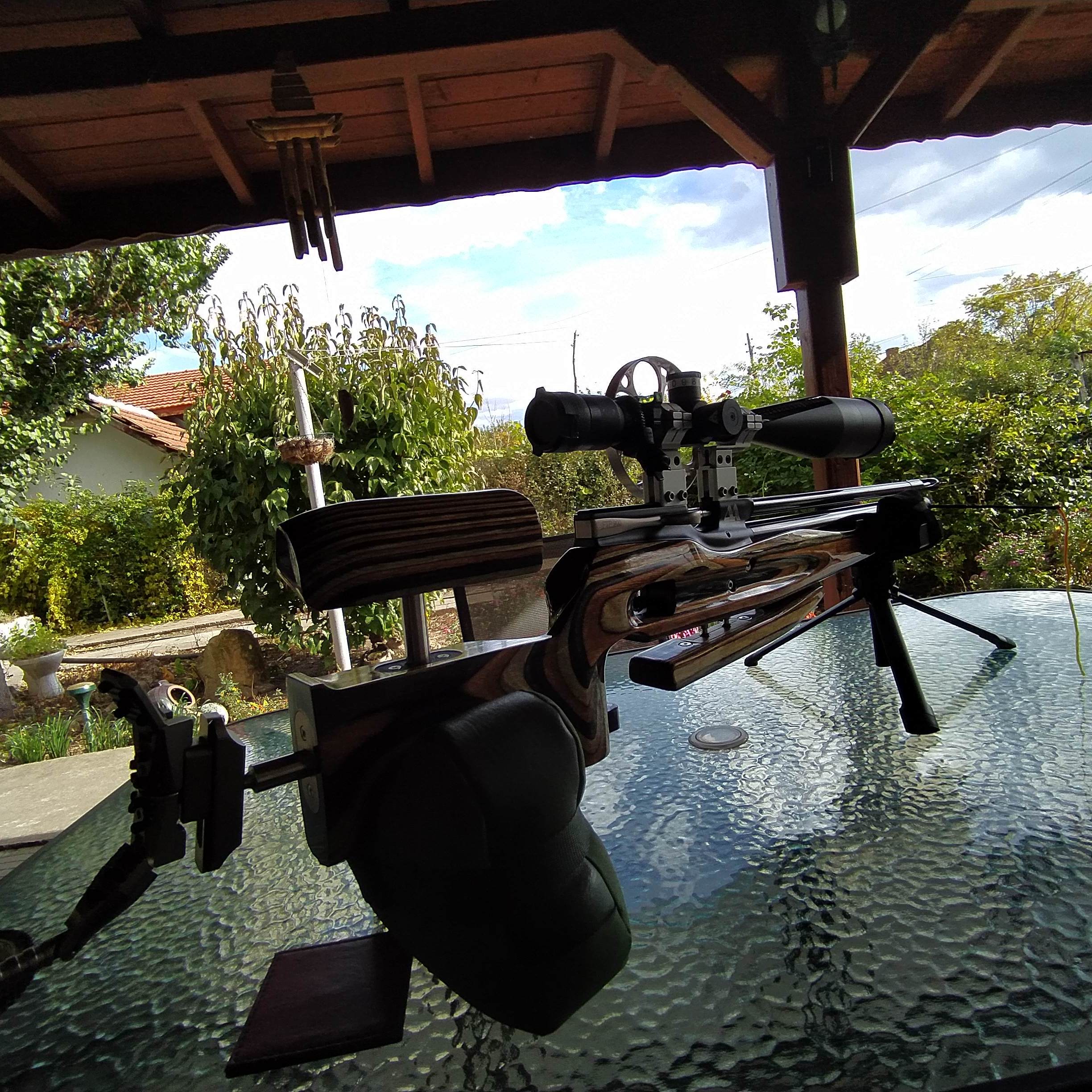

We all have our own methods or ways to continue shooting FT.
I have had a few years out, busted legs.
Motivated by this thread and the OP I'm going to continue, most shots this winter will done standing.
Kit set up today, now just need to test my legs and build muscle memory.
FT life 😂.
