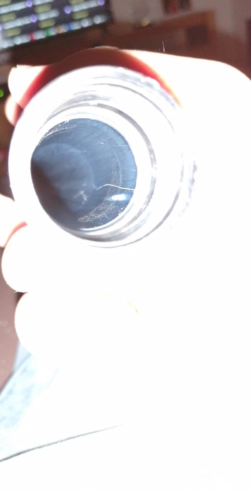

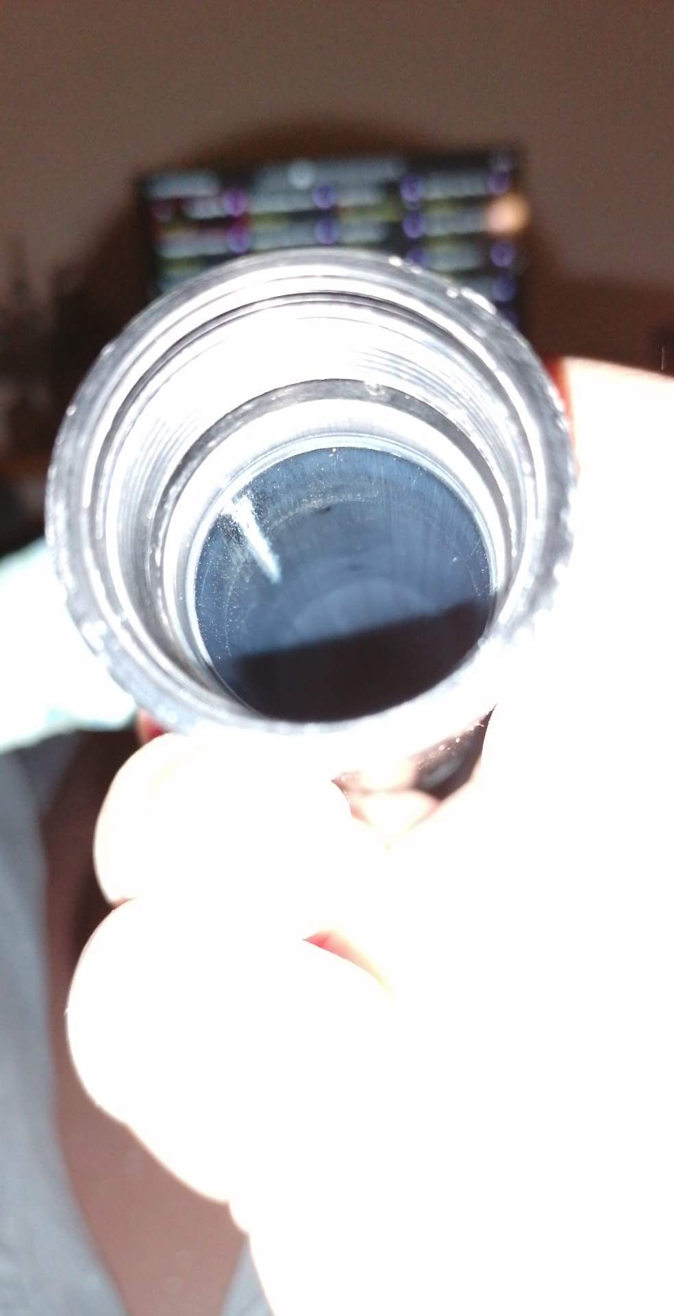

Hi, I opened my today and it is like the pictures show. Is it unsafe? Some corrosion, i think. Nothing touches the areas where the white lines are. Doesn't come off with a rag or kitchen paper towell.
#UPDATE
I can't feel any depth on the "corrosion" spots, with my fingers, scratched it lightly, with a screw driver and could feel a very very, light roughness.
Ok so the scratch visible next to the "corroded" spot, in the second photo,was made by "dumb" me, when i passed a drag to clean it, can be felt with the point of a screw driver. It doesn't go from one end to the other, but it's without a doubt noticeable, the point of the screw driver "stays" in it.
On the other end i have some rust spots, from a bad quality regulator air chamber.
Do you think it's best to dump this bottle?

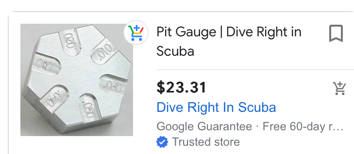

When I was in the scuba business I used to inspect scuba and scba tanks. For pits and corrosion we used a pointed probe and a disk that had spots on it of varying depths that you used your skill and training to determine how deep the corrosion might be. Your tanks corrosion might best be examined by a trained inspector at a dive shop or fire extinguisher testing company to determine depth and hopefully know what depth would result in condemning your tank.
Thanks, i will contact the local scuba diving shop, then.
Best regards!
