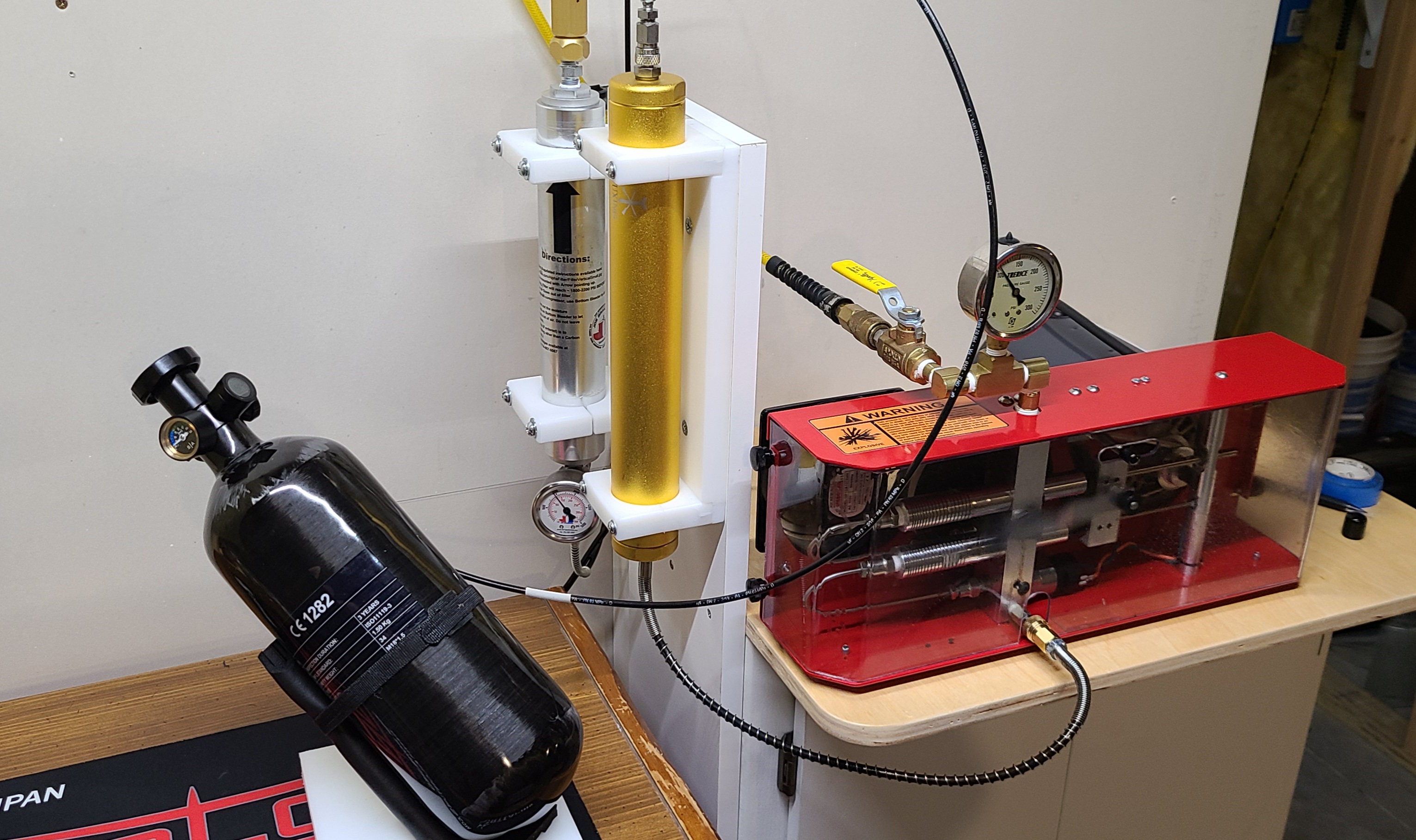

At the least you need to have one of these on your compressor, I use two filters like this. One is slightly smaller
Filter elements should be disassembled and dried out several times a year or more depending on use. Or just buy new inserts or new media.
