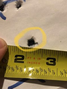

I pull the patchworm with double gloves it super tight in the barrel with the little thin cloth I run before the patch its self I like the groups an they fall off around 700 shots I notice it just groups like dime/nickle size at 20 yards but I want it back to .44 of an inch or same hole so I clean it like with 20 patches usually an accuracy comes back this is for my avenger bullpup .22.

Well il tell you one thing if you clean em HARD like I do they should preform, I run patches an have to use 2 gloves a wrap it around my hand a pull it thats how tight I run my patches, Gets my hand sore sometimes after cleaning but its worth it guns is a lazer with 1 cent pellets even out to 50 yards nikle size group are easy work I acutally enjoy shooting farther a lotta the time with crossmans I push em out to 100 at about a 2.5-3 inch group, I make sure there is little to no discoloring on the patch when I finish.
