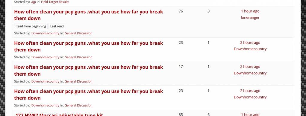

How often do you post about cleaning pcp guns and about how far they are broken down?
