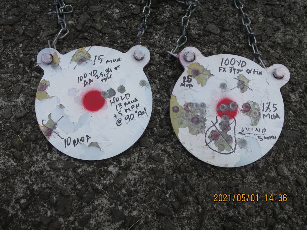

At 100 yards last weekend used a Leupold VX-Freedom Rimfire 3-9x40, maxed to 9x, in some stupidly LOW rings. Struggle to get a good sight through the glass. New scope was still in transit.
Two big blobs are holds to keep the 1" red circle intact. Stuck a couple in center and then called it a day. Just a plinking day, try out the new rifle.
