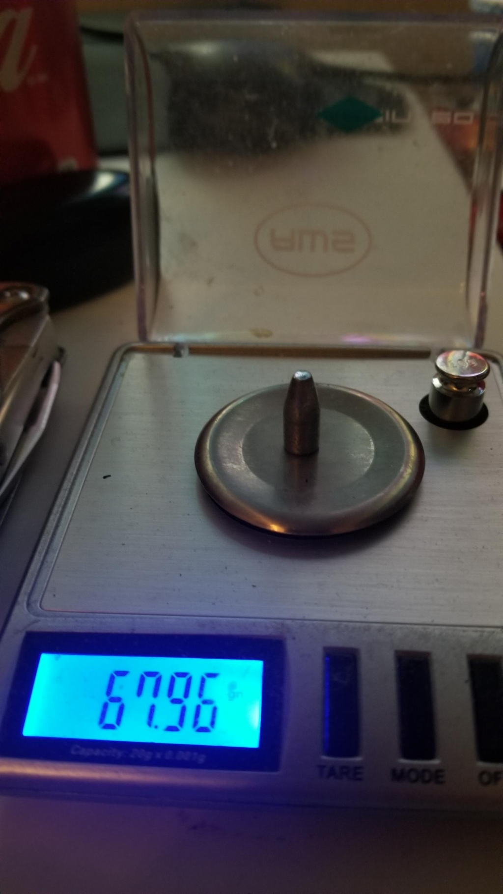

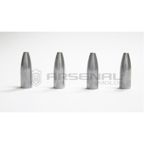

here is a pic of mold I got but It is slightly modified from the oem design for my barrel
it is an elvis SLUG
it is an elvis SLUG

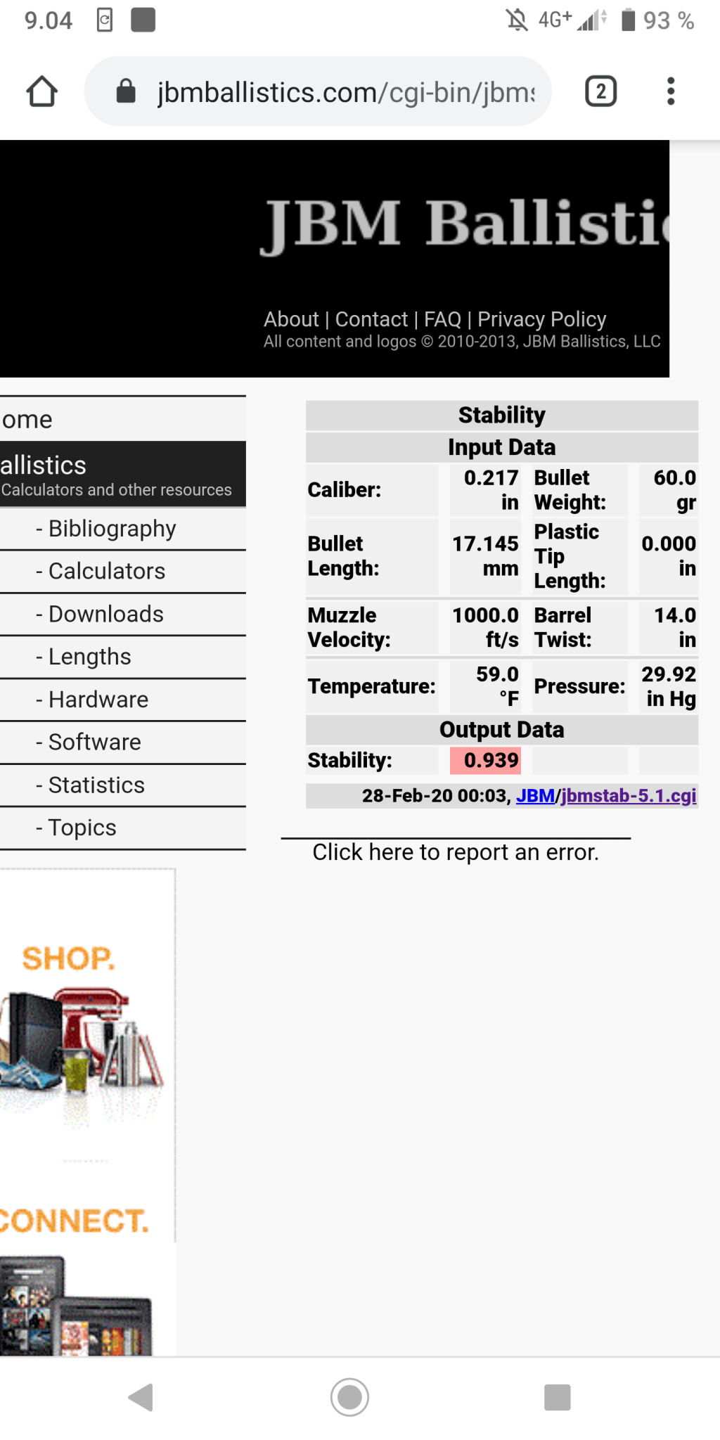

If thats Arsenal molds bullet you use its 60grainish what it drops and its not even close to be stable in 1:14
That is firearm stability calculator and Im fairly sure there is an error with subsonic velocities. Sub mach1 requires alot faster twist than mach 2+ flight speeds these calculators are made for so its even more unstable than that number presents.
According to that you would need atleast 1:11 and to be safe 1:10.
I dont get where you have this idea you cant use faster twist. Lead bullets take it well thing where you start to need copper jacket is supersonic speeds not really that much related to twist. Andre from Altaros just shot new world record with air rifle and he used 60gr bt bullet with 1:9twist and that 4500psi custom gun in here uses super fast twist too.
Now to second subject how did you manage to get your 257 intended AF valve work with 217barrel? I know for a fact that 257 texan valve tankdumps if you try to fit such an barrel for it.
Anyhow some impressive numbers no doubt about that I just dont see how you managed to alter laws of physics.

I think you need to look what you typed in to the JBM program for inputs , however this is not a good program for this .
but if you must use it at least re look at your inputs before saying how I defied the laws of Physics look at what you put in on your inputs .
rule 1 garbage in = garbage out
