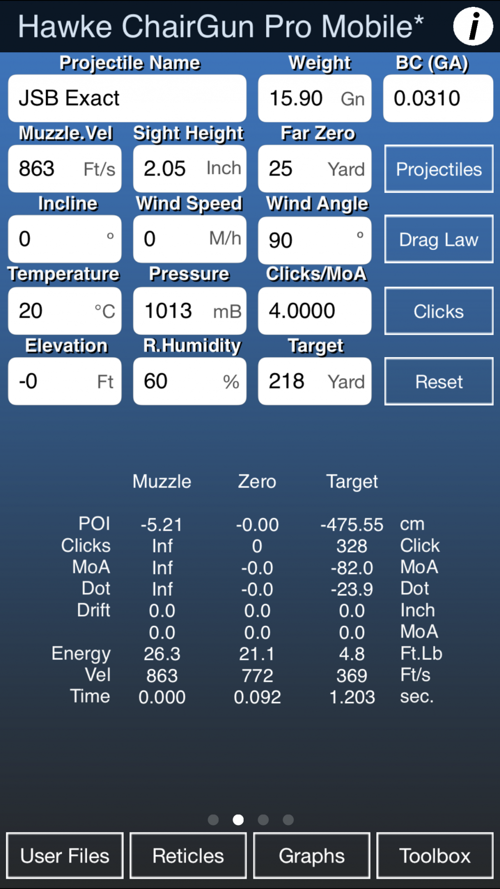

I've answered this guy similarly on the youtube comments section and it's pretty much futile. Nevertheless I don't know when to shut up so...
Using the same chairgun app he used to start this argument, a 16gr jsb with proven (many times by many people, over a chronograph- including on Hard Air Mag's tested and published bc database) average GA bc of 0.310 at sea level shot at 863fps would have a retained energy of 4.8fpe at 218 yards. Apparently, nearly as much as Bob's bloody great 40 grain slug, eh?
Consider then that a 30gr Piledriver with a tested bc (again on HAM) of 0.83 would have a 218 yard residual fpe of 25.6fpe if GA profile is used and 25.1fpe if G1 is used on Chairgun.
So of course it's impossible to even dream a projectile launched at the same muzzle velocity, weighing 33% more and significantly more aerodynamically efficient in profile could possibly retain close to 40fpe at the same distance? Really?
Seriously this guy is a troll or ignorant to the point where it's incurable. Pay no attention.
