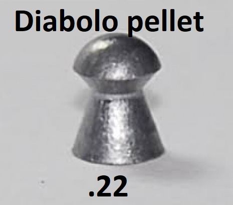

I think some people do not understand ballistics or judge by their own skills or trying to compare pellets to slugs you cant , pellets designed to fll on their face for saftey reasons , but you can still be deadly accurate close range where as a slug can fly flatter and retain energy .

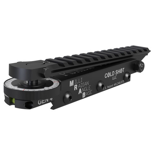

here is some long range gear for ULR just so you know it can be done ,
this is called cold shot has 144 mils holdover or they have a moa version for 300moa
this is a taco mount like a periscope designed by a navy seal , he has confirmed hits out to 500yd , it is a unique unit goes on back of scope , and has ability to adjust 800 MOA ,
and then their is good scope bases for long range which are made for specific purpose to hit where u want to hit ,

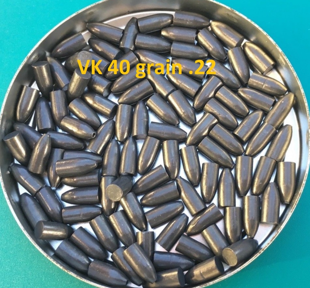

Dale listed it above. He makes the slugs, I'm pretty sure he knows what's up.
Stoti
When I checked the varmint knockers 40 grains he has posted .117 for a Bc
The BC that I posted was from my Wolverine 303 that I converted to a 22 calliber
it shoots the 40 grain at 935 fps at the muzzle the gun has a 1:18 twist and gave a
.117 BC number , now Bob's gun has a 1:16 twist rate and will give a better BC number .
