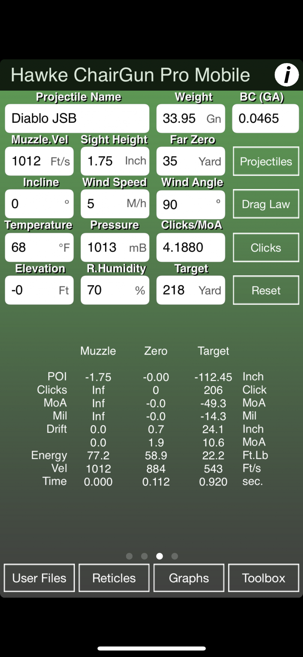

Something is not right yes I am getting 9 fpe more but with 1/2 the Bc and 6 grains less I am still producing more at the target somethings not adding up.

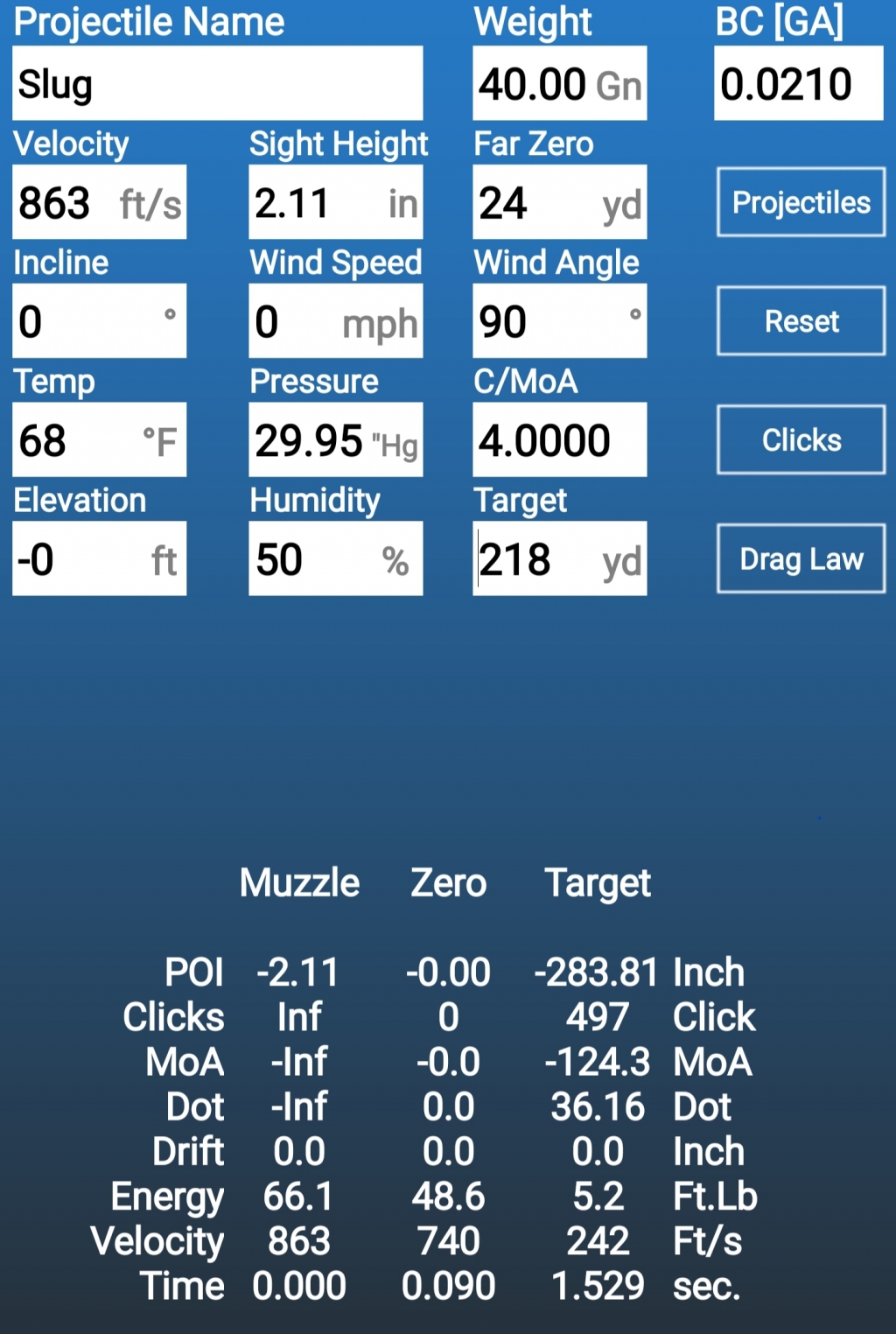

A 40g Slug would need to be tralling.at around 670 fps @ 218 yds with the BC figures quoted 😏
Stating a BC of 117 to me is just a marketing selling point, if a slug could retain so much energy, at such long distances,they would be banned from general sale here in the UK.

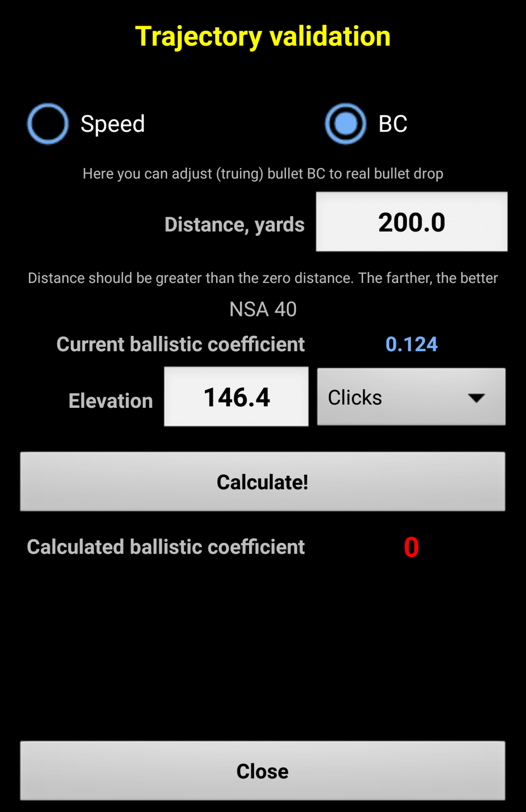

There's a trajectory validation feature in Strelok Pro, which allows a person to find their true velocity or BC.
Being I shot over the Chronograph, I knew my velocity was true. When I set up the profile, I started with a BC of .09. Upon telling Strelok the actual amount of elevation I used for a 200yd shot, it calculated a new BC of .124.

To your last question, Yes.....that's what Strelok calculates and it's spot on. Not just for this slug but for all the VK slugs I've shot from my Crown and Impact.

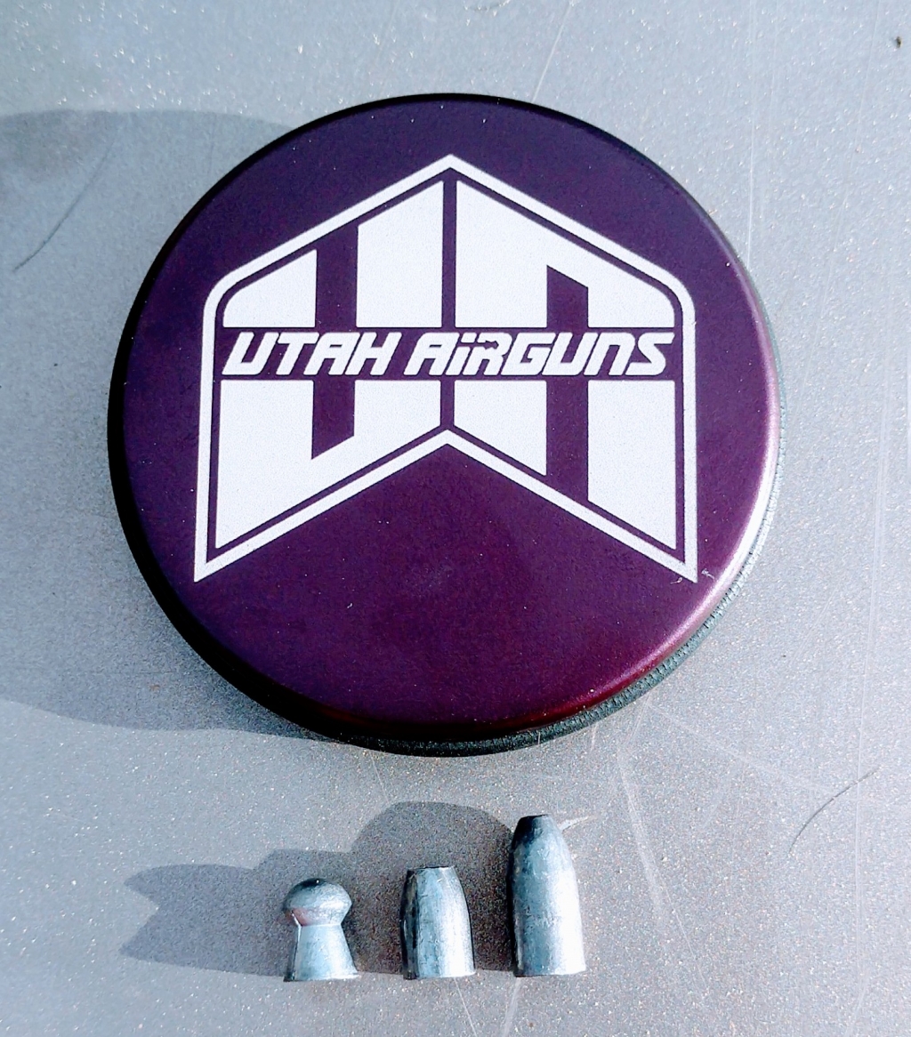

I think some people do not understand ballistics or judge by their own skills or trying to compare pellets to slugs you cant , pellets designed to fll on their face for saftey reasons , but you can still be deadly accurate close range where as a slug can fly flatter and retain energy .
