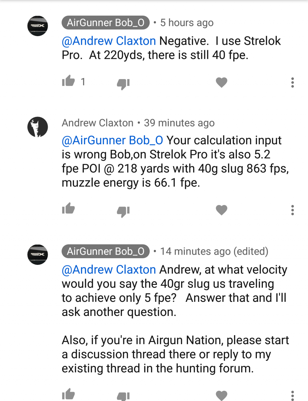

Your'e wrong. Here's .22 LR Ballistic Chart. Look at energy left at 200 yards....in this case it would be above 40 ft lbs, not 10-15.

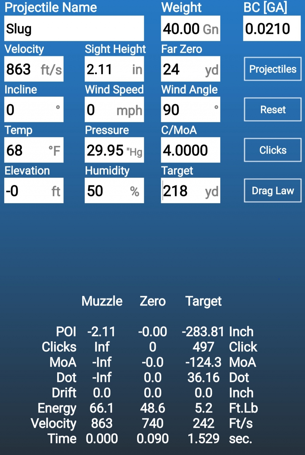

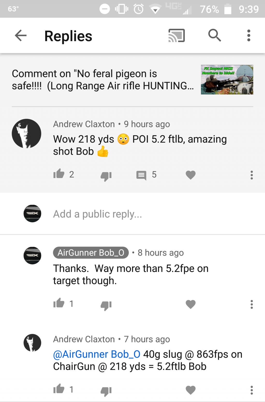

The 10-15 ft lb figure I gave was NOT based on a starting velocity of 1250fps. It's based on Bob's muzzle velocity of 863 fps. That being the case, there is no way it would be above 40 ft lbs at 200 yards. Let alone 218 yards. I wasn't saying the .22 LR only had 10-15 ft lbs at 200 yards ! The fact that I said the 22LR is still moving at 500 fps at 400 yards clearly shows my 10-15 figure was not about the .22 LR High Velocity.

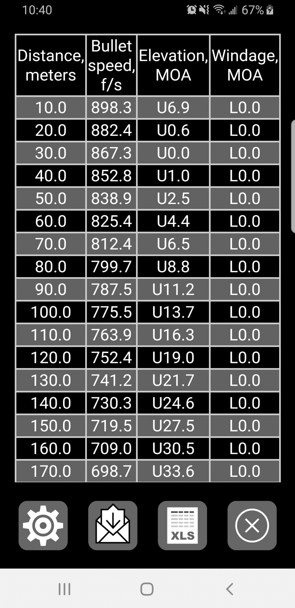

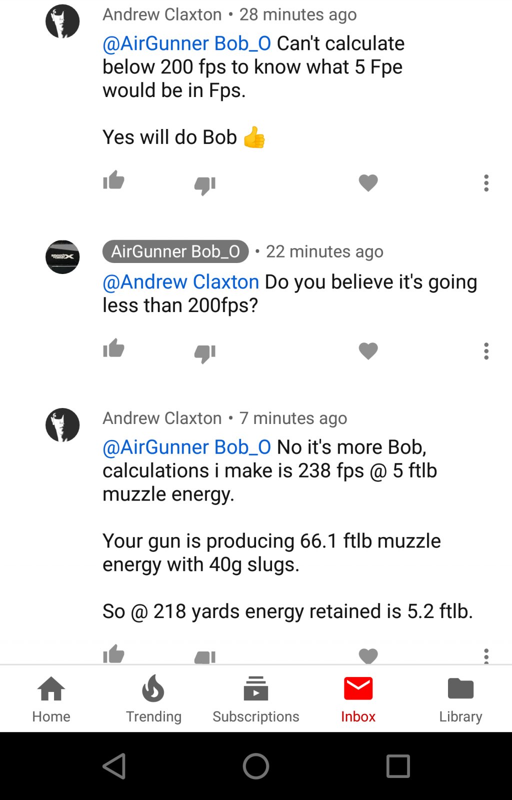

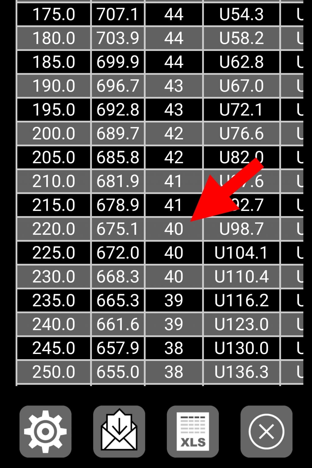

Looking at the ballistic chart link you gave the 22 LR has apx. 70% velocity retention at 200 yards. Based on that ( and assuming similarity in ballistic coefficient between Bob's slug and the 40 gr LR solid bullet) could we assume Bob's slug would be right around 600 fps at 200 yards ? So at 218 yards maybe around 550 fps ? Or 26.9 ft lbs. Just a guess based on ratio of loss.

Watched the video and all I can say is good job ! Well done ! I got a little nervous when you went for that bottom target. My luck, I would be looking at buying a new chronograph after a bullseye to the display screen. Your numbers are within 15 fps of the ballistic table. Amazing ! Thanks for taking the time to do it for us naysayers. LOL !
