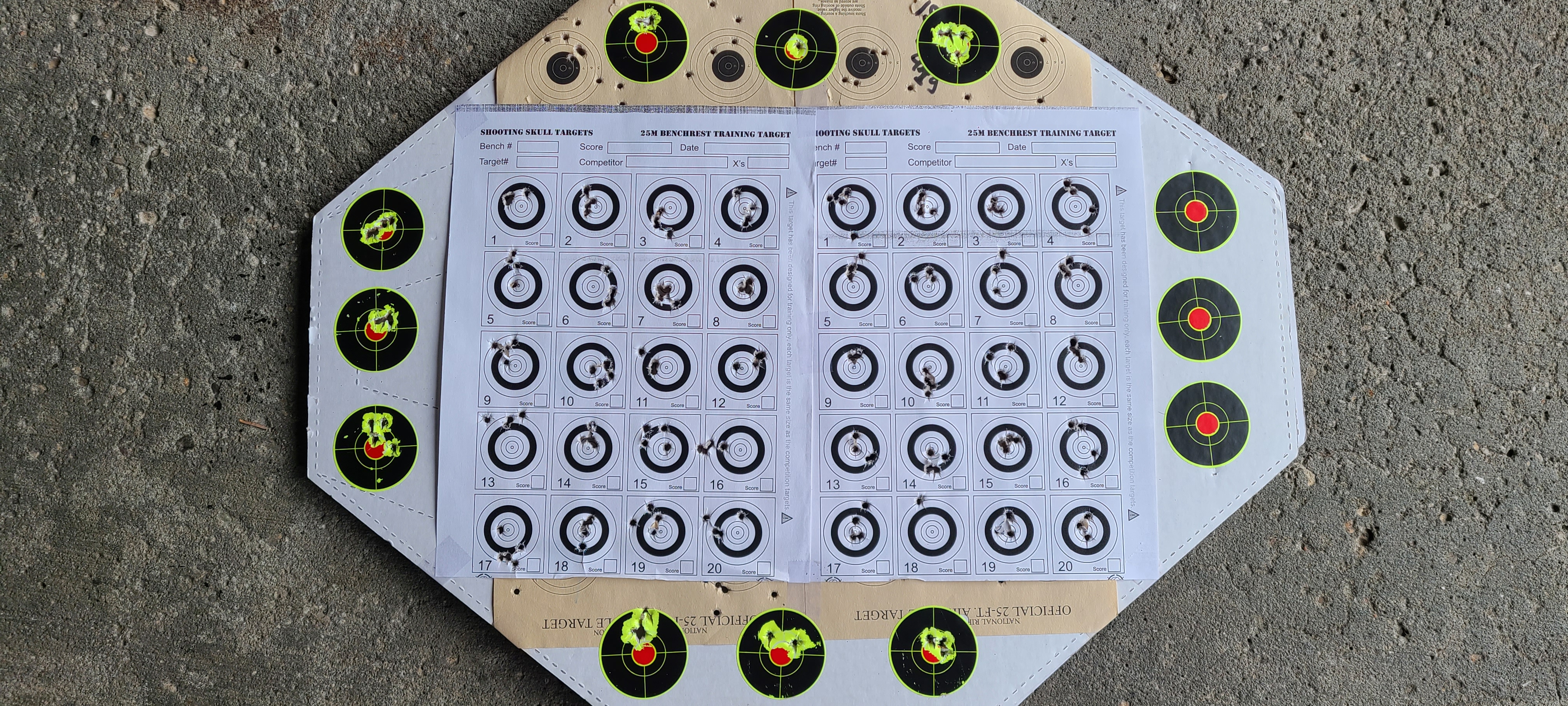

I can make a decision only reading the 5x20 shots - with my .25x700 Impact or 8x20 with my .22x600 Leshiy2
My typical go-nogo card, in this example I was testing resized MRD's from a Leshiy2 .22x600 barrel 4x20x2 shots @50 meters.
And, the barrel surprised me not fulling that day, I guess about 200 shots here on the paper.
